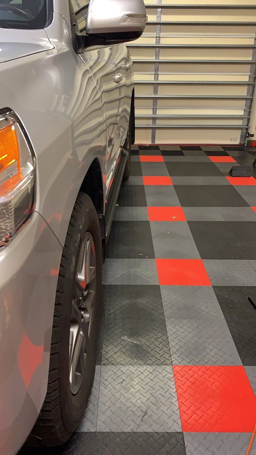

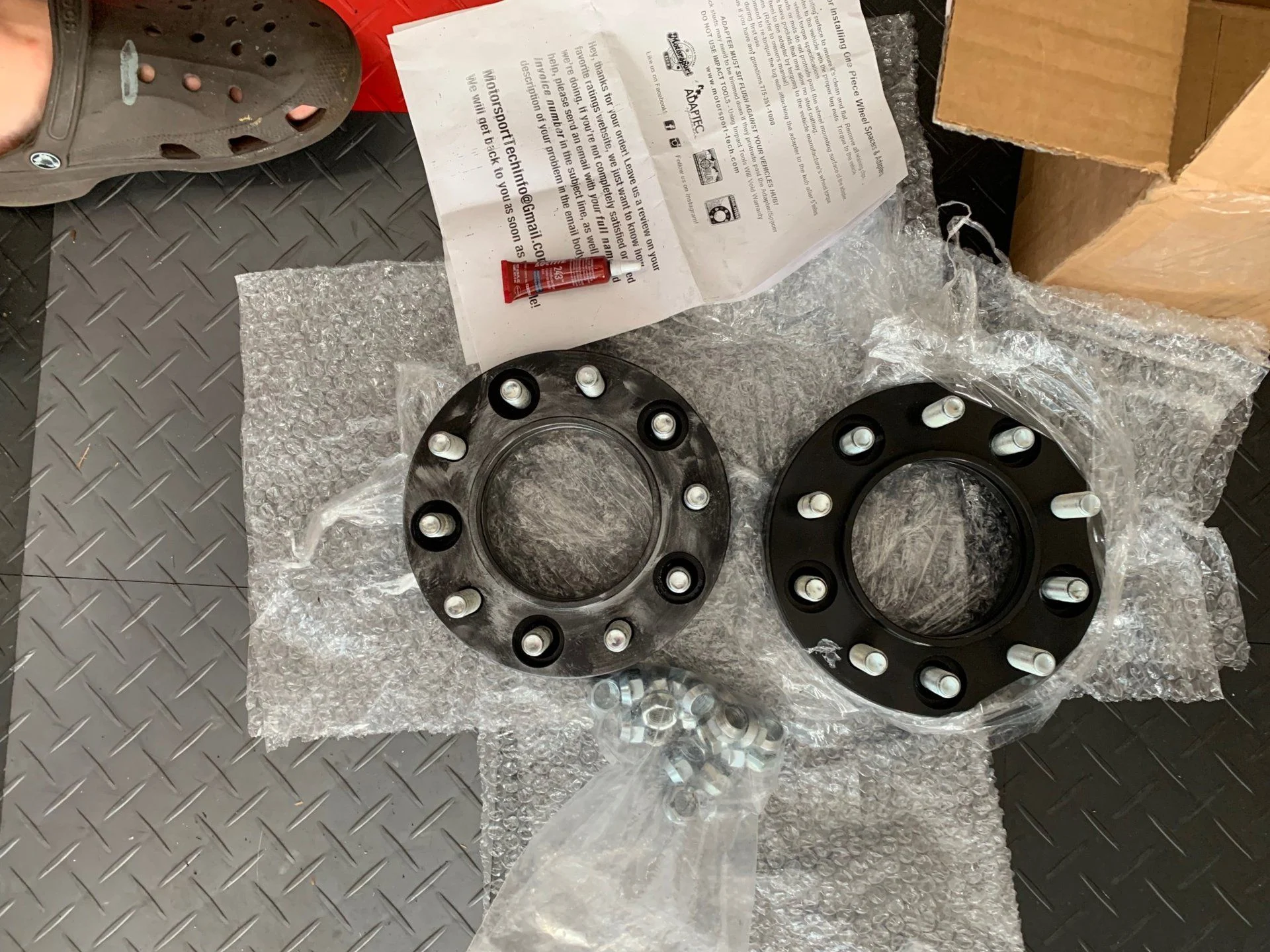

If anyone is interest have a set of Bora .75" spacers. It makes wheels flash with fenders. The tire thread is more to inside so no worries about rock chips. Installed on front wheels and took it off the next day. Got small injury trimming studs and decided to go back before going through the exercise on the back. Attaching couple pictures. Will include locktide 243. Grey stuff is just dirt from anti-seize.

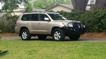

Hey guys. I am new to this forum. I am currently struggling to get wheel spacers for a Land Cruiser 200 series. I just installed an ironman front bumper with a winch and also a stage 2 lift kit. I also bought 305/60/R18. My tires are very close to hitting the lift kit ring (I don't know what you call it. Im talking about the distance between the front tire and the silver ring on top). Could someone please guide me what to do? I am also having trouble with the installation of two batteries that operate my winch, bumper lights etc. Any help would be suffice. Thank you
I think that 305 are too big. The biggest i could go was 285 65 18.
I had no rubbing until i put on my method wheels which added another 1" tot he width, but it was worth it!
