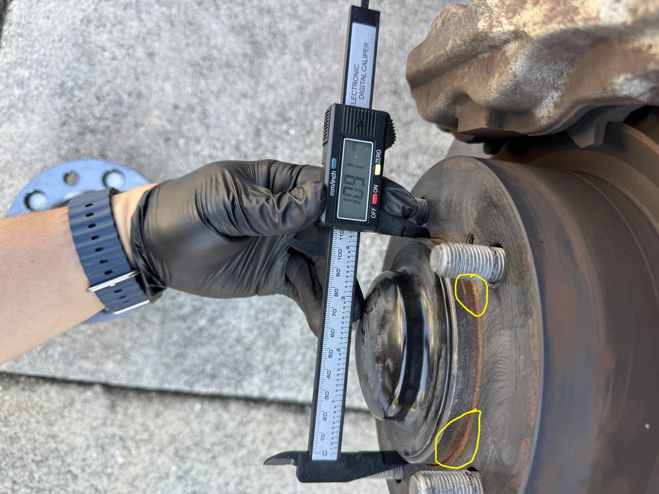

I bought Spidertrax 1.25” wheel spacers from Slee, and unfortunately, they’re terrible. They have way too much play and don’t fit snugly on the hub. It was suspicious when installing but I followed all the torque specs and installation instructions. Driving around town was fine but once you hit the freeway and travel 80 mph+ on the highway, the entire vehicle had a nasty vibration – like something you’d rather not relive from an ex.

when installing, do you remember if you had play in between the hub and spacer like mine?

I can't see all the detail but the hub is supposed to have a area that makes up the hub centric ring. The areas I circled looks like there is some corrosion on that area. Not sure on the 200 if it has a small step like the 80 hubs. However that area needs to be clean all the way around.
Does the spacers exhibit the same behavior on all the hubs? Can you post more detailed pics of the areas circled and also compare with the other hubs on the vehicle.
Does it move up or down or does it rock on the mating surface. Can't really see on the video.
These spacers should not have play on the hubcentric part and does not require special install with conical lug nuts.
In short I would make sure you are not hanging up on corrosion on the hub.
One more thing also but did you install the lugnuts on the spacers with conical side towards the spacer.
