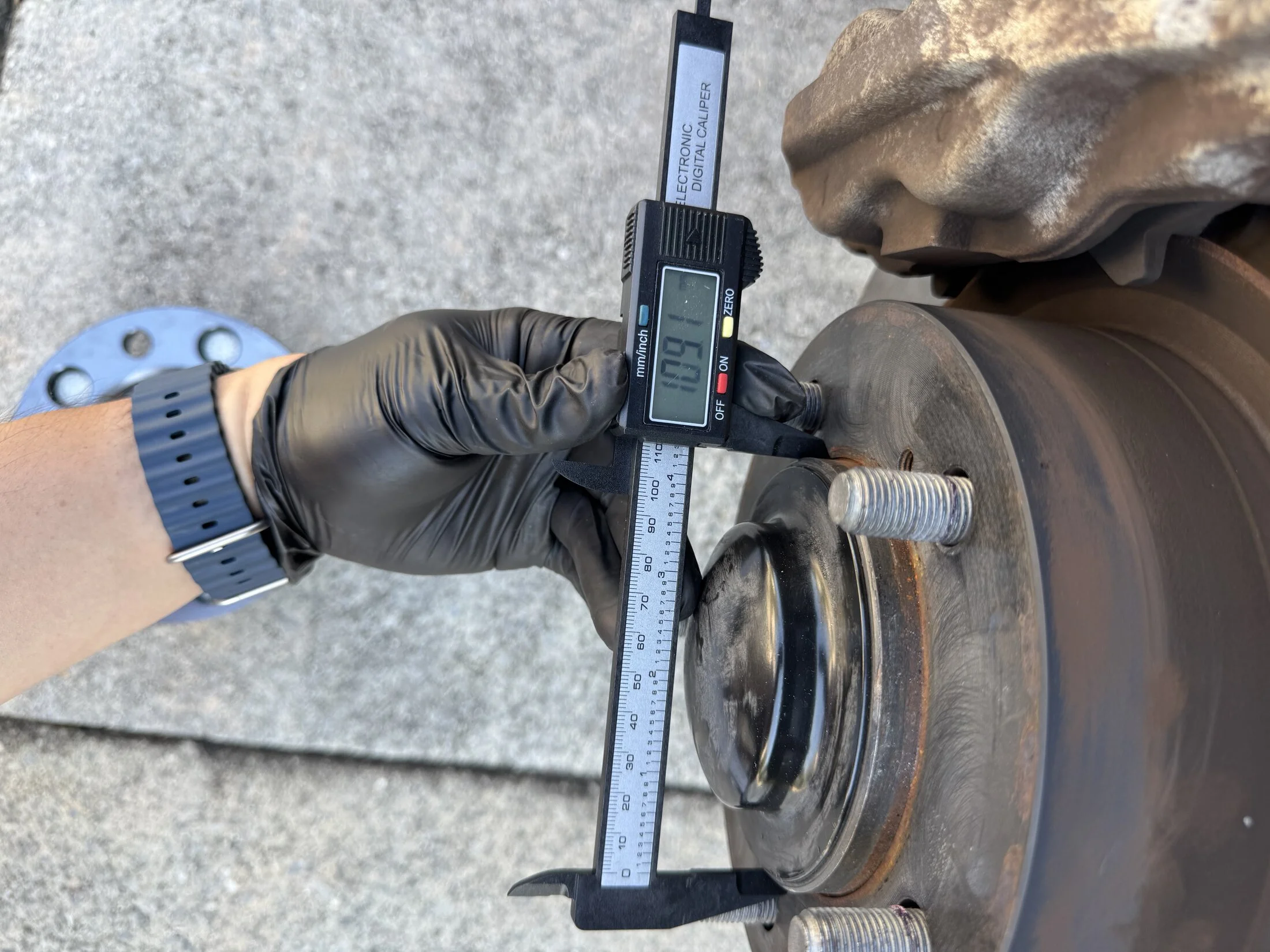

throw a caliper on the spacers, they’re either true or not. Then go back and clean those hubs again, tighten up to spec and then go back for loctite one lug at a time. I’ve used Spidertrax on multiple Toyota/Lexus with stock wheels and oversized tires and never had an issue, so maybe I’m overconfident in their QC, but I usually chalk things up to user error until I can confirm it’s not my bad.
Main take away clean the hubs really good, clean the rotor hats inside and out and the inside of the wheel, red loctite on stock lugs and tq down in a star pattern. Also for good measure use a db of grease on the all matting surfaces.
First though get a micrometer and measure it hopefully someone can do the same and make sure yiu got the right part in the box.
My micrometer may be off. It’s a cheapo from Amazon.
