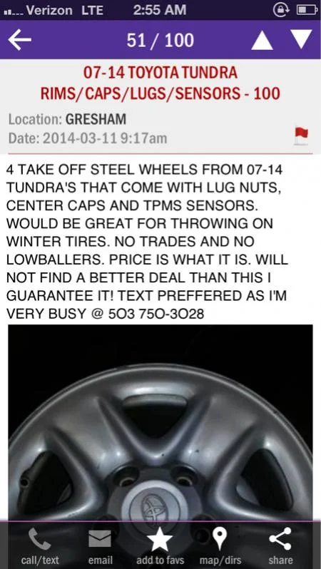

If you need a set with TPMS sensors
Cheap and near you.

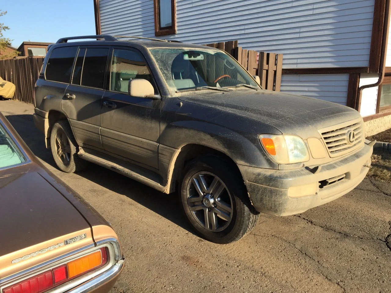

I just wanted to confirm that 4 18x8'' Factory alloy wheels from a 2014 Toyota Tundra would work on my 2001 Lexus LX470. Thanks for the help! Probably a dumb question...
On the center caps, am i understanding this thread correctly that I can use the center cap from my oem wheels? Or will i just have to leave the center caps off?
If you have OE LC caps, they will fit Tundra wheels, although they leave a small gap which most people would never notice. When mounted on the LC, the Tundra caps will only fit the rear. The front hubs stick out too far. If you run wheel spacers the Tundra caps will fit all four. The Tundra cap, does make a nice trim piece for a bumper mounted spare.

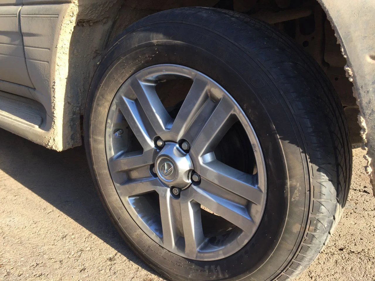

I got the 18" Tundra whlz As a back up set and I cdnt get the front caps to fit or my lx caps either. Tried cutting a hole out for the hub and one tundra cap barely fit and the other hits the hub bolts and won't go on...

Thought just occurred to me that If I ran a spacer up front I'm sure the cap would fit!
