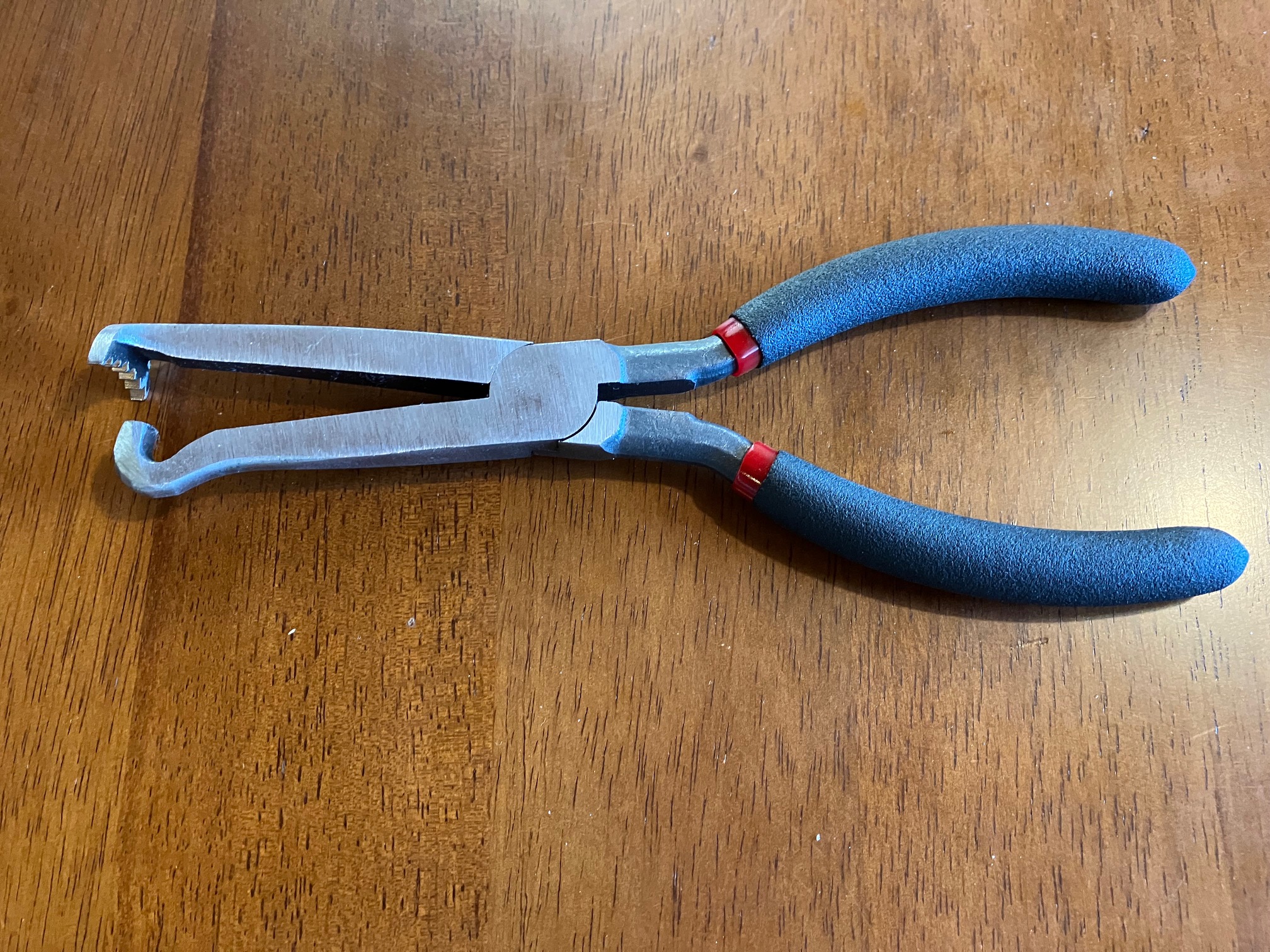

I used electrical connection release pliers (below). It still took some fiddling.
i think these would be easier to use. It looks like it would be down right easy, if I'm picturing it correctly in my head. I used a telescoping mirror that has small LEDs and a light shinning in the mirror at the right angle to reflect onto the plug so I can exactly where the tab is, so i have a pretty good idea of what i need/how to do it. Only unknown is the size of the jaws (if they're too big)
The pliers I had (I think they're made by Lisle) work best when you can apply them in line with the connector and pull straight back. I couldn't do that with the accellerator pedal plug. I managed to get them to work kinda sideways. The offset ones might work better.
Given how hard these plugs are getting to release I think I'm going to end up with a couple different sets of these pliers.

the ones i bought are gonna take a few days to arrive. I'm taking the truck in tomorrow for a multi-stage paint correction and some PPF - its supposed to rain for the next 5 day, so it'll be a week at least until I can see if the set I bought is going to work. I'll report back how well they work

I used the pliers and this mirror (to see where to place the pliers), and I had the plug pulled in a few mins, including the time it took to wiggle under the dash (and I a large man) and remove the lower dash piece. It took around 1 min from the time i got the mirror in place to getting the pliers in place. came off 1st try.
