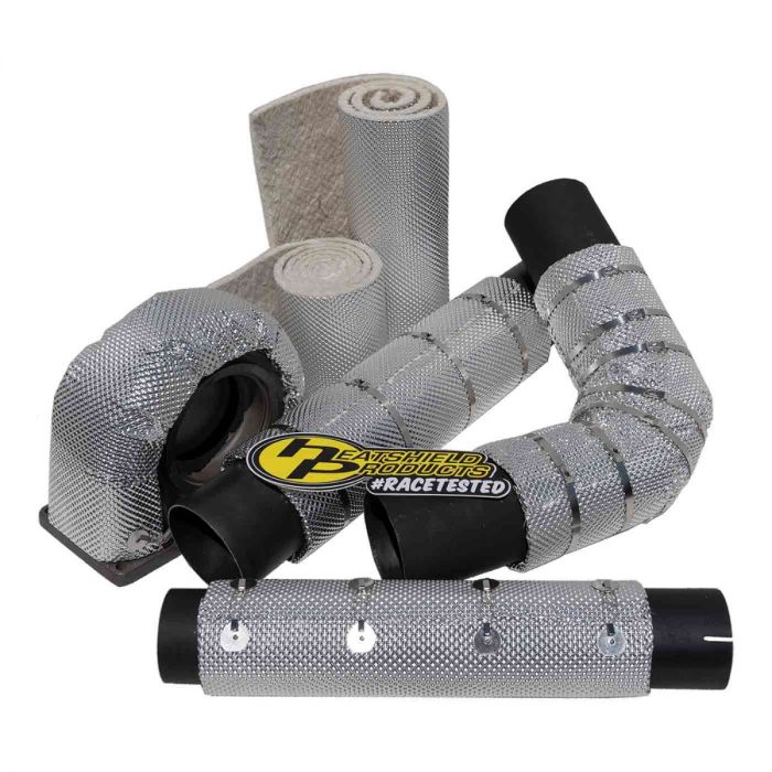

Yeah, there's a metalized 1/2" thick blanket that is about $25/ft for wrapping exhaust pipes. It is far more effective than the motorcycle wrap, it basically reduces the heat emitted:
There is a sticky reflective product that could be used on the fuel tank directly opposite the muffler or fitted to the fuel skid sticky or mechanically.
I just researched this to add a bit of safety factor to my new fuel skid, which doesn't extend up into the tunnel as much as the stock skid.
