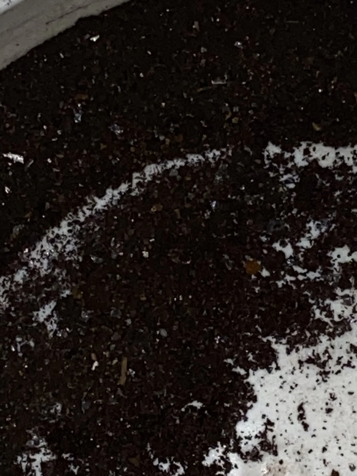

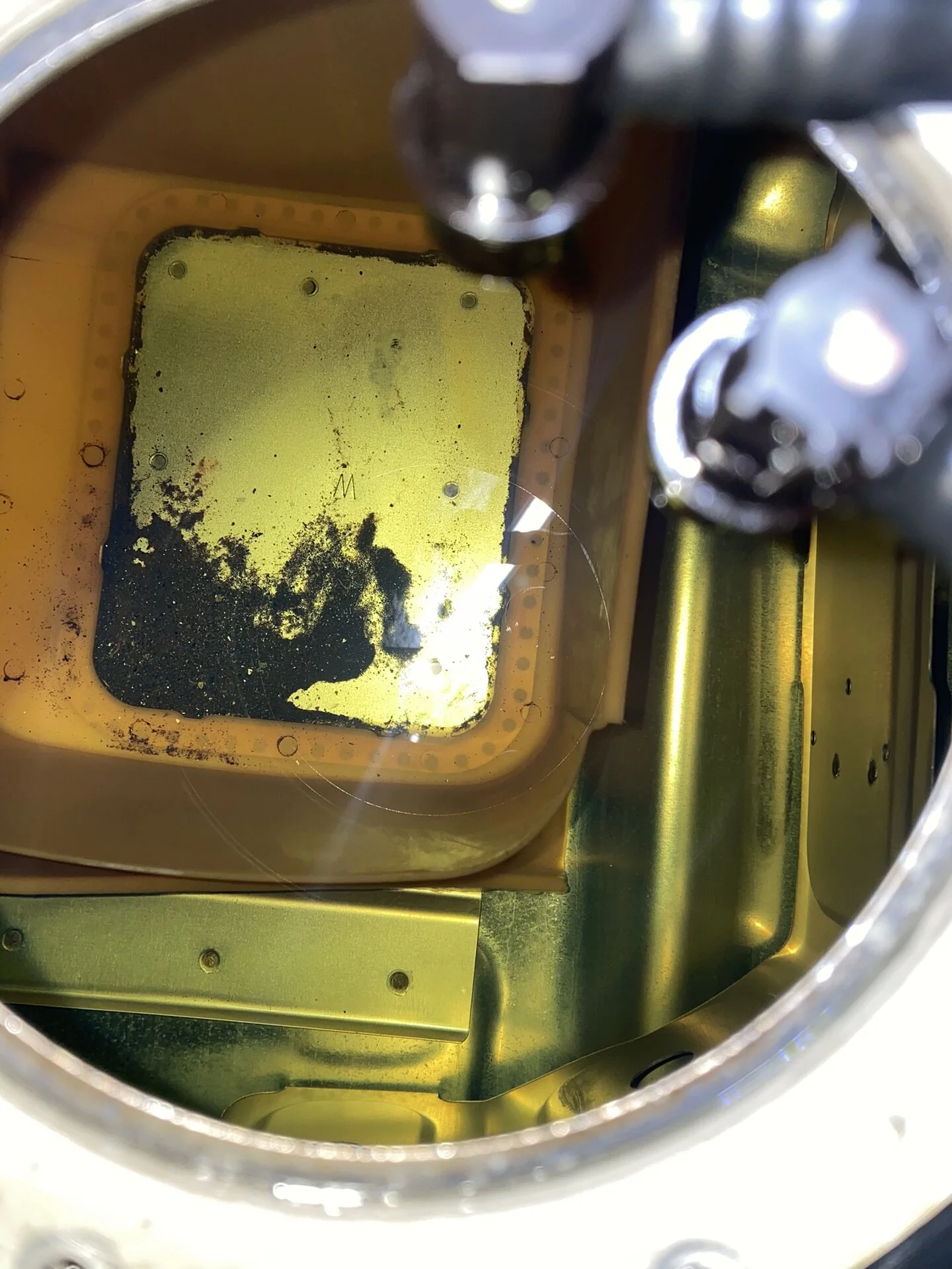

Found a surprise. Which was only found in the basket where fuel pump & sock resides. 06LC w/250K miles. No indication tank ever unsealed (pump out).
Notice area outside basket is clean.

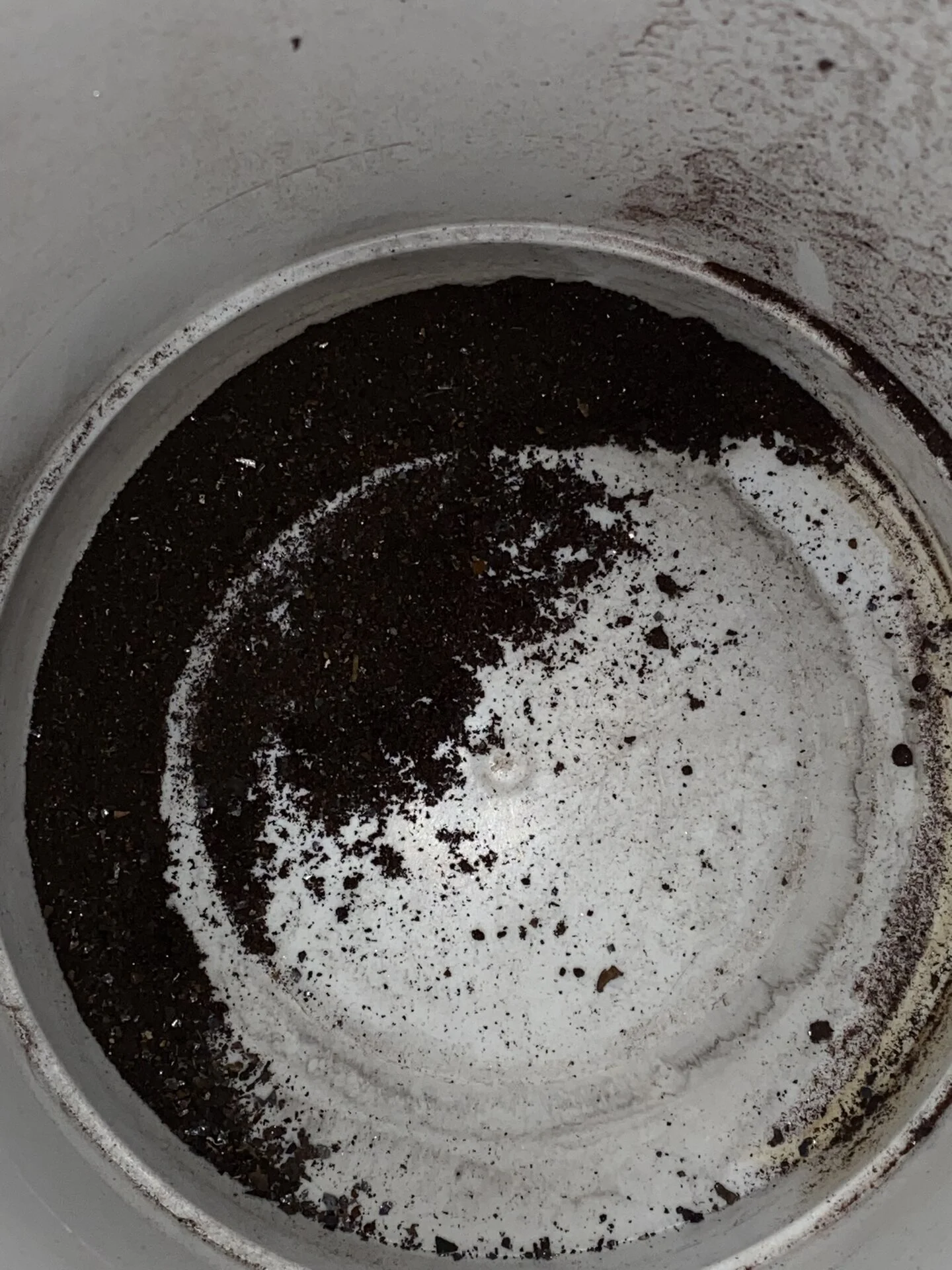

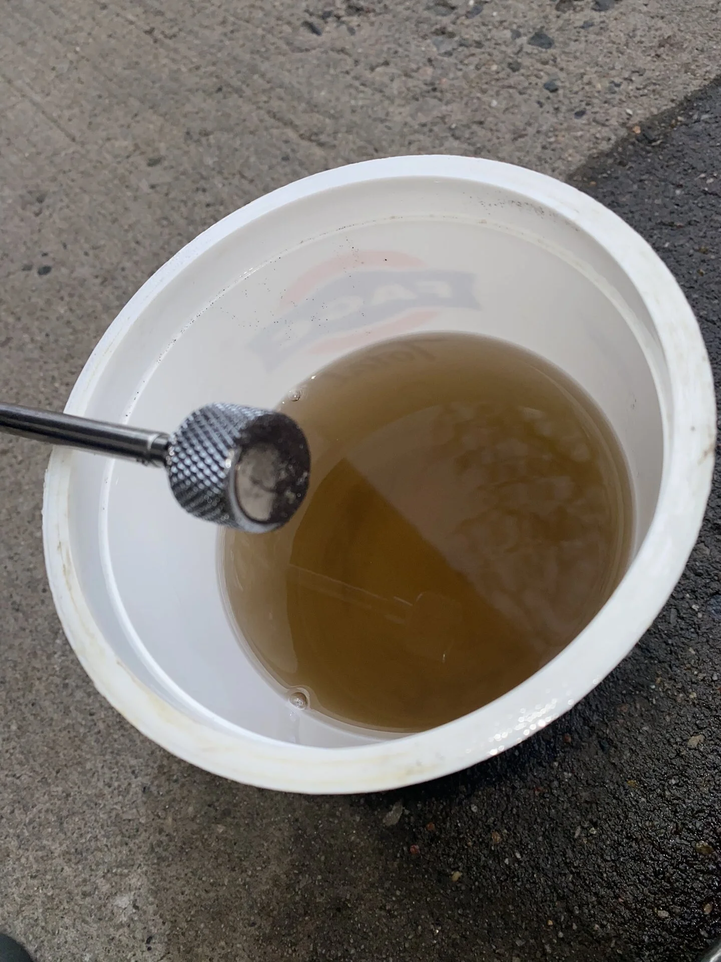

Blew out filter into container.
Stuff dried fast and would not rinse out with water.
Probably rust that has come in with gas at an old gas station. Modern gas stations are using plastic ground storage tanks. This is why we need to replace the fuel filter say about every 50K miles.

But only found in basket? Which I would think we'd see outside basket, which I do not!
You're correct it is rusty and Magnetic.
After drying

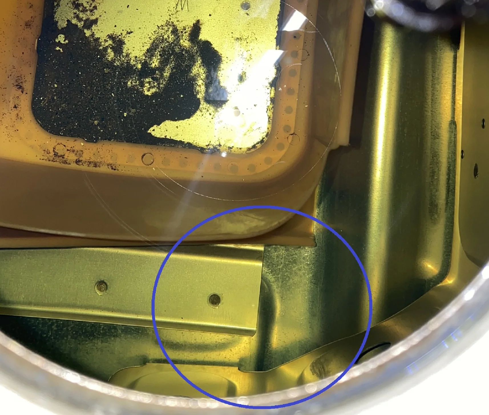

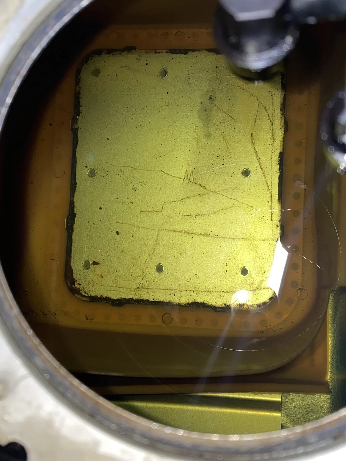

I vacuumed stuff off bottom of tank, than drug a magnet around. (I did few more cleaning passes after this picture)
I suppose more could be out of view, at forward outer corner of tank. Like we see more in corner of basket. But surprised not seeing some here (blue circle).

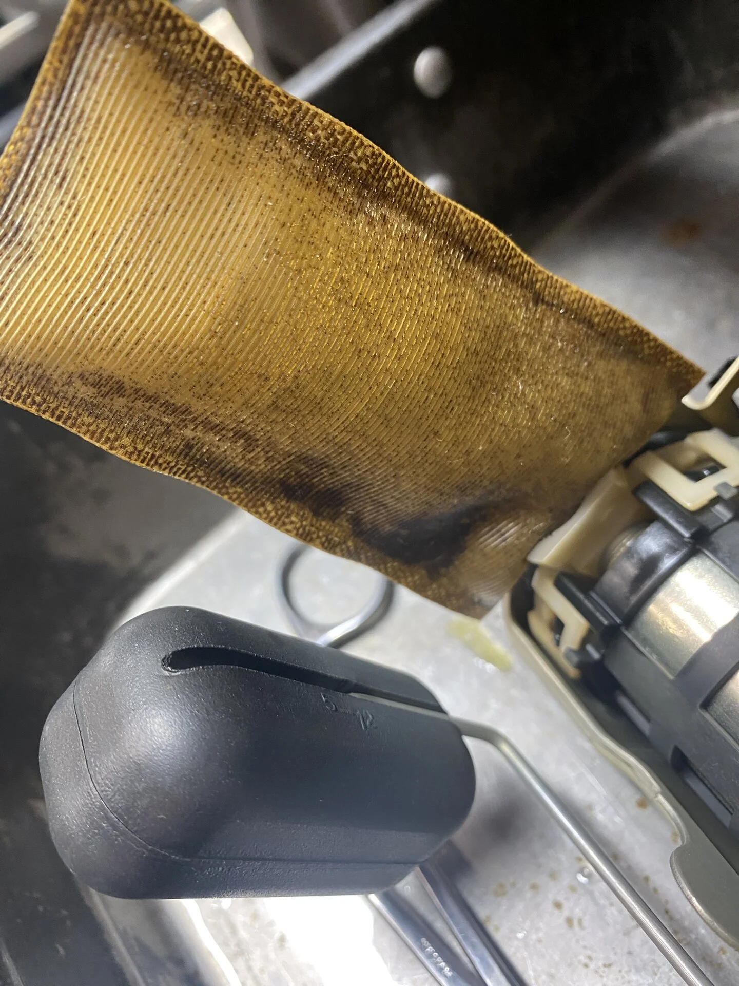

Good to know fuel pick up sock & fuel filter doing their jobs.
No sign of corrosion inside the hard lines? Seems like it would have to come in through the return to only be located there, but I suppose it's possible over time that particles got stirred up by sloshing and were pulled into that sump by the fuel moving into the pump?
Return line is a possible path. But rust free CA rig, w/relatively high miles. Not like fuel just siting in tank or lines rusting them. If low miles, it be more likely than a high mile vehicle.
Sloshing around and what sock held back, is very good guess.
Likely bad gas, from same station with old tanks. Over time what sock held back, is what we now see collected in basket.
