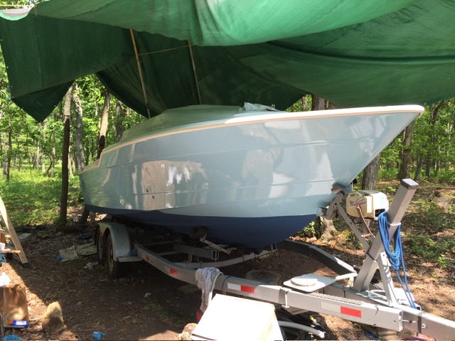

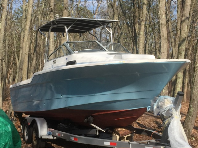

When I painted this boat…he told me what to use and what to mix. This boat banged against the docks for 7 years while I had it and never showed 1
Bump or bruise and it was never sanded or buffed
