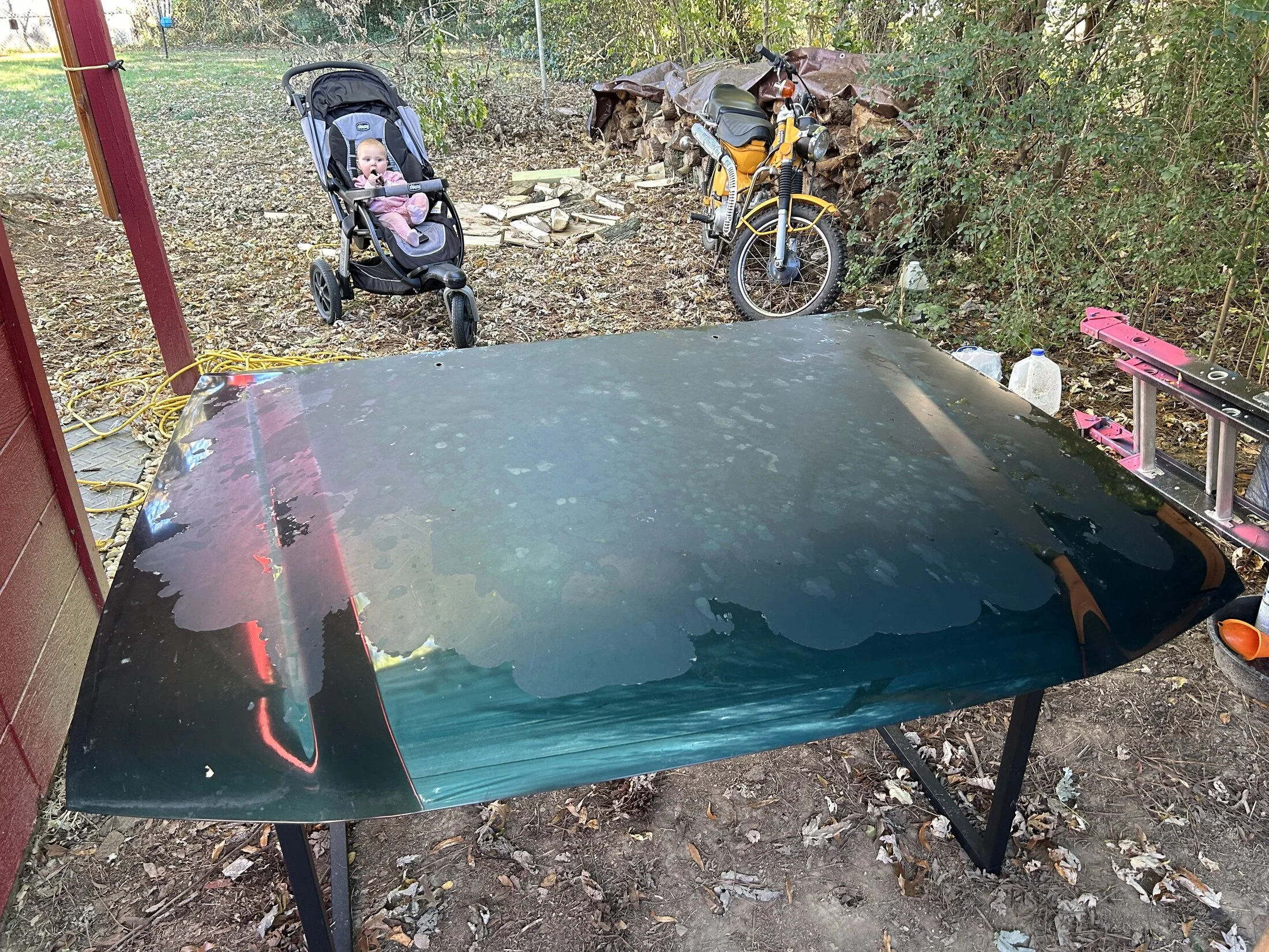

What are guys on here doing? Repainting, wrapping or something else?

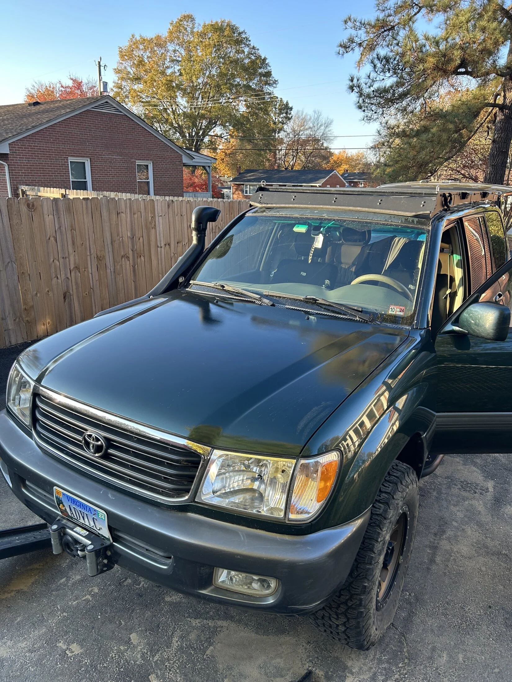

I just had my entire truck re-painted due to failed clear coat on every horizontal surface.
That green is so nice. If the rest of truck is in good shape and not super rusty, I'd get it painted.
How much did you pay for a full paint job and what part of the country are you in?
I'm in Northern Virginia (expensive market). It was tough to find shops that were interested in doing it. Estimates ranged from 4k (Maaco) to as high as 16k (doors off, glass out). Collision shops flat out told me they don't do re-paints, only insurance collision work. The average Estimate from decent paint shops was 10k.
In addition, most shops around here are a month or two out scheduling. There's no shortage of demand. The couple shops that gave me an actual written estimate were saying 90-100 hours in labor. And my truck is zero rust, no accident, couple minor door dings.
A couple shops didn't even have time to do estimate for me, just said their full paint jobs start at 10k.
I ended up getting a high end paint job but at much lower cost as I did a lot of the prep, disassembly and reassembly myself and basically lucked out (long story). There are good paint guys out there at reasonable costs but it takes some work to find them sometimes!

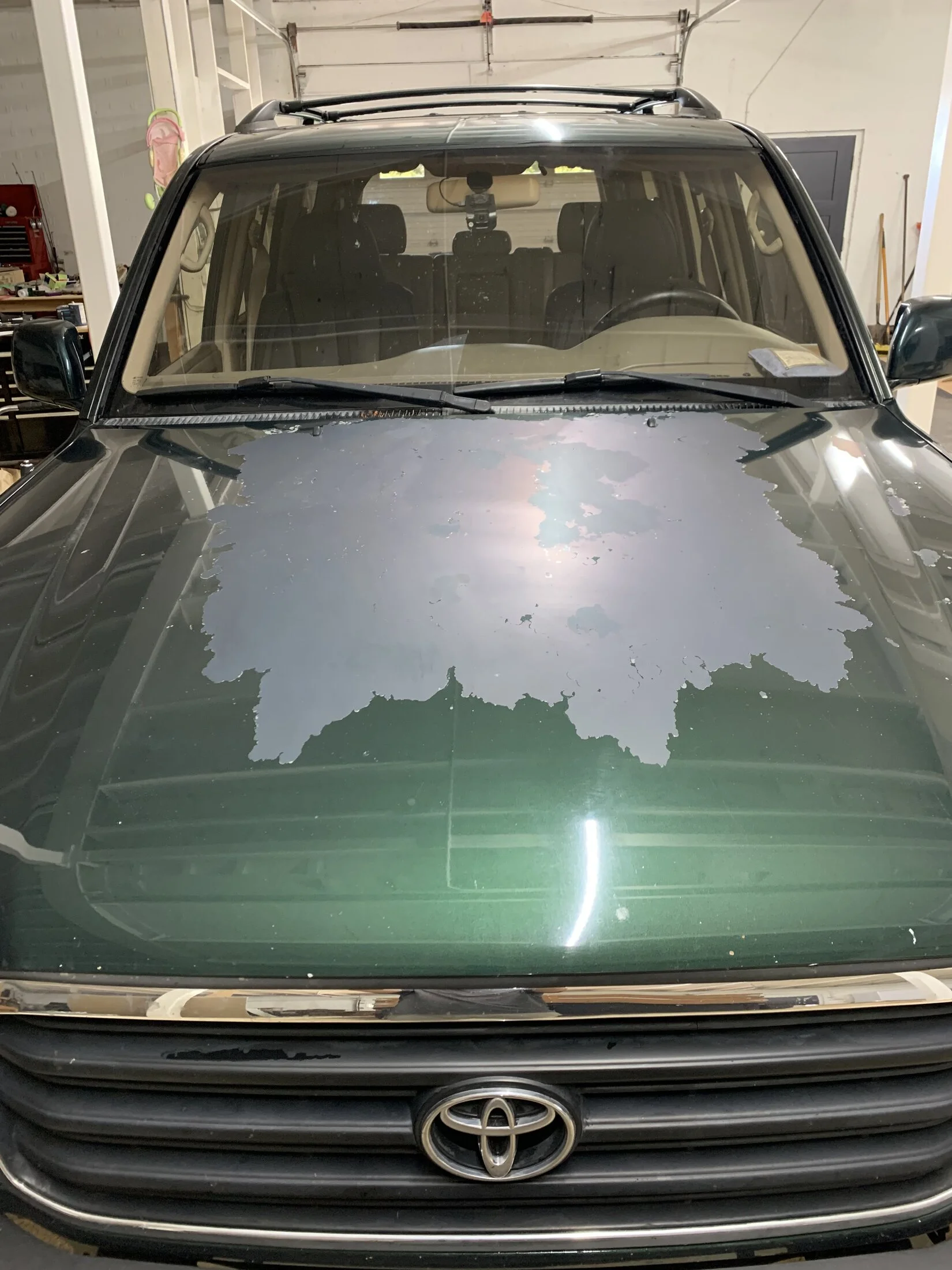

There are several ways you could approach this. First, get some cutting compound and see if you can buff out the center region where the clear has already come off and see if the paint comes back to the original color. If so, you can proceed with removing what's left of the old clearcoat wetsanding with 1000 grit or finer. Sand the old clear coat outward in toward the open section in the middle where the clear has already come off. Avoid sanding that region, only sand up to the edge. As it thins, it will come off. Then buff the whole hood if it looks like the paint is in decent shape. If good, you can either wax it or have another clear coat applied. Speak with a few shops, clear is almost always applied within 1 hour or so +/- after spraying the color coat. They may have differing opinions about new clear over old paint for adhesion.

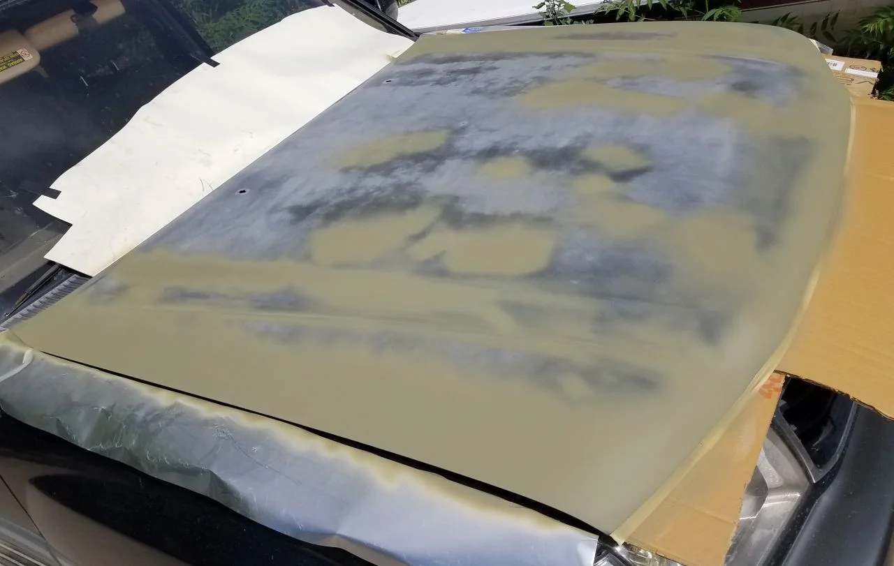

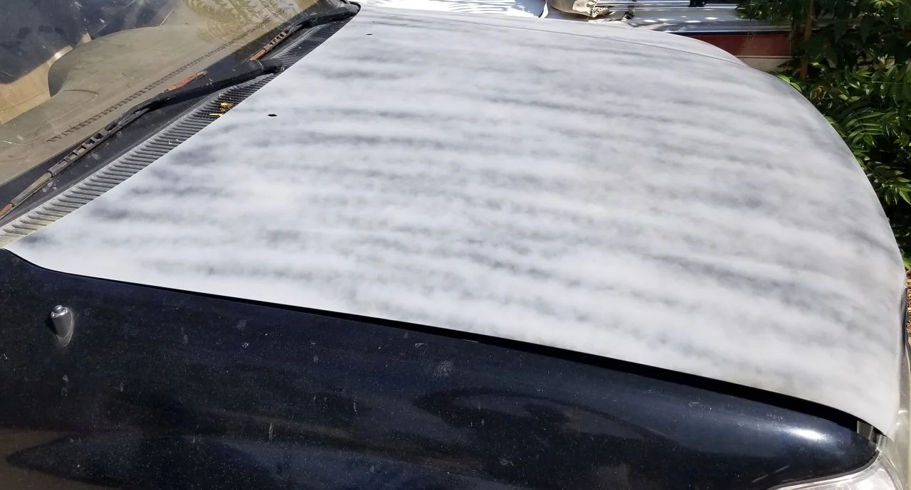

Second option, prep and re-paint the whole hood. My 2000 came off lease in 2003 from SoCal near the beach and had a few nasty spots etched thru the paint down to primer from acidic sea bird poop in huge splotches. I had the hood and tailgate professionally re-painted 15 years ago for $1100 at a reputable shop. Looked great for 8 to 10 years then the clear started to fail. I started this morning on re-painting it myself. I would consider my skills at somewhat intermediate amateur level. It looks like the shop applied the base coat over bare metal. I sanded it back to bare metal wherever the paint would come off easily and left a good feathered edge into solid paint. The grey is well adhered clear coat. So far I have the bare spots sprayed with a heavy wet coat of etching primer and will spray the whole hood in sanding primer tomorrow. Then block sand and deal with spot filling numerous rock chips and spot primer again. Then shoot the whole hood with sealer, let it dry for a day, then shoot single stage color coat urethane enamel with hardener, cut and buff after it dries and call it good with no clear coat. Clear coat is good for maybe 5 years in New Mexico unless garaged all the time and only driven at night.
I enjoy doing body and paint work as a hobby. You could probably do yours starting from scratch for about $500-600. $160 for a Harbor Freight compressor, $30-40 for a decent spray gun, $80 for a random orbital sander, $50-75 for an assortment of sandpaper, $150-200 for primer and paint. Another $25 ea. for OE windshield washer nozzles which will probably break when you try to remove them. Clearcoat optional. If you don't like the results, you can always sand it down and do it over again. Don't use rattle can products on a project this big, get hiqh quality primer and paint from an automotive paint supply shop. I use Napa here and am pleased with the quality of their products and the guys at the counter are very helpful providing tips and do's and don'ts and material selections. Epoxy primers are great but can take a little longer to cure and some have issues with adhesion of subsequent layers of primer and base coat.
I put 6" wide aluminum roof flashing on the tops of the fenders to keep the sander off of them, doubles as masking.
