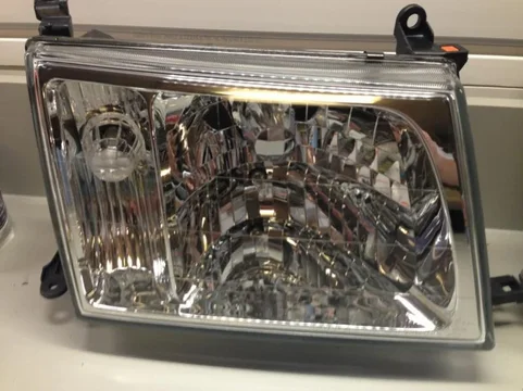

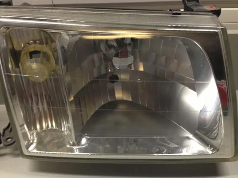

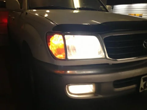

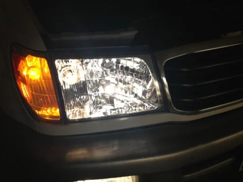

For 0-500, I'd replace your headlight assemblies. By now your inner reflectors are oxidized and not performing anywhere close the when they were new. I just changed mine out ('99) and it made a huge difference to my light output!
Old
New
