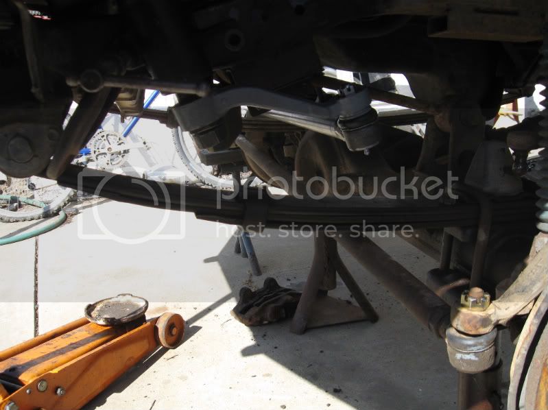

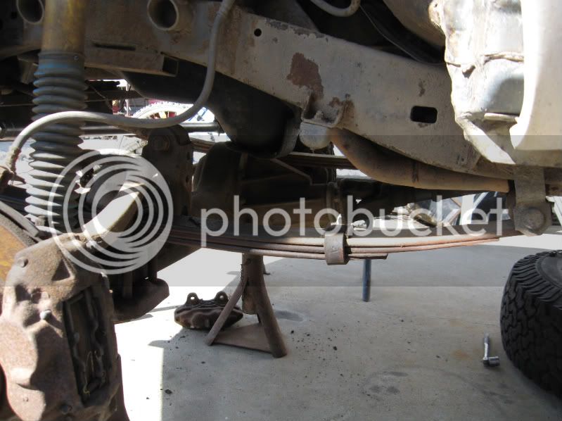

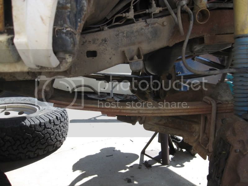

Truck is an '84 Xcab that came to me with lift springs on the front and they are about used up. I have no idea even who made them, which is too bad because another set just like them would be great. Their ride height is just about perfect and their durability has been exceptional. They are a three leaf pack, but I'm not even convinced that both came from the same mfg. They are that different in the way that they're made.
Also, whatever was originally welded to the frame for the bump-stop to hit on was cut off by the PO.
From the bottom of the frame to the top of the spring perch I measure 10 inches. This is in the stock spring mounts with stock shackles. I figured measuring to those points would eliminate any differences in springs and my lack of OE bump-stop pads. I'd really appreciate it if folks with known lifts could measure that same distance and let me know what it is.
In the mean time I'll start researching what ppl have to say about the various springs available.
Normally the three leaf springs are not the most sophisticated on the market, and they do not have any anti-dive control built-in. Some photos of the springs would sure help!!!
This is all part of a major front end repair/rebuild/upgrade, so the various issues visible in the pics are being addressed.

I guess more than who made those springs what I need to know is how much lift they provide. Then I can judge replacement candidates based on if they'll not be more or less lift than what I currently have. As the truck sit level now, I'm really hoping to maintain that.
Since my frame has been modified and different spring packs will have different thickness I measured from the top of the spring perch on the axle housing straight up to the bottom of the frame rail, and at ride height I got 10 inches. If someone with a known lift spring could measure between those points on their truck, then with knowing what their spring is and that distance I can make a guess as to what these springs lift amount is.
look like about 4" procomp what year truck? tire size?
Those do look like the old school Rancho's. Or Burbank suspension.. If they are rancho's they should have Red spring bushings (not an exact tell but it helps).
