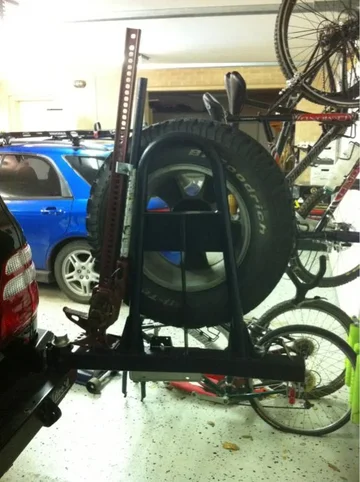

I have a 48. It fits much better on the Slee dual swingout rear. I will probably get the 60 for trips because there have been a couple of occasions that I wanted a little more length or leverage.
Here is the 48 on the Slee. You can see how rediculus the 60 would be. I wouldn't be able to get in the garage.
If I had a rear swing out bumper it looks like I go 48"
