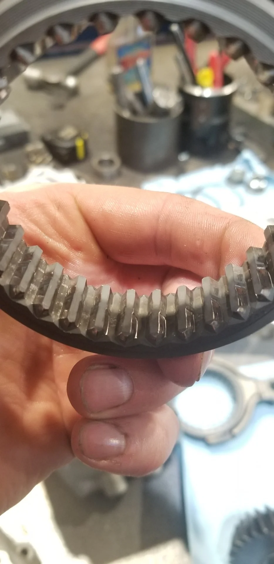

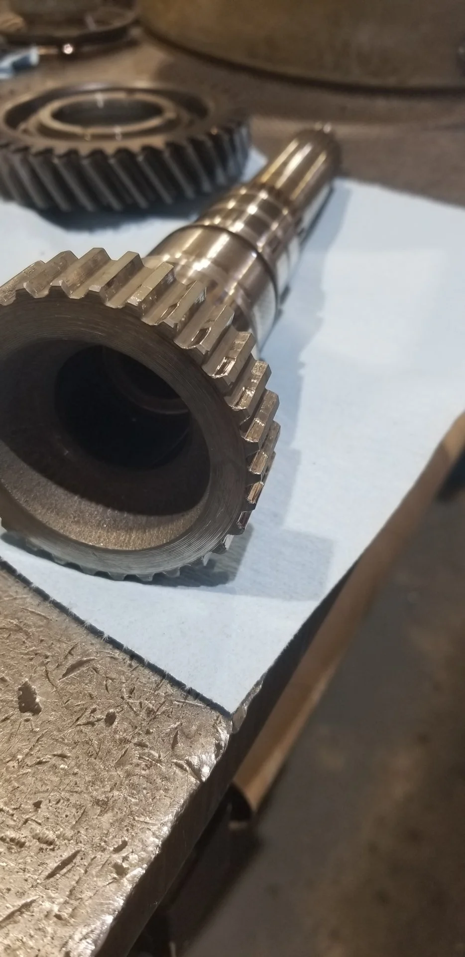

This is the output shaft on my RF1A. As far as I can tell, the bearings are in really good condition.

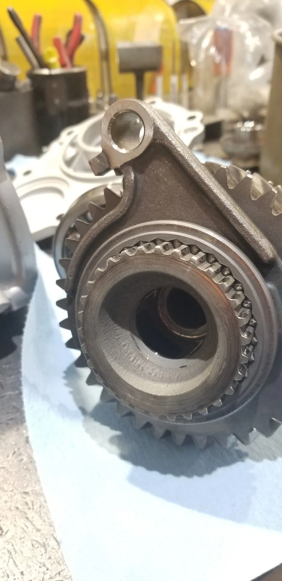

Heres 2 more pictures. With the low speed gear on the output shaft, clutch engagement hub installed as if it was in low range. So the wear seems to be happening while in 2wd.
I do have a doubler, and now I wonder if this is from "excessive" use of the reduction box for 2wd low range. Which I do quite often.
It has also crossed my mind that this is natural wear and tear of daily driven 5.29's and 35's.
I wonder now if the hardening has been pounded out and polished that I will have proper failure sooner rather than later. The only reason the transfer case is apart is to reseal it.

Yes, you are to believe in the splash, not the hype.
