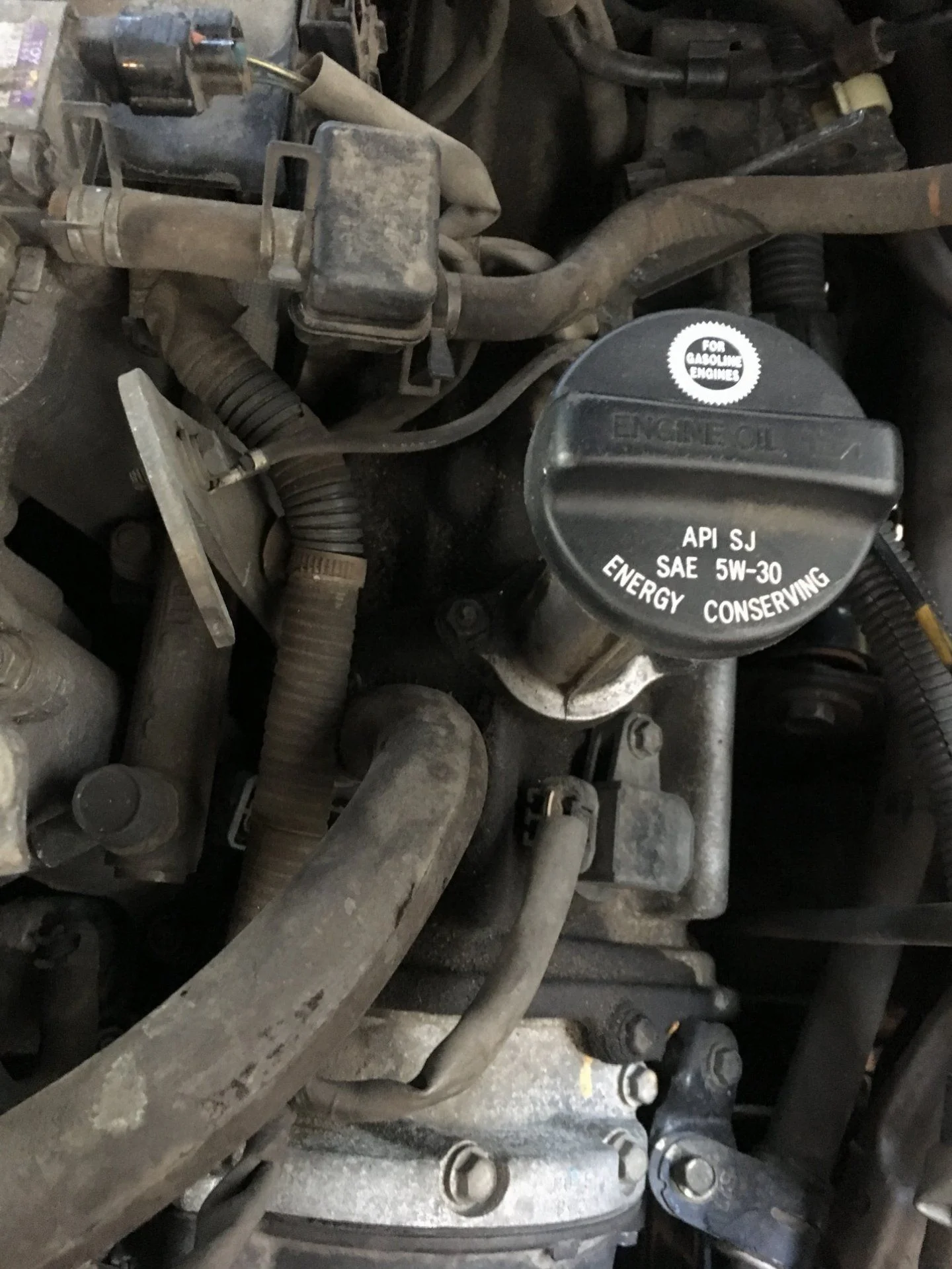

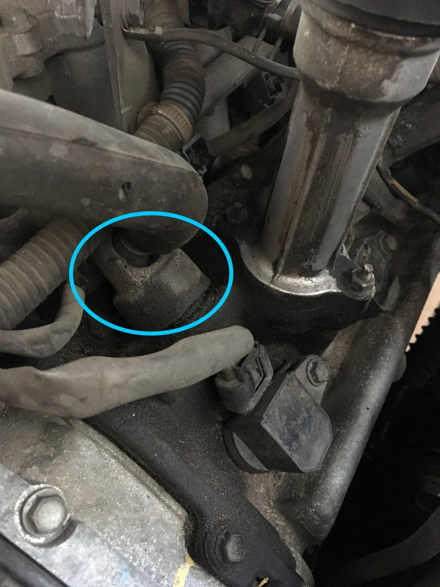

What is leaking on top of my valve cover and what is the thing and hose circled? Either urgent?
PCV valve. What year is your truck? My 2000 has a grommet that gets brittle and fragile.
Positive crankcase ventilation.
Its only a couple bucks, just replace it!
The PCV should be replaced every 50,000 miles or so, it's cheap, it's required, replace it.
When it gets clogged, it will cause pressure to build up inside your crankscase and cause engine seals to leak.

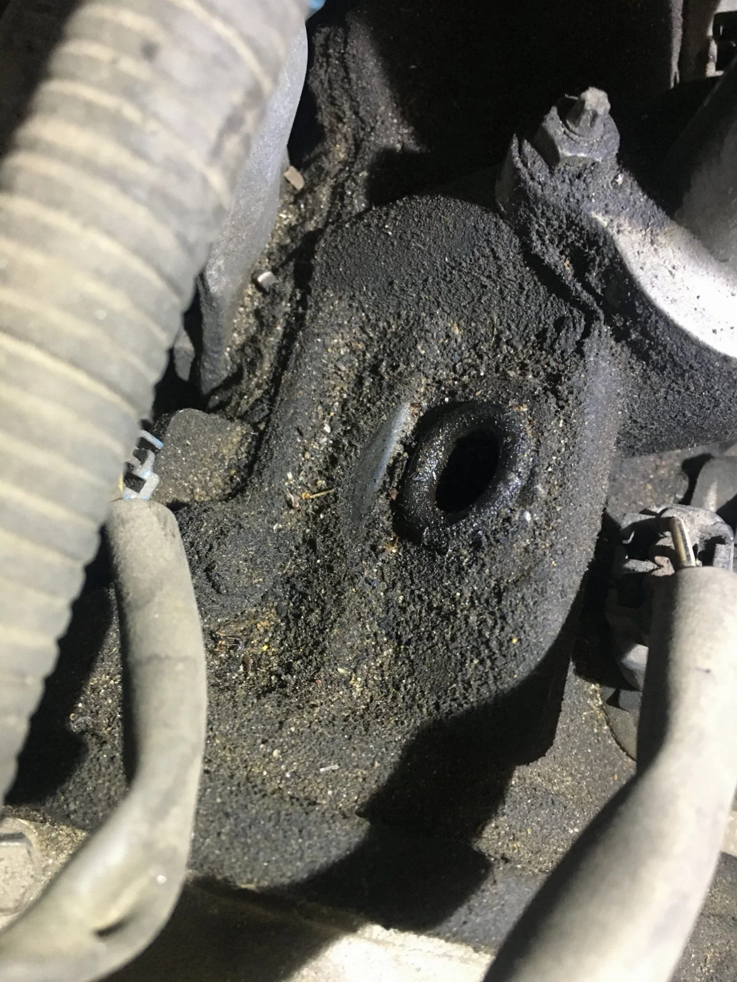

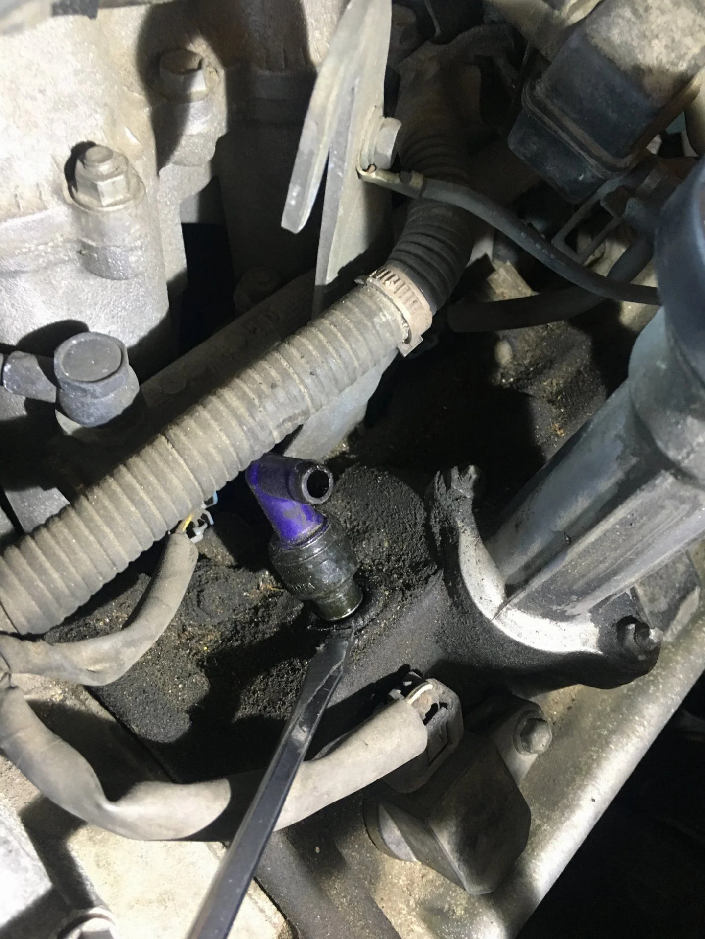

Just replaced the PCV valve. I feel sorry for the homies that have had lots of trouble getting this thing out, mine popped out with a flat screwdriver... Maybe why there is plenty of caked on oil around the hole? What's the best way to clean the valve cover without getting debris in it?
Degreaser and water. Just make sure the PCV is in place.
