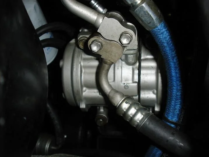

I have a customer w/ a 3F in his FJ55 and his AC compressor doesnt work. The issue is that the compressor that i ordered for a 88 FJ62(88320-12520-84) doesnt work. There are about 4 different part numbers for 3FE compressors depending on weather they came from 62s or 80s and I need to figure out which is the correct one. A 91 80 uses a (88320-14521-84) and I think that will be the next one I try if I cant figure this out.

I don't recognize that one. Any identifing #'s on the old one? How many grooves on the clutch? Where the plate bolts on the compressor, for the hoses to attach, is it 2 seperate sections, or just one common space? I have lots of Denso product, but I can't distinguish which one it is yet. More pic's might help, or some #'s.
