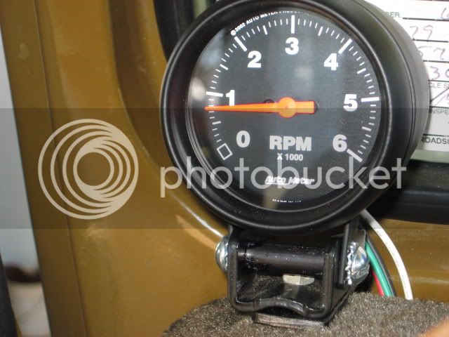

After 30 years I decided to put in a tach
