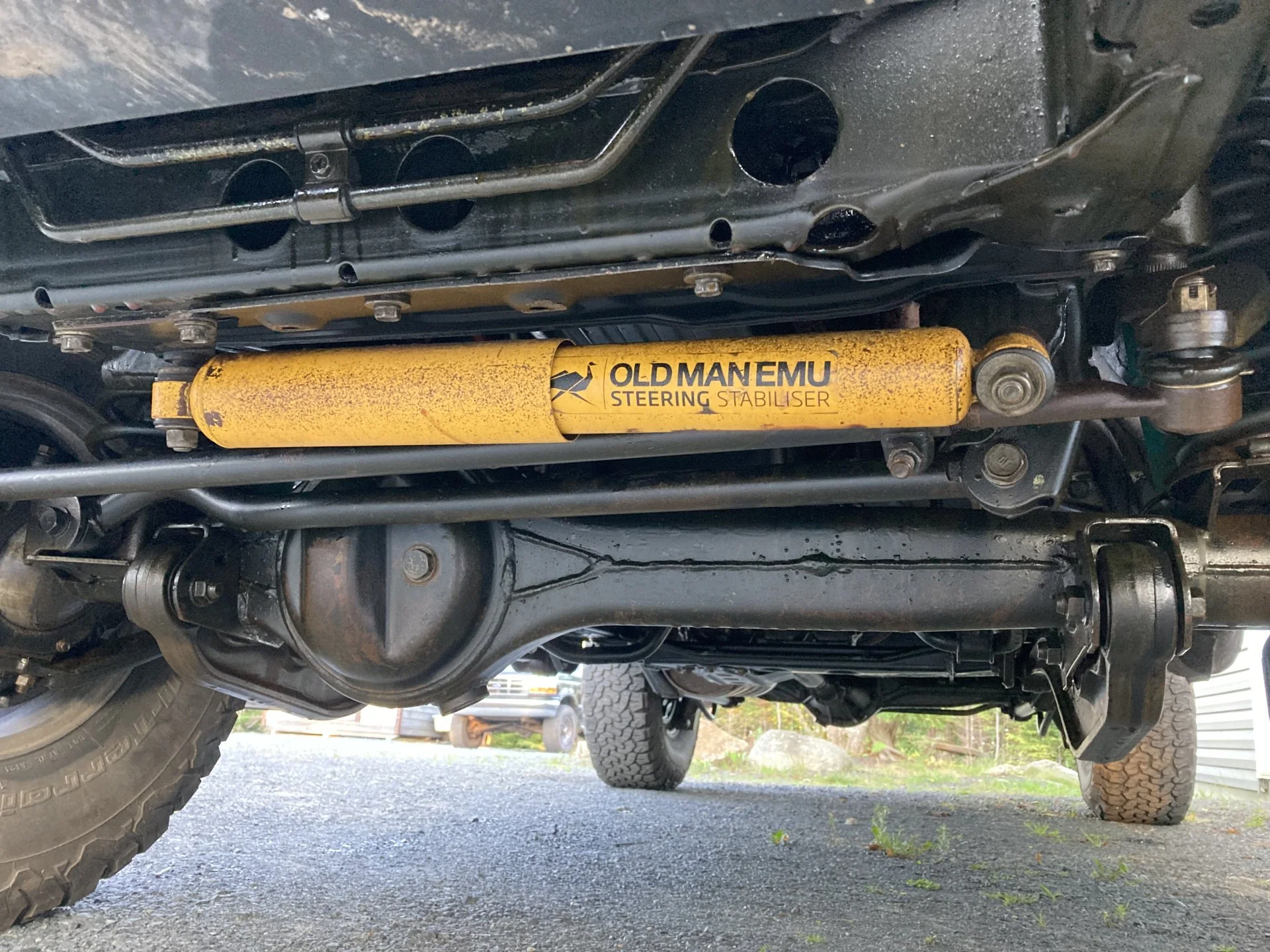

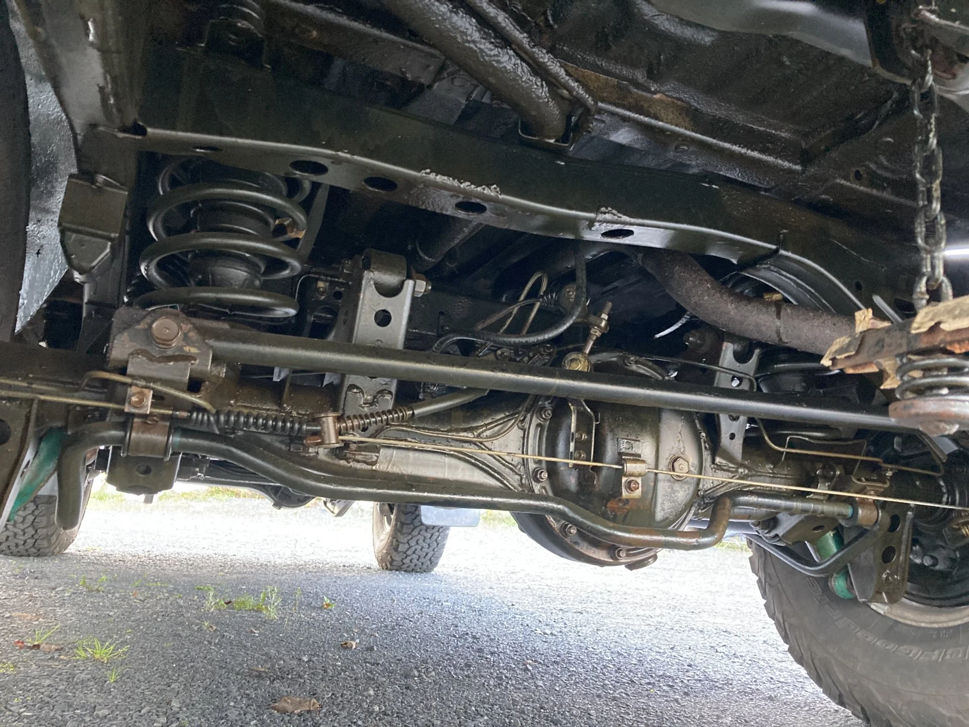

As well, I should add - my rust-free 80 series has been undercoated in Rust Check and stored the 3 winters it’s been here.
But, I’m trying a new (to me) type of Cosmoline undercoating and going to try running it this winter. It’s a risk, but this cosmoline stuff resists wash-off like crazy and I laid it on thick. If it shows signs of deterioration in the spring, I’ll discontinue winter use.

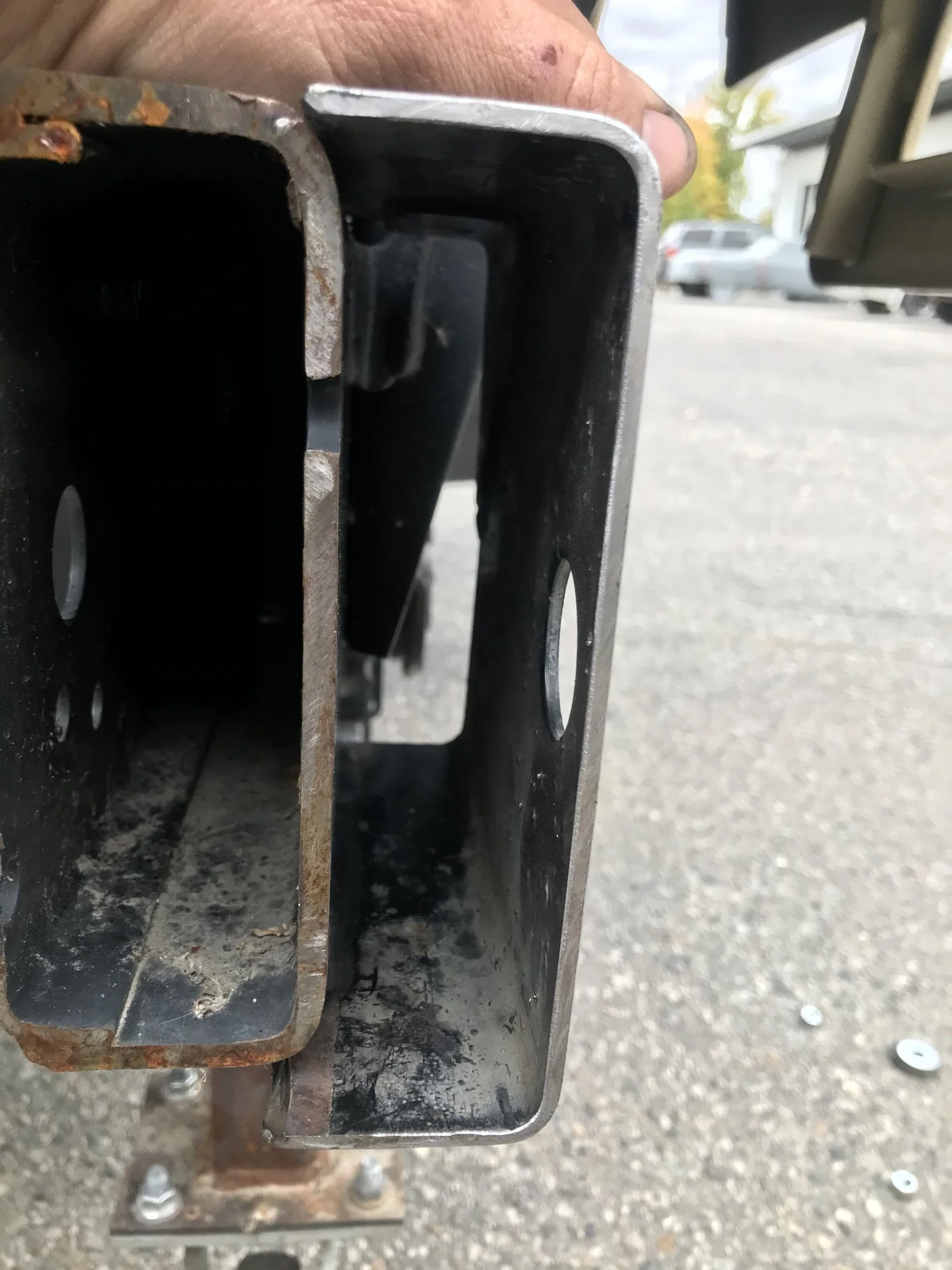

The 79 is a fairly heavy duty truck and much newer than the 80. I'd like to see a comparison between 80 series and the 70 series wagons.

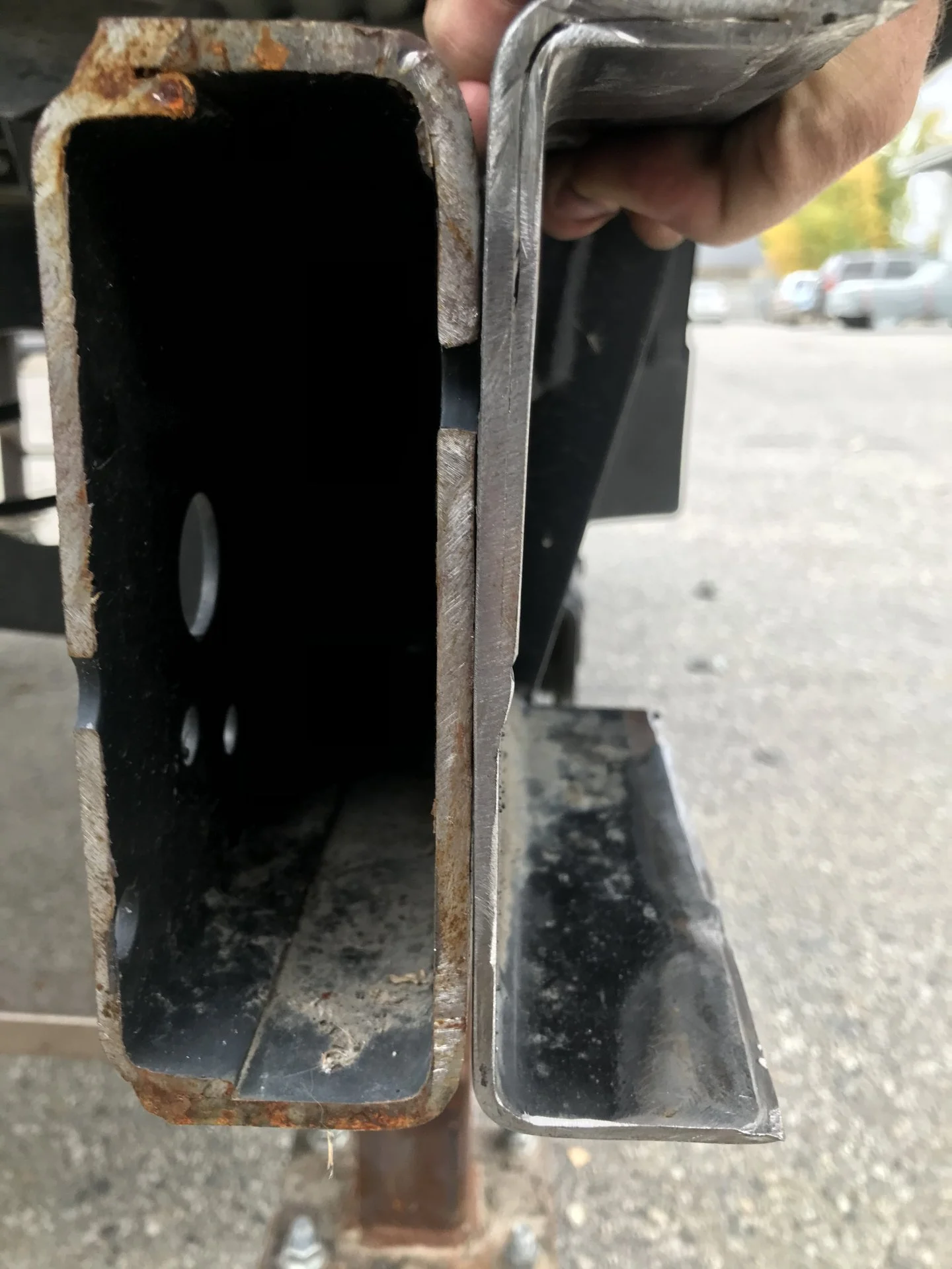

I cut up a 1993 HZJ75 frame. While not quite as beefy as the 2018 79 it was still more beef than an 80.
And hey I am not saying an 80 frame is weak. Just showing differences on different models.

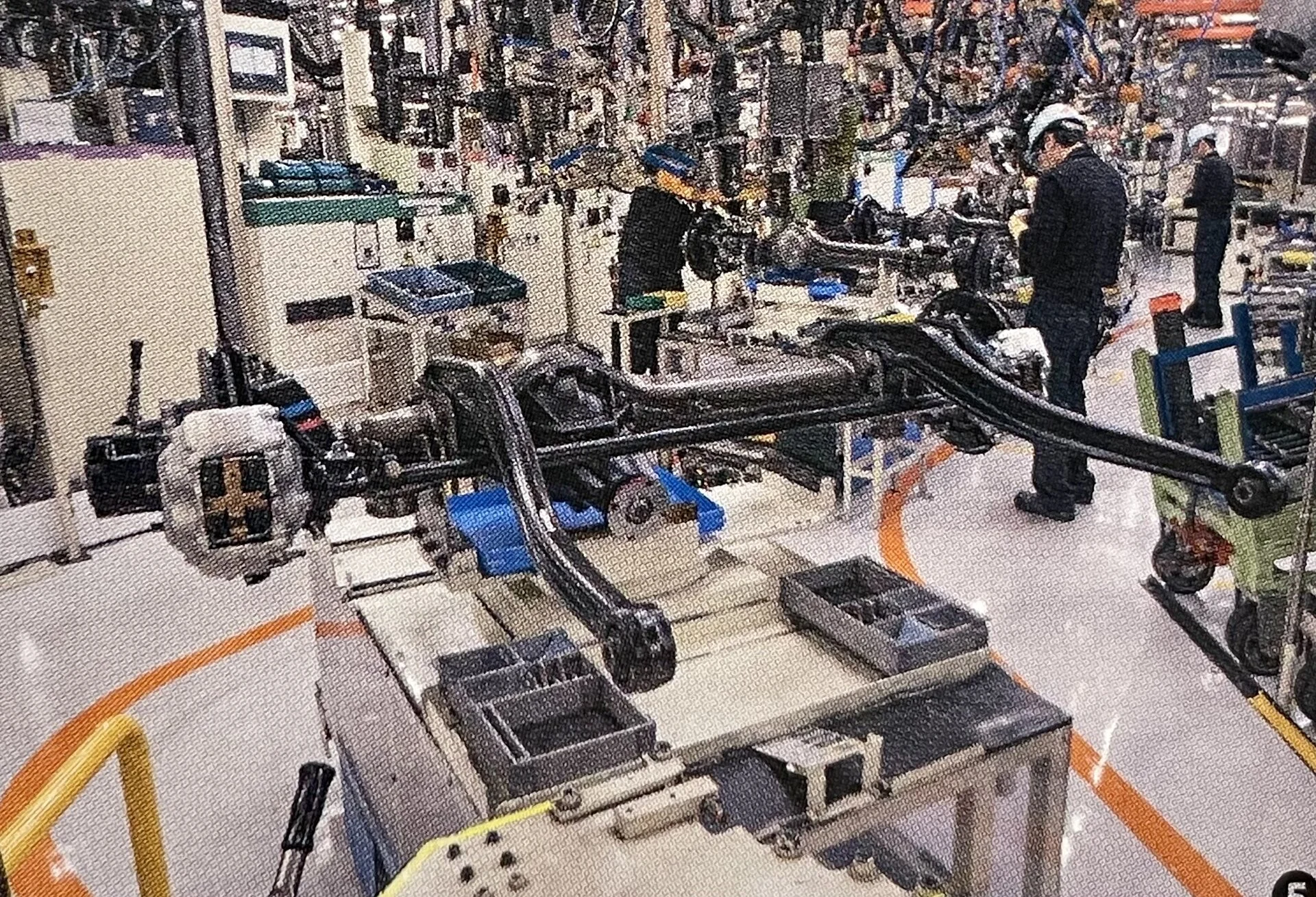

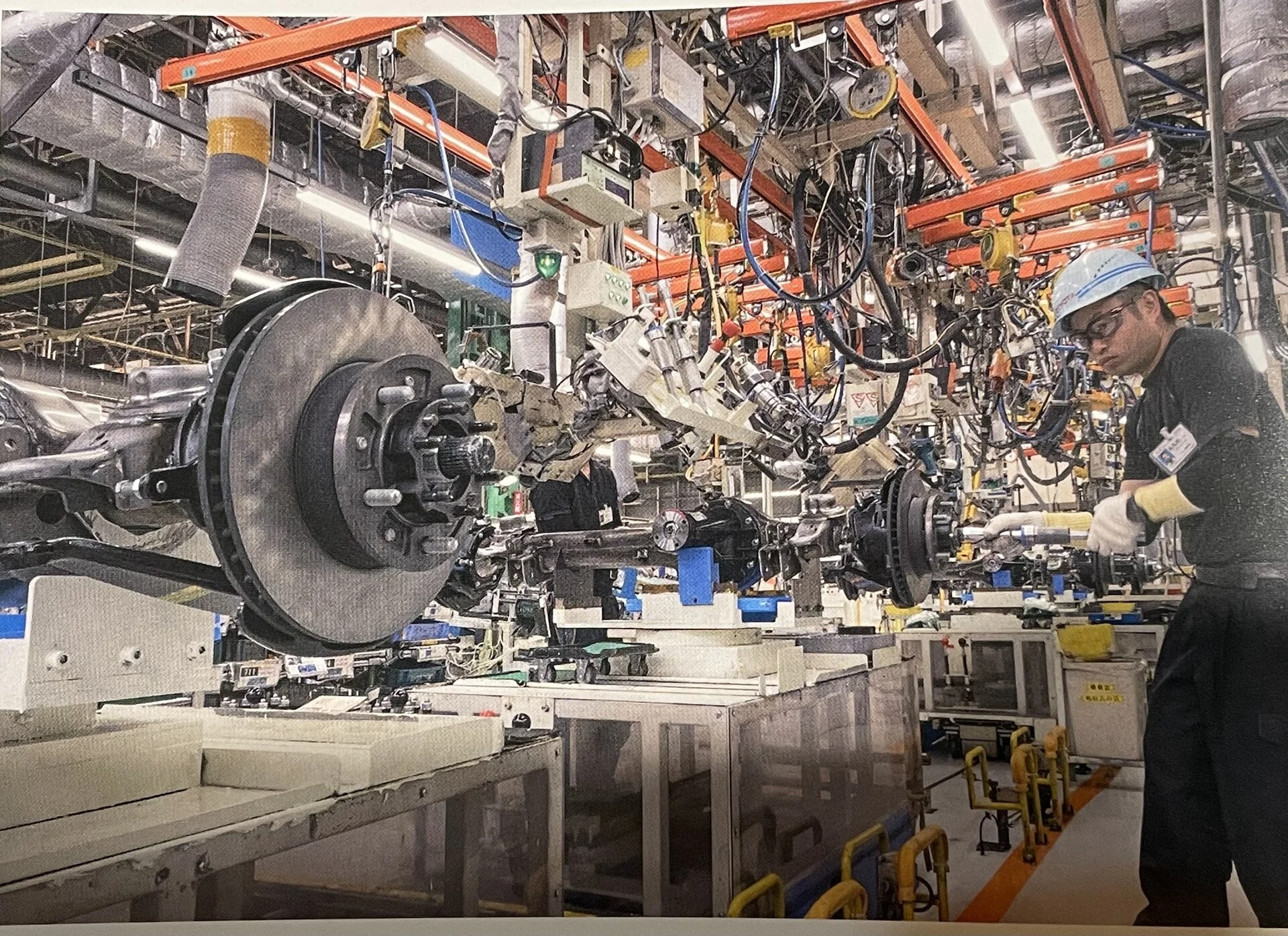

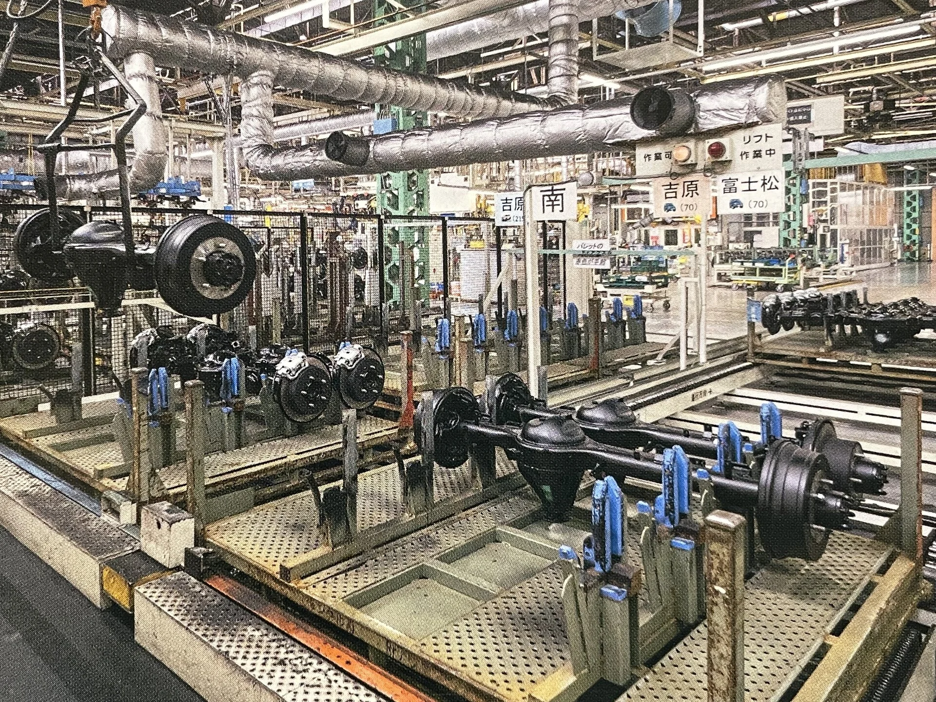

Who makes the Axles now? Toyota?
Reminds me of this Post:
Dana axles were only for certain markets (as Dan indicated due to local requirements for local parts used for vehicle assembly… These 70’s with Dana axles were installed into CKDs: complete knock-down kits — basically trucks in a crate assembled locally in given markets).
70 series axle housings are manufactured and assembled at the Toyota Motomachi Plant.
