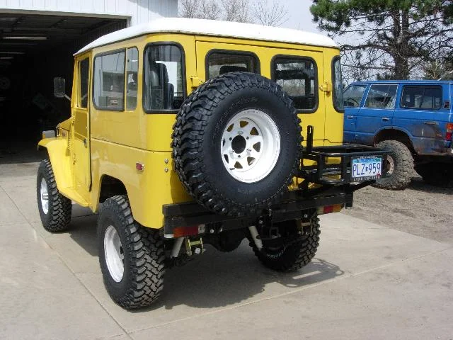

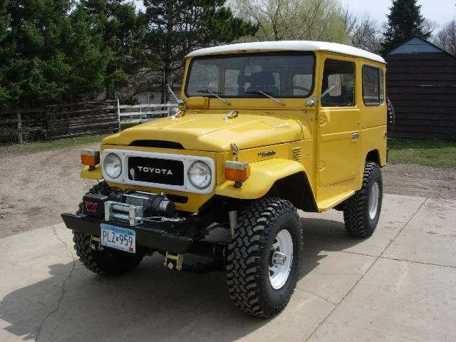

I do not agree that the brake lines do not need to be longer with a 4” lift and shackles.....
The 4” HFS lift springs and longer shackles were installed on this truck and the front and rear brake hoses to the axle were too short and replaced with new longer units.

Picture of the front hose that was way too short:

That truck looks great. Is the rear lower?
are those tires 33x10.5 or 33x11.5?

That low-mount 8K# Warn winch on the front was replaced with an 8274-50....
