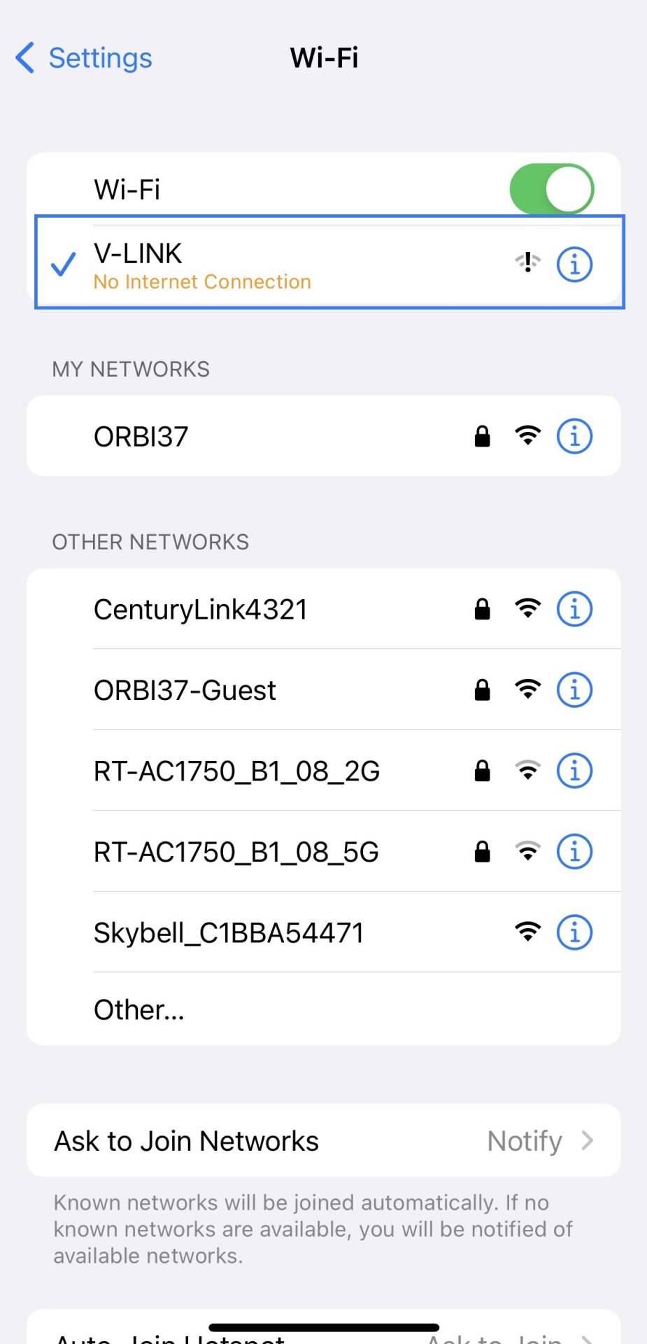

Reason I asked is my Tonwon dongle is using a “V-Link” wifi name and that’s what I connect to on my iPhone.

But this is what I see when I connect my iPhone to the Tonwon dongle wifi:

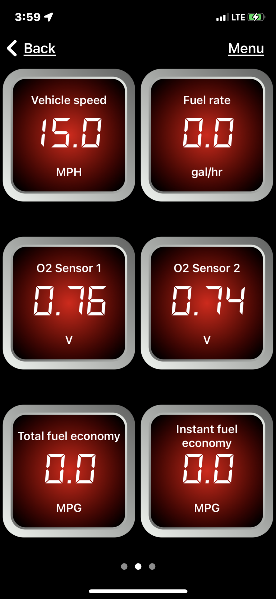

I didn’t start the engine, and this is what I get once I am connected to V-Link and have launched the OBD Fusion App.
