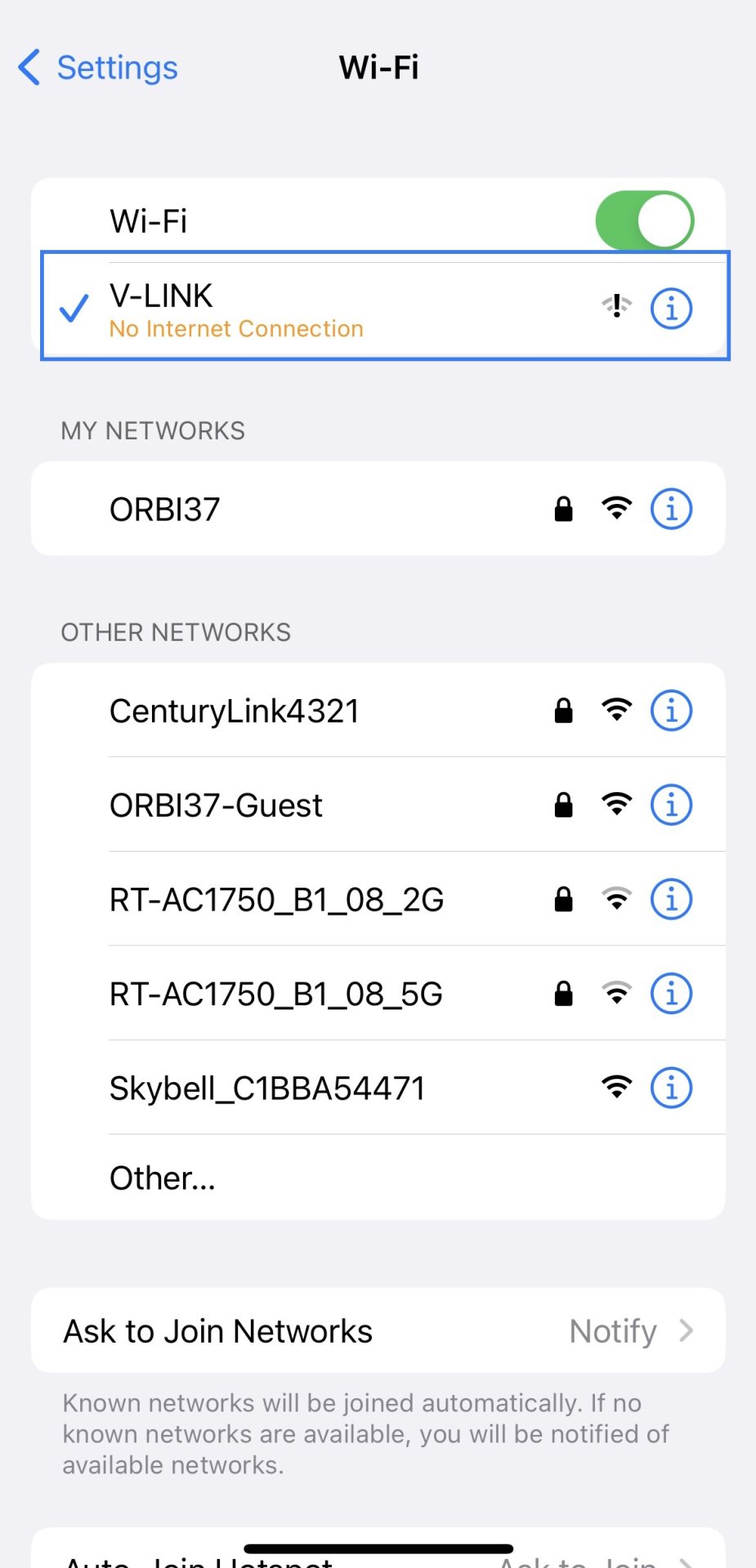

Still nothing and I feel like im taking crazy pills here.
Again, I can't comprehend how the Bluetooth dongle will emit a wifi signal to connect to if it doesn't have wifi capabilities...
With my VeePeak dongle you don’t pair using the iOS Bluetooth pairing. You pair it within OBD Fusion.
I have mine setup so it automatically connects to the module I want when I open the app on my LX iPad.

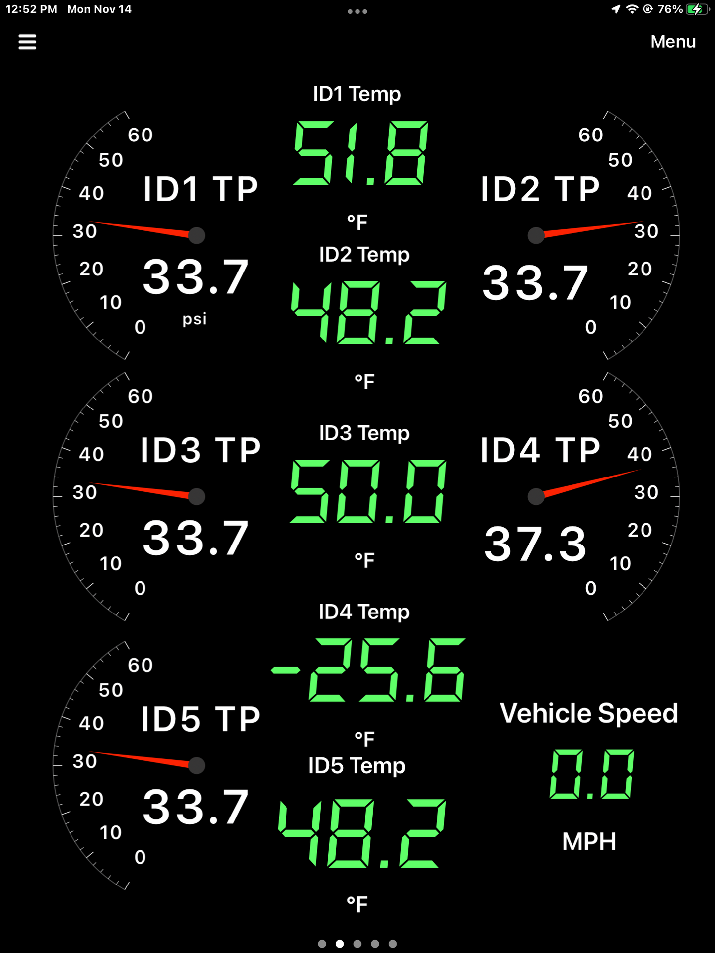

Has anyone figured out how to monitor tire pressure with OBD Fusion? We know the data is there, but I can’t find a PID using the app.

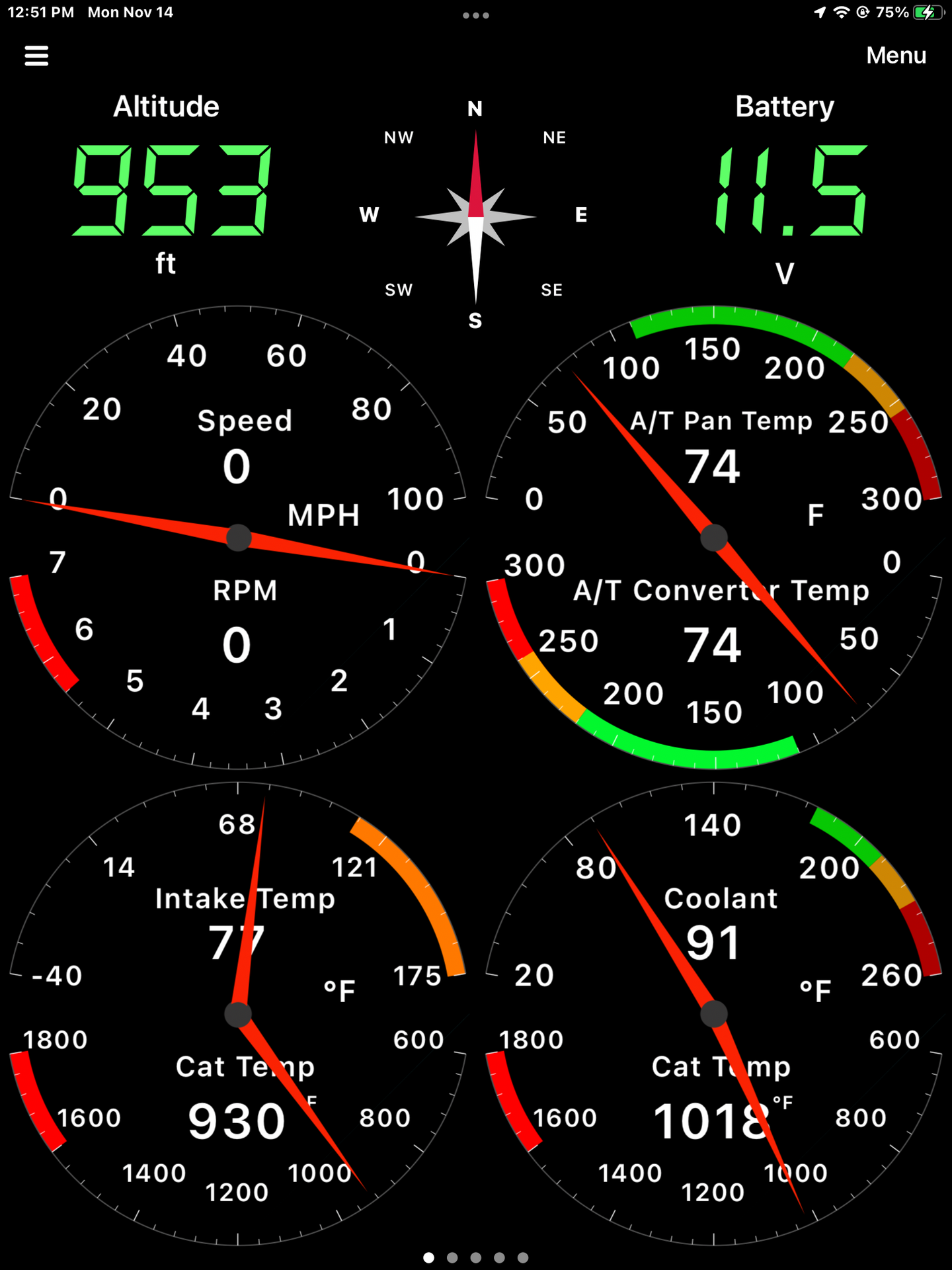

I have. Made dashboards for tire pressure and “engine stuff”.

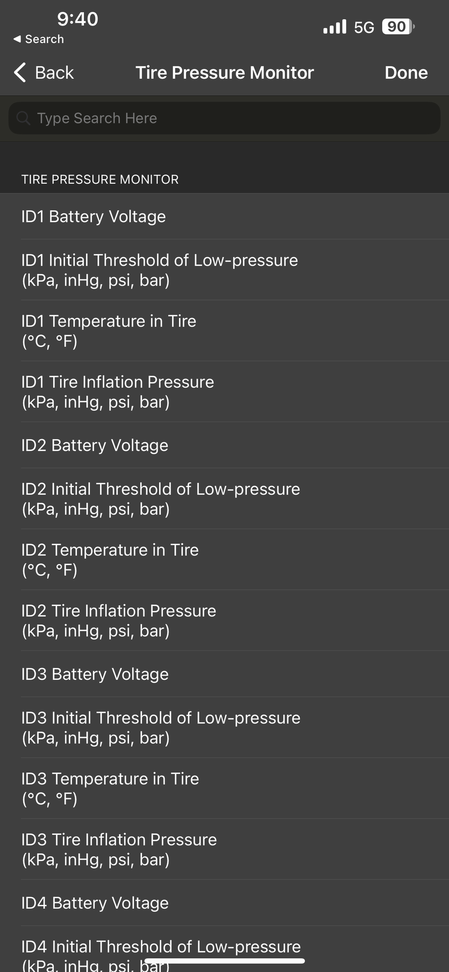

Nice. Mind sharing how you got tire pressure to show? I can’t find it in the choices.
Prerequisite:
You need to have the Toyota / Lexus / Scion add on pack for your year.
Steps:
1. Edit a display
2. Navigate to PID > Toyota, Lexus, Scion > Tire Pressure Monitor
3. Select the sensor to monitor: IDx Tire Inflation Pressure (x is the number of sensor, 1-5)

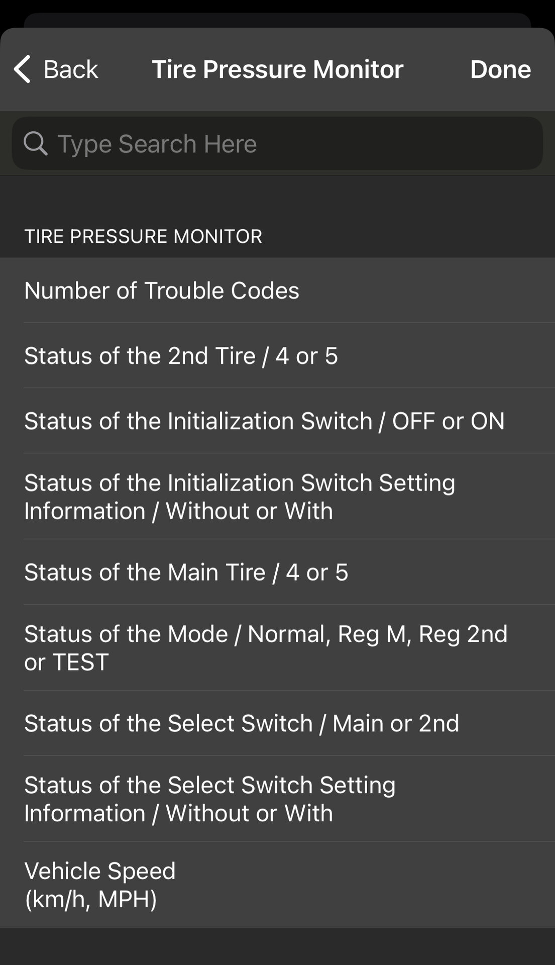

Unfortunately that’s not an option for my 2009, even with the add-on.
2009? Assuming you have a world market 100 series then?
Its my assumption that OBD Fusion is focused on US Market stuff. So you could try the add on pack for a 2007 to see if it picks up the PIDs. But since it costs money thats up to you.
My dashboards are for a 2007. I had to set up the transmission stuff manually with documented formulas. No set PIDs for those like others have shown for my truck.
