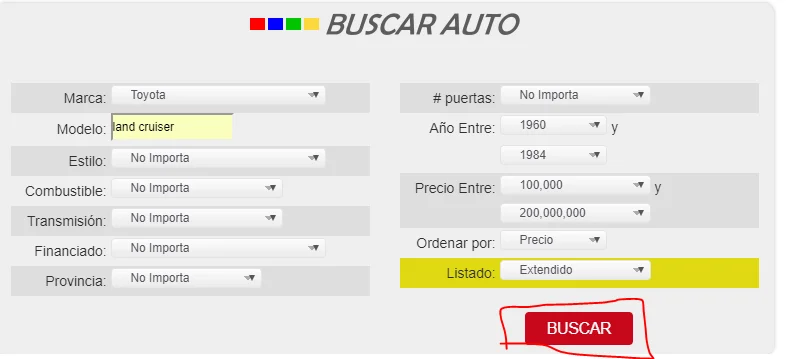

There are plenty of excellent BJ40s here in CR. If you find a cheap one (3000$ - 6000$) is because is not in good shape or it has some details.
You can go to crautos.com - Autos Usados Costa Rica encuentra24 horas al dÃa then scroll down to the bottom and set it like this:
You will find several ones here.
Keep in mind that there is nothing like seeing the car by your own.
