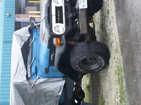

Went to the base hobby shop..they no longet do welding classes =( but there was a 40 sitting there outside. Belongs to a major...apparently its been there for nearly 3 years..he comes and does a little at a time.
The shop will do your welding, at $20 /30 minutes..you bring the metal already cut. If you know how to weld , you can rent the welding equipment for around $10 an hour.
Heres the 40 we saw. It was raining and there was not a place on that toyota dry for me to leave a card.
