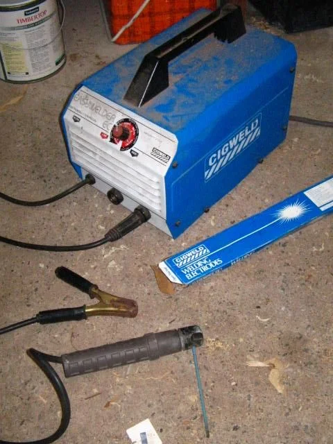

um yeh my terminoligy isnt great but its a stick welder i think, its got a long blue electrode thing which melts into existing metal. (yeh im a real rookie)

its an AC machine running 240 V, the electrodes ive got have an amp range of 95 to 125, box says there good for mild steel wanna know anything else?
ac machine= not so good, but wil get the job done.
240v=good.
what kind of rods are they?
can say i've ever seen blue rods, but there they are. there should be a number on the rod themselves that same number should be on the box.
read the box, make sure those are AC rods.
they are cigweld rods aussie stuff, the box says they do both ac and dc, are you talkin bout the classification number? cos its E4113. whats the positives of DC over AC?
smoother, more controled arc.
i'm afraid the numbers they us over down, there are not going to jive with numbers i'm accustom to dealing with.
a quick goggle seach just proved that.
http://209.85.165.104/search?q=cach...Electrodes.pdf+e4113&hl=en&ct=clnk&cd=9&gl=us
your 4113 is our 6013.
an 1/8" rod should run around 90 amps.
it will lay a strong bead, though it will not have the smooth look most people think of when talking abuot welding. you may have to run two pass in order to build the bead up enough to sand it smooth, for a clean looking bumper.
