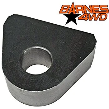

Here is Barnes 4wd weld -on clevis. It has the shape I was looking for. I will get 2 or 3 and have them welded onto my rear bumper. I will send pictures of my rear bumper . No spare tire carrier. Will just keep it inside, secured to 3rd row seat brace. SMR welding on 2nd just south of Osuna. Juan does good Fab work and reasonable prices.

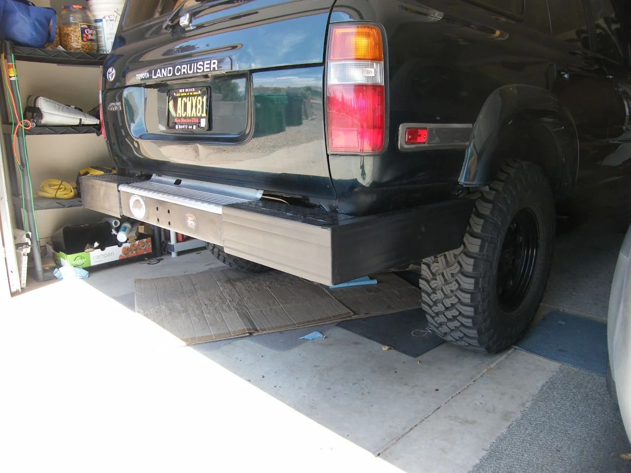

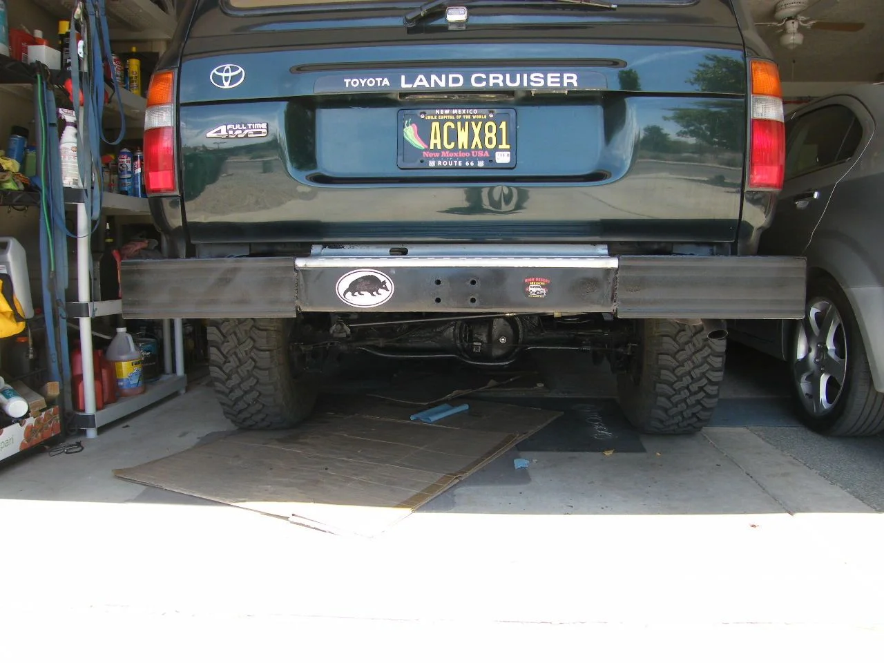

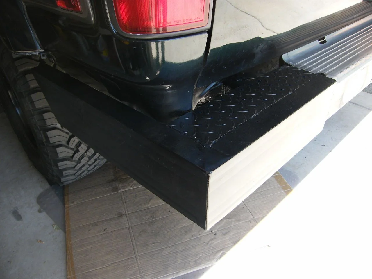

Here are a few pictures of my rear bumper.
Better than the plastic stock corners that were held on only by zip ties, from previous owner. All the stock attachments were rusted out.
nice, 80's are big pigs... think hard about your load path if you had to use the welded ones...
Do you mean about where to weld the clevis mounts? I thought about that. I would have them welded on an area where there was placed a brace behind the welded on bumper. This brace is welded to the main frame, in a corner. I believe this to be the strongest part. I will have the guy who built this for me, determine if this is the strongest place. If he thinks even more strength is needed, I will have him beef it up. I don't want my rear bumper recovered, but the rest of the 80 still stationary. Ugh!

Would a third clevis , in the middle , where the 4 bolt holes are, be another good weld point? I really like having the hitch mount off. Much better departure angle. But would like 3 recovery points along the back, idealy. 2 would be OK.
Yeah, you got what I meant. the center crossmember is relatively beefy IIRC when I cut mine out for the 4x4labs. I'd aim to get the two clevis points as close to the intersection of the frame rails and the bumper as you can. You could get around no center point with your rigging I'd imagine.
To be fair, I'm likely not one of the guys who should be talking about best recovery points and strategery... we have others...
I like connections that are in line with the frame rail rather than the cross member, and I like to have the choice to pull from left or right, depending on how crappy of a place I manage to get into.
That said, the factory reinforcement to the hitch mount is pretty substantial on almost all land cruisers.
The junction of the rear of the frame rails on both sides of this rear bumper is where I plan to get the clevis mounts welded.
That seems to be the strongest place back there. I will tackle this after I get the clevis mounts in. Having a 3rd clevis in the middle, might be an option, also. Haven't decided on that yet.
