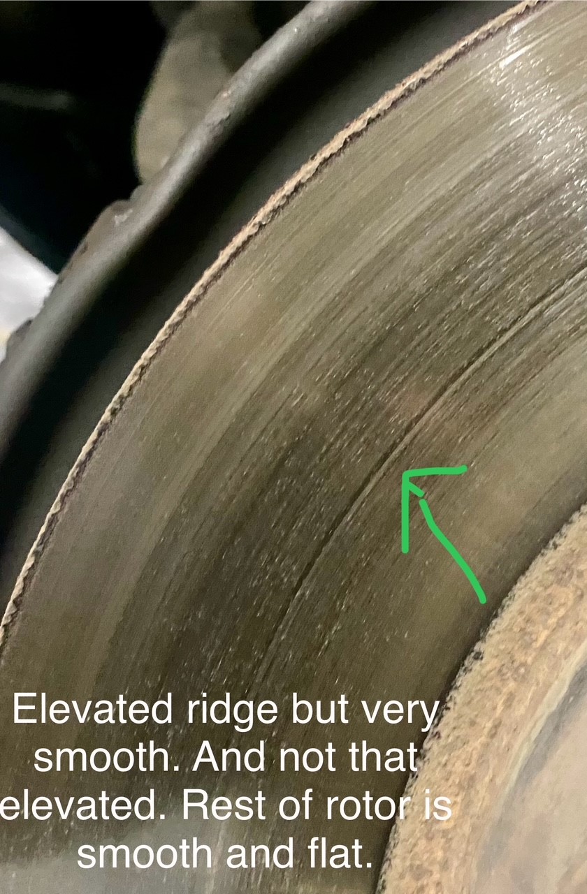

Opened brakes up on the side where the issue intermittently comes (driver side front) as well as the passenger side (front). Toyota when they said it was pretty clean, that definitely wasn't true. Very dusty. But brake pads and rotors overall were pretty good (in that sense Toyota was right). Even wear on both pads on both sides in the front. And lots of life left. Almost 10mm. So mobile mechanic and I cleaned the entire area with brush, greased up shims and proper areas of brake pad corners etc, as well as the caliper pins. Calipers seemed to be working fine, being able to go in and out when we tested. No rips on their boots. So let's see. For two days no noise has come while driving but i won't feel relieved until a week or so goes by with no noise returning. Because last week it began on a Saturday and disappeared for like 4 days or so with 2 different long drives only to come back again on the 4th day or so. So hopefully now just stays away. Otherwise will have to inspect again and perhaps just go and replace calipers, and rotos and maybe pads even though pads and rotors look very good and rotors were smooth with no grooves or lines on them.
Issue came back again 5 days later haha on my 1999 LX470 ...same scraping noise per video above. And when put in reverse and hit brake one time and then back to D and brake noise is all gone. Oh and i have no wobble in steering wheel, i take off my hands off wheel even when braking and car does not pull. Have brand new control arms lower and uppers (Toyota) in front since Jan. Have new rear ones also and pan hard bar but haven't had time yet to do rear. Car drives very smooth even with 300k miles and with AHC. Brake power is pretty good. Nothing has acted up except this stupid noise that comes every few days or like a third or fourth drive. Always after about 1 hour of driving....
Debating now do we machine original toyota rotors and throw new pads on it again... though current bosche front pads have 10mm left on them and toyota and lexus and mobile mechanic found them to be fine and also found rotor to be fine. Now to me, Rotors feel fine, smooth with exception of one smooth elevated grove that goes across the circle pattern of rotor. See attached picture. It is very smooth and elevated. So to me if a loud scraping noise per video above would probably cause more damage than this very smooth elevated bump in the middle of rotor, no? The top of rotor is not a ridge though may seem like one in pictures. But it is like chipping away up there. This is on driver side that scraping and screeching noise that intermittently comes. Noise often comes only when stuck in traffic bumper to bumper BUT again goes away after the reverse trick. And i am in that traffic maybe for like 10-20 minutes only. If overheating...on flat road, odd that noise goes away with this reverse brake and then back to D and brake actions.
