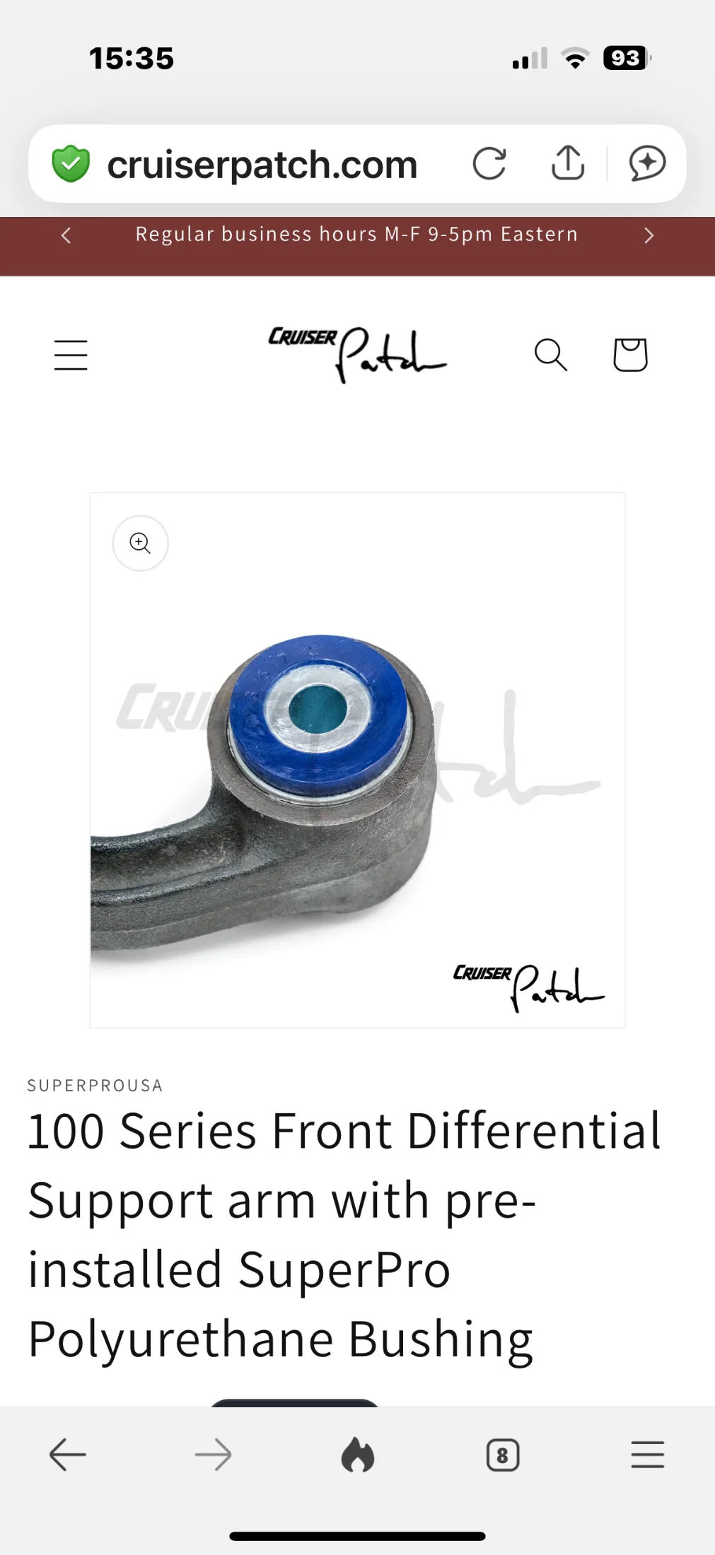

Could be a few things. Excessive lash in one or more diffs, transfer case, or u joints. (Spider joints) also the front diff support is known to cause this clunk. See photo from cruiserpatch.

Could be a few things. Excessive lash in one or more diffs, transfer case, or u joints. (Spider joints) also the front diff support is known to cause this clunk. See photo from cruiserpatch. View attachment 3981396
The transfer case is in great conditions, however I need to check the front diff support.
Thanks.
