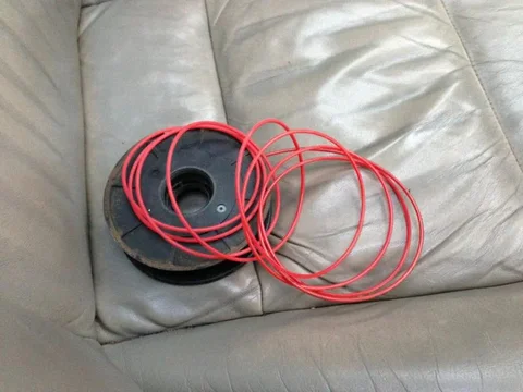

Four; one in each corner. The two front are easy to spot with sunroof open. The two in the rear are difficult to see without dropping the headliner. Use the trimmer string method to clean them out.

Thank you everyone for the help but if I may ask, what is the trimmer sting method? I've seen it mentioned but never explained.

Tried the trimmer cord and a thin wire but both get stuck and won't go further. Any other ideas?
How much line did you have in the drains? I guess I had 4' in there, maybe 5', and then it stops. You may also have a kink, start with removing the kick panel.
After running the trimmer string thru my front drains I poured water in there to test. Poured right out. Have you tested them? Would try that before removing panels.

Tried from inside sunroof with trimmer cord and some wire on each side. Both only go in about 3 feet and stop. I will try pouring water when I can see (it's gotten dark) I was thinking we would see water stuck pour out or be able to stick cord in till it came out of bottom. I will let you know. Thank you for responding.

I just checked with person helping me and one side may have been 3' but other side probably wasn't past 6".
Only 6"? That is not nearly far enough. That would mean you were still in the headliner. I wonder if anyone has run them backward; up from the drain outlet in the wheel well? Don't know why it wouldn't work. You may want to attempt that before you pull panels.

Well, I didn't test to see if floor was damp before hand but poured some water down holes and both sides drained although drivers side didn't seem to drain as much and floor was a little damp. We shall see. Thanks for the help.

It appears to be draining right. One side doesn't appear to be as much as goes in but windshield hasn't been fogging up. I may try again to see if I can get past 6". Thanks for the help!
Mine wasn't sunroof. It was the rear cargo window trim gaskets and the third brake light gaskets. Fixed those issues, no more damp cargo area and it has been raining alot since i fixed it.
