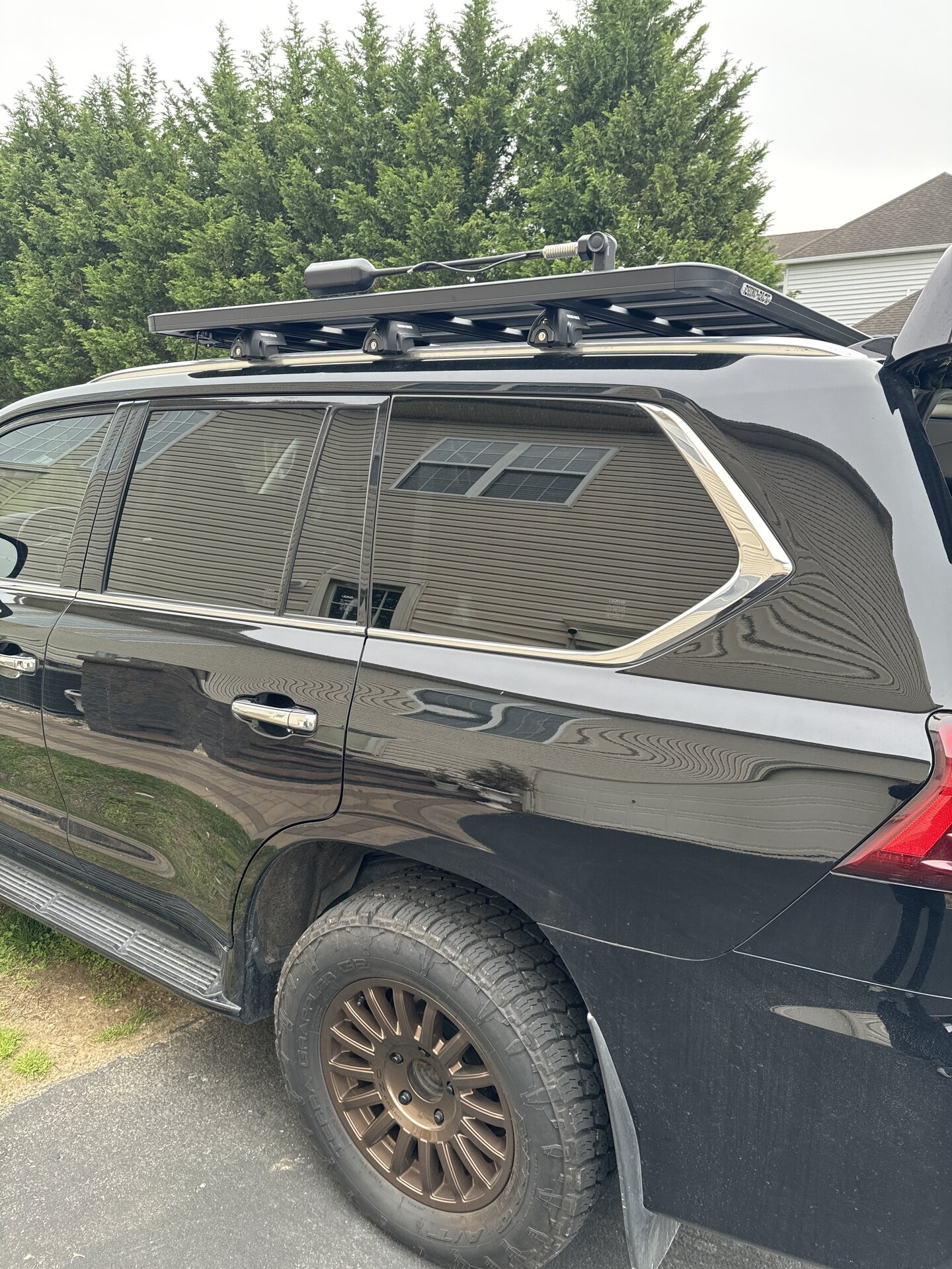

I tucked the main unit between the interior panel and base of the driver side third row seat. It’s pretty tucked away and does not interfere with the third row seat.
I ran the antenna cable from the outside of the tailgate to the roof. Eventually I’m gonna reroute the antenna cable out thru the hatch grommet.
I ran power from the battery through the driver side grommet, then down the floor/door sill channel, under the second row “step” near the outer base of the seat and tucked the wire under the interior panel next to the third row seat.

I did need a 1 meter extension for the antenna wire. I put the antenna on the hatch.
