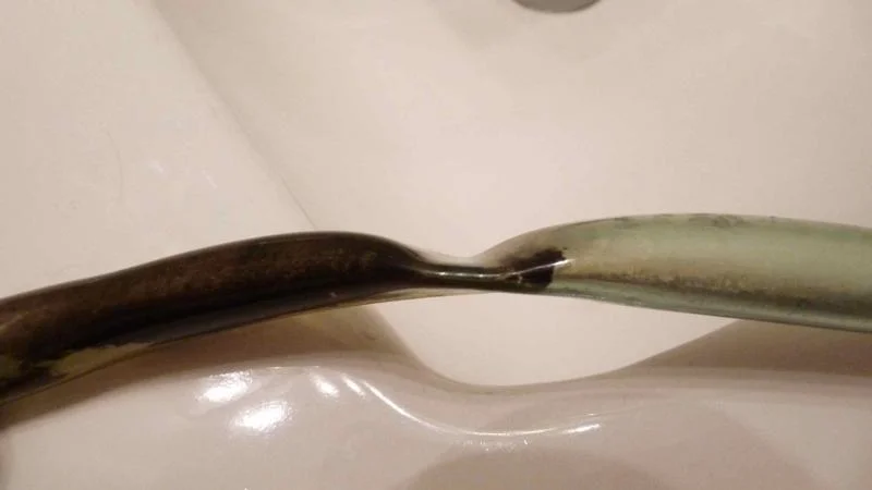

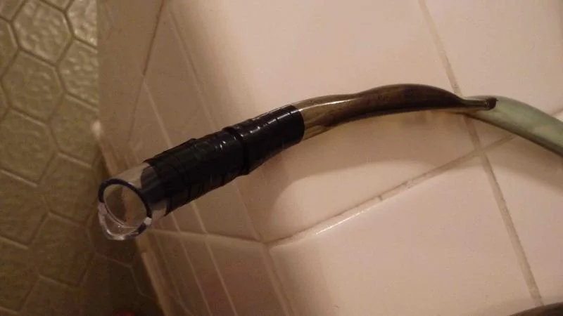

So thank you all for your responses.
First thing this morning bought some 18 guage wire and tried to feed wire down drivers side sunroof drain channel. Wire would only travel about four inches, so I abandoned this in case of puncturing the pipe.
Next I blew compressed air into the sunroof drain hole, again to no avail.
So I Found a great independent in Atlanta, Toyo Techs, they do a lot on Land Cruisers.
The culprit was a pinched drainage pipe. About four inches down from where it attaches to the sunroof nipple, see picture below.
The pinch would allow normal rain water to flow through, but any more and it was backing up and running down the inside of the interior trim, and then down over the electrics to the floorwell. Must have been installed that way in the factory, and due to lack of deluvian downpours like the one last night in Atlanta, went unnoticed.
All fixed with the aid of a trip to Lowes for 10' of 5/8" clear plastic pipe.
