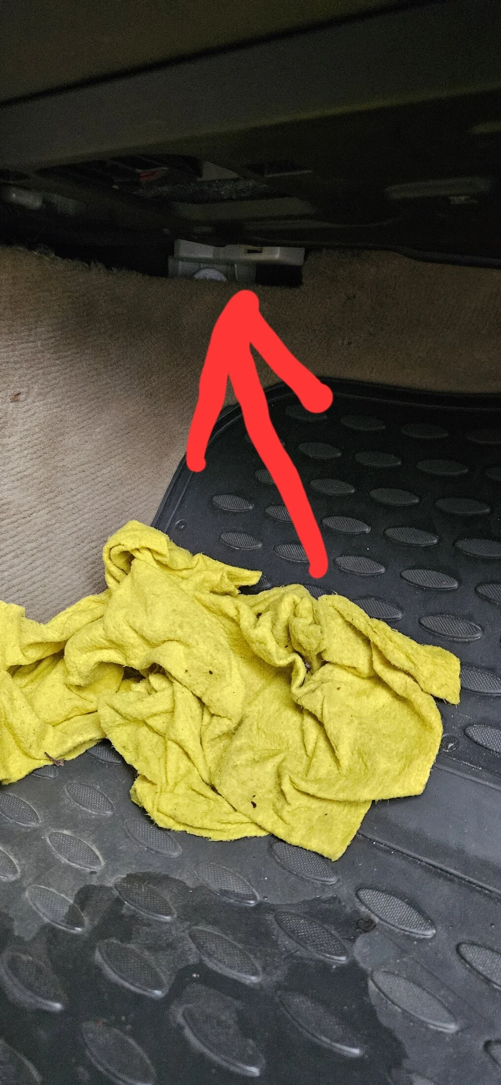

Hello all,
I got some water dripping on the passenger side down on the floor mat after starting the engine, not much but I’m worried a bit. After start driving there are no more leaks. Looks like is pushed by the fan once the engine starts. Anyone has encountered this, and what can be the cause? Car is parked outside..
Thanks a lot!
Water is most likely leaking at the base of the windshield into the aircon fresh air inlet.
There is a lot on this if you search, including a thread from less than a day ago.
“Cowl leak” is probably the term you want to investigate.
