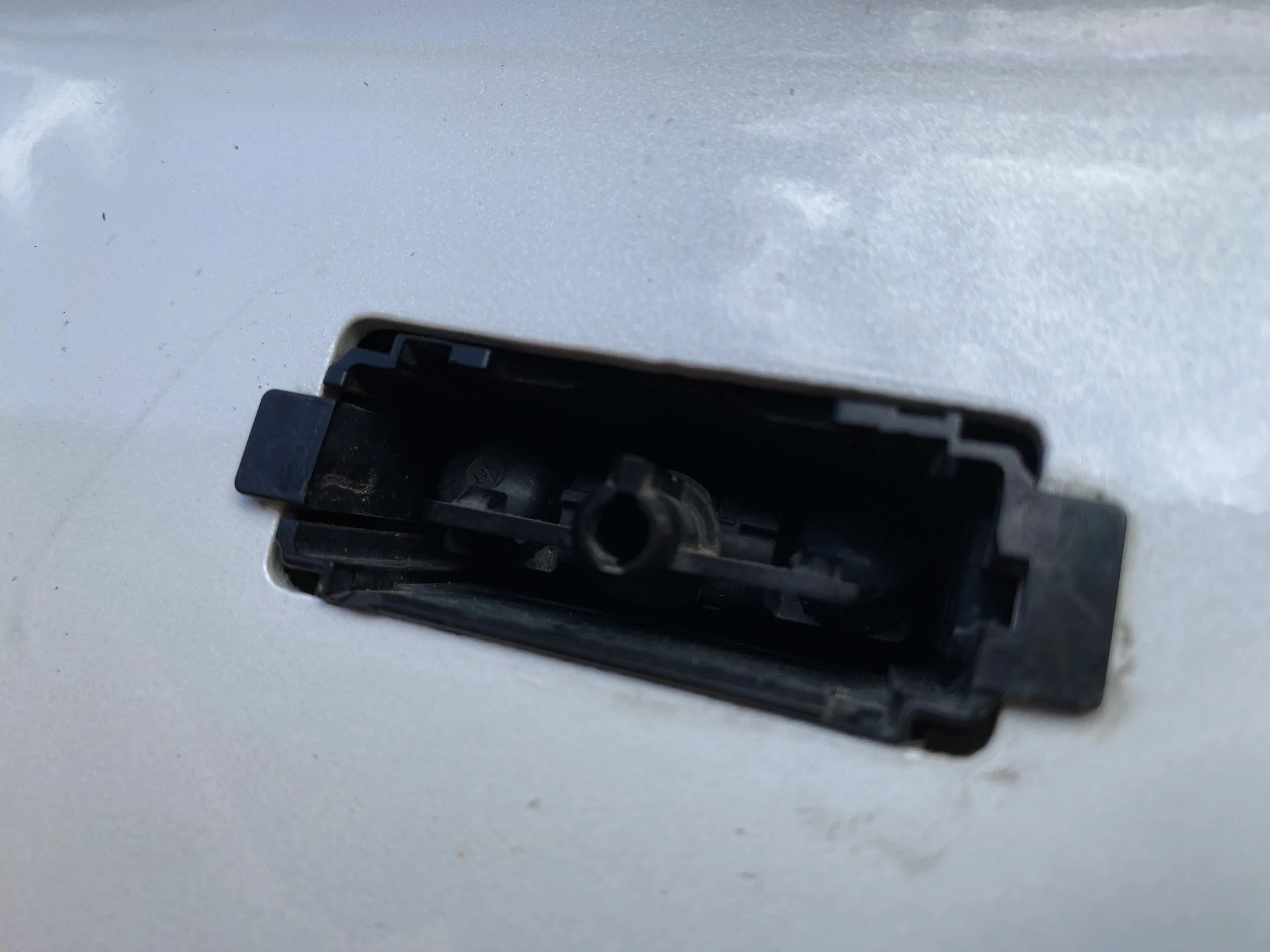

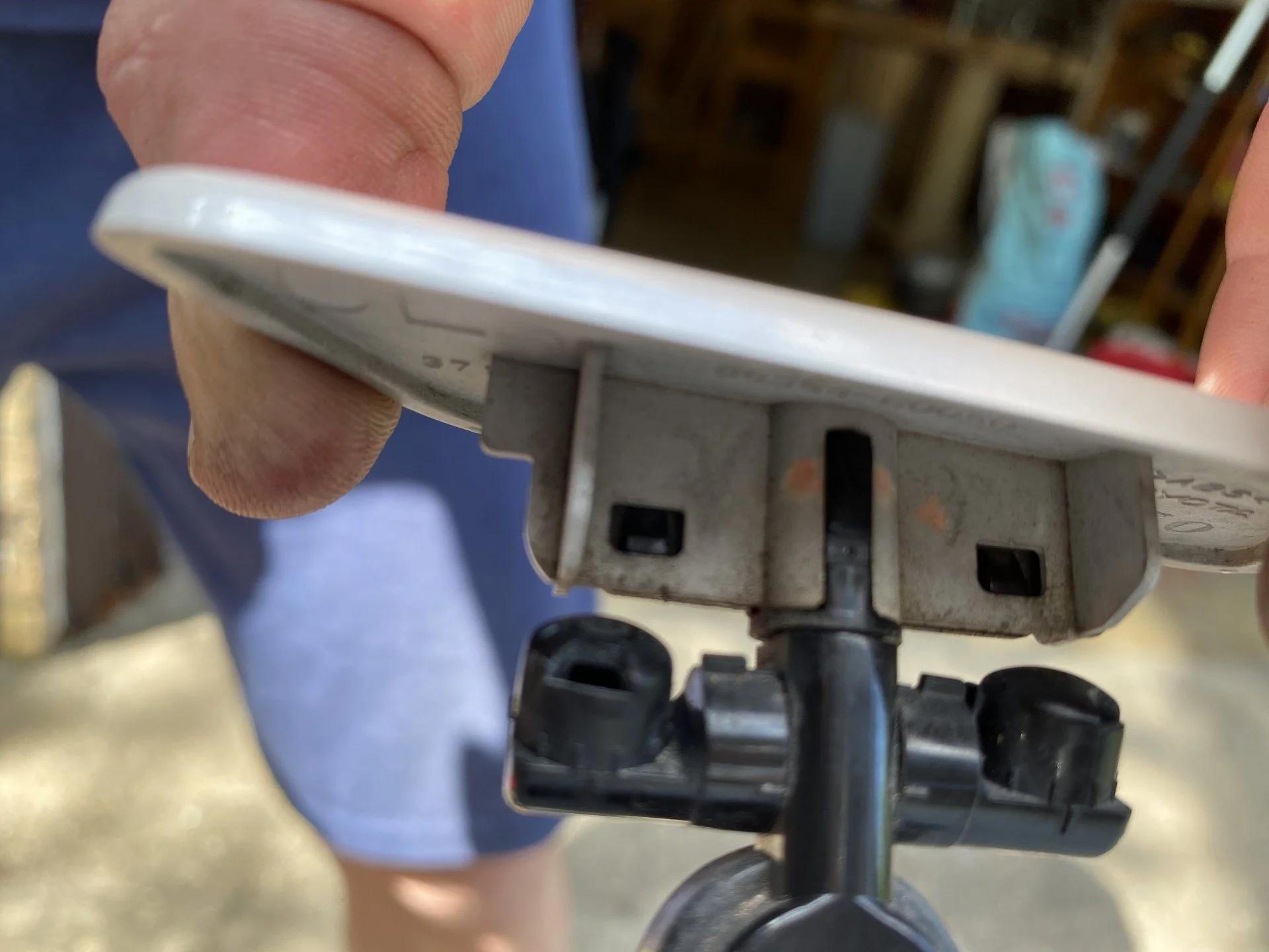

Turns out you don't need to remove the front bumper.. But first, you need to remove the body-color cover over the top of the sprayer. Use your fingernails or a plastic pry tool and lift it up, then grab it by the black nozzle part and you'll see the tabs that hold the cover on.
By carefully bending the top away from the headlight and manipulating those catches the top will lift right off.

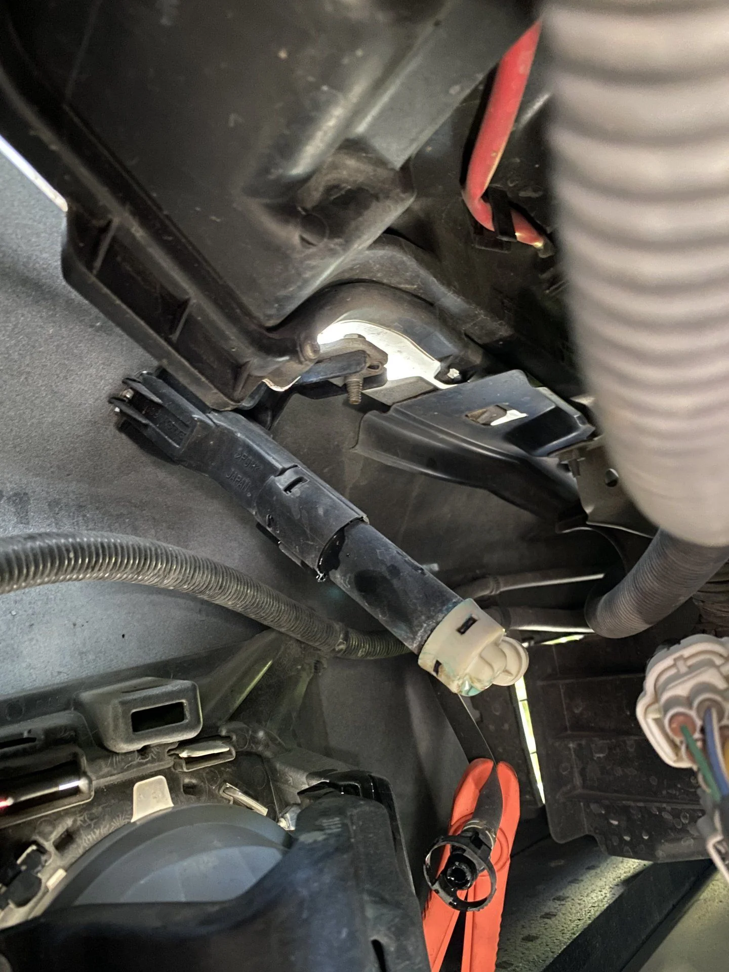

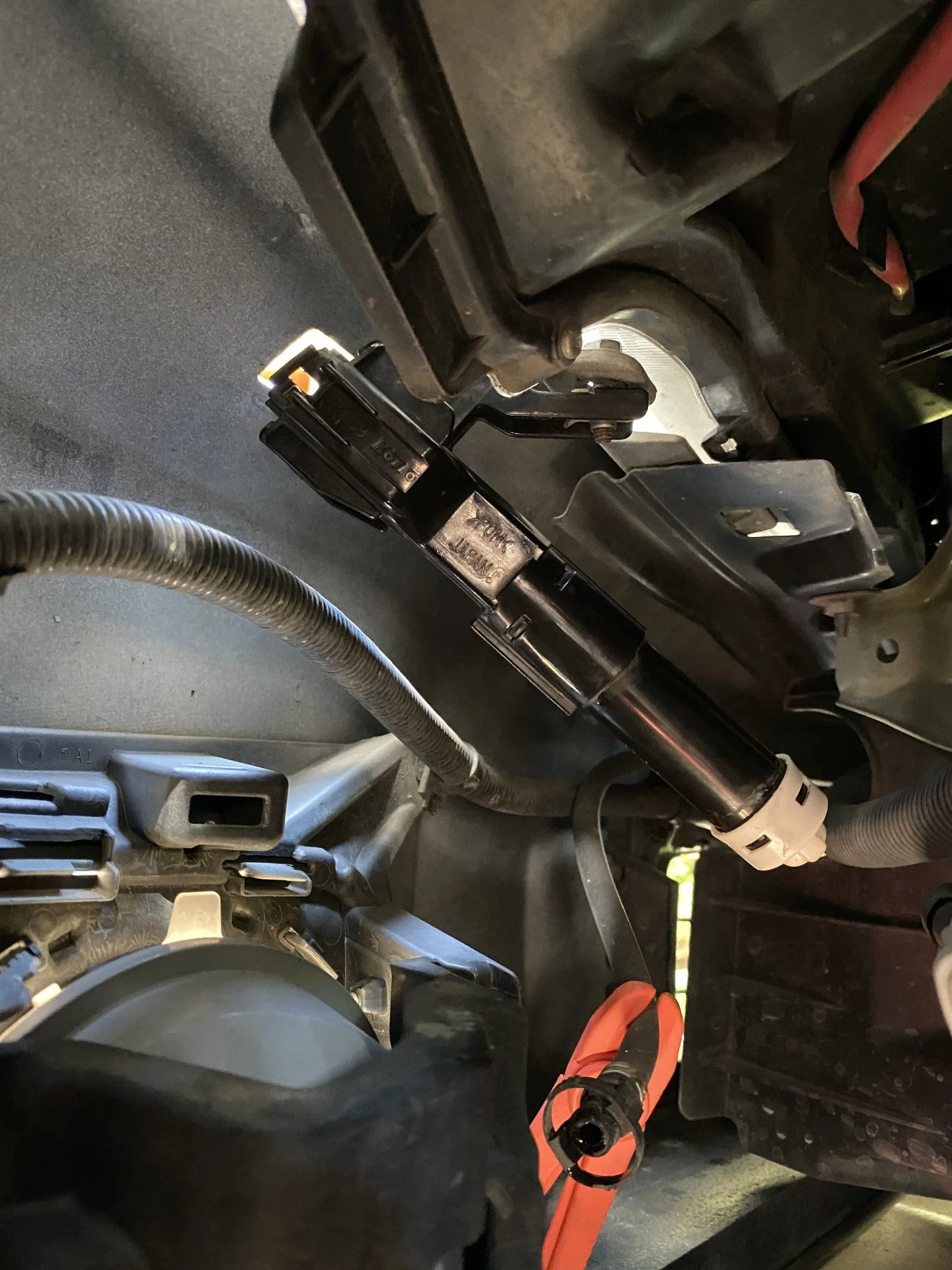

Then to access from the back. Remove the plastic upper skid plate wing on that side, loosen the torx screws and plastic pop up rivets that hold the fender liner in the front half of the fender. Then you can get in (at least on the DS.. my PS has a box over the fog light that might get in the way) and are faced with this.
The black/gray cylinder with white tip is the back side of the sprayer assembly. I've already pinched off and removed the line. Just squeeze the wide parts of the oval retainer and it will pull off. If your washer fluid isn't empty or you don't pinch off this line, you'll have a steady stream of washer fluid running out. Find a way to catch it without contaminating, or just pinch the line. It is soft rubber.
You can also see the 10mm bolt on the top providing support. You can get to this with an open end wrench with the handle pointed toward the radiator.. the shorter the wrench the better. Just get it loose then you can pinch the lower part of the bolt and rotate it most of the way out. But, before you finish, you need to loosen the tab on the outside of the bumper.
The right side here is static, but the left side can be pulled inward and the whole nozzle rotated inward behind the bumper.

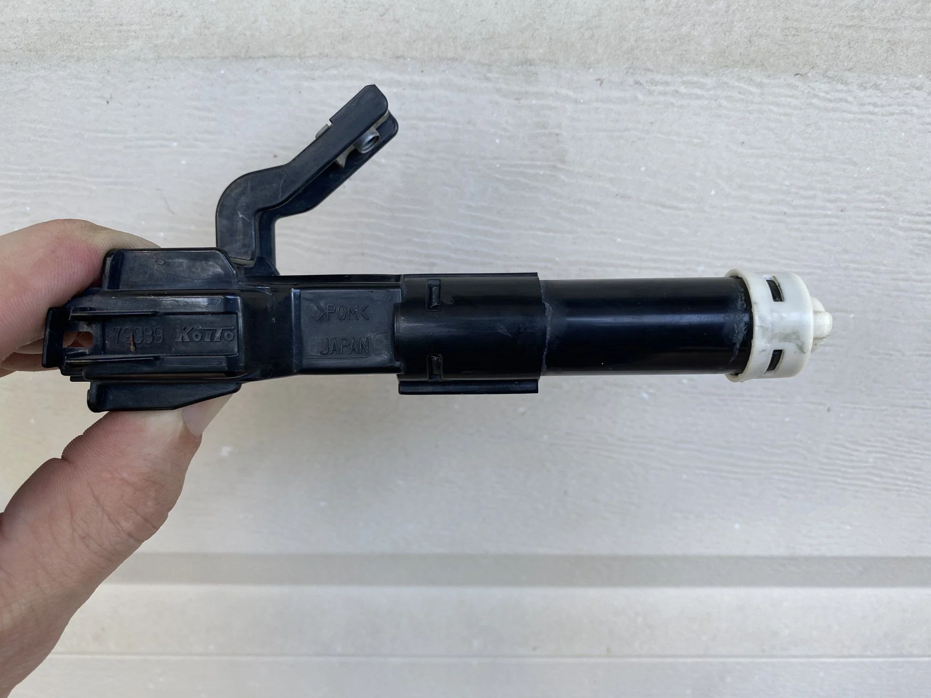

Get that bolt out and the nozzle on the bench.

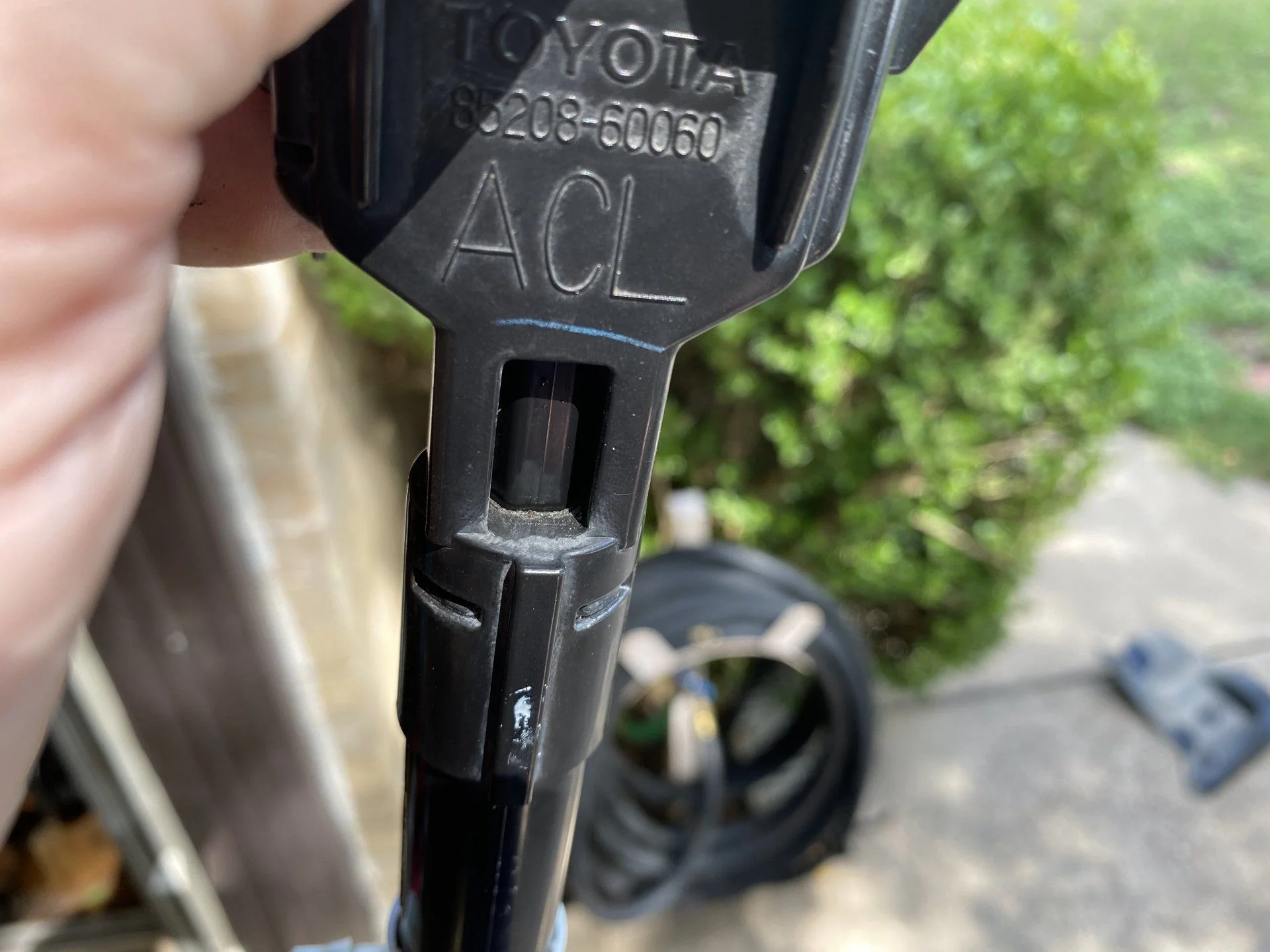

Whole nozzle (~$200 per side)
Evidence of the leak

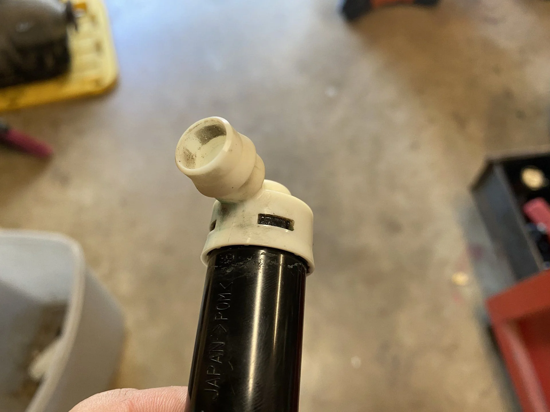

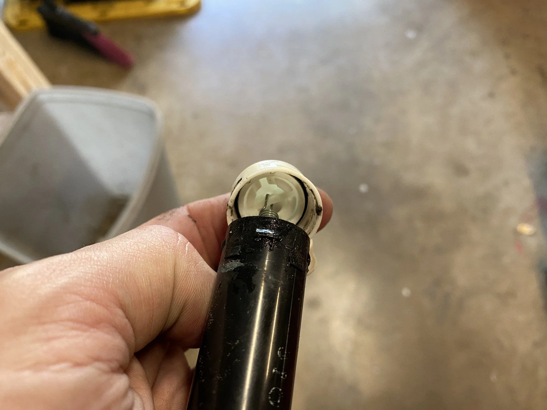

Also you can see the four tabs that anchor the white end cap to the assembly.
So those four tabs make it convenient to get the white end off. Just rotate the end 45 degrees and the tabs will slide sideways out of their slots, and you can pull the white end off.
Before
After:

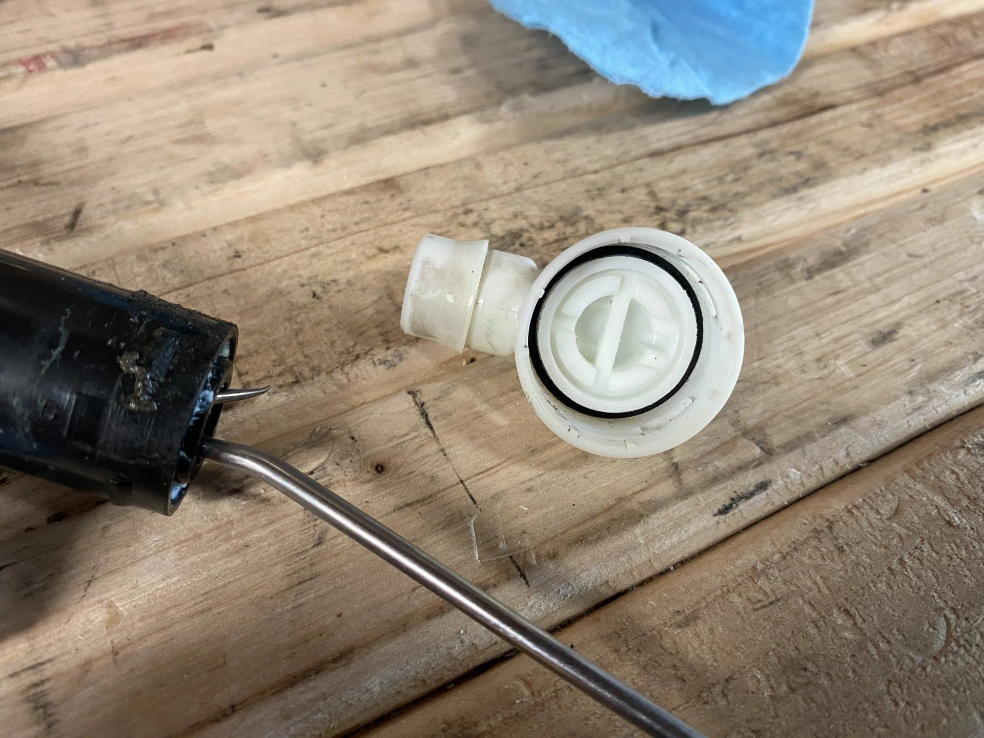

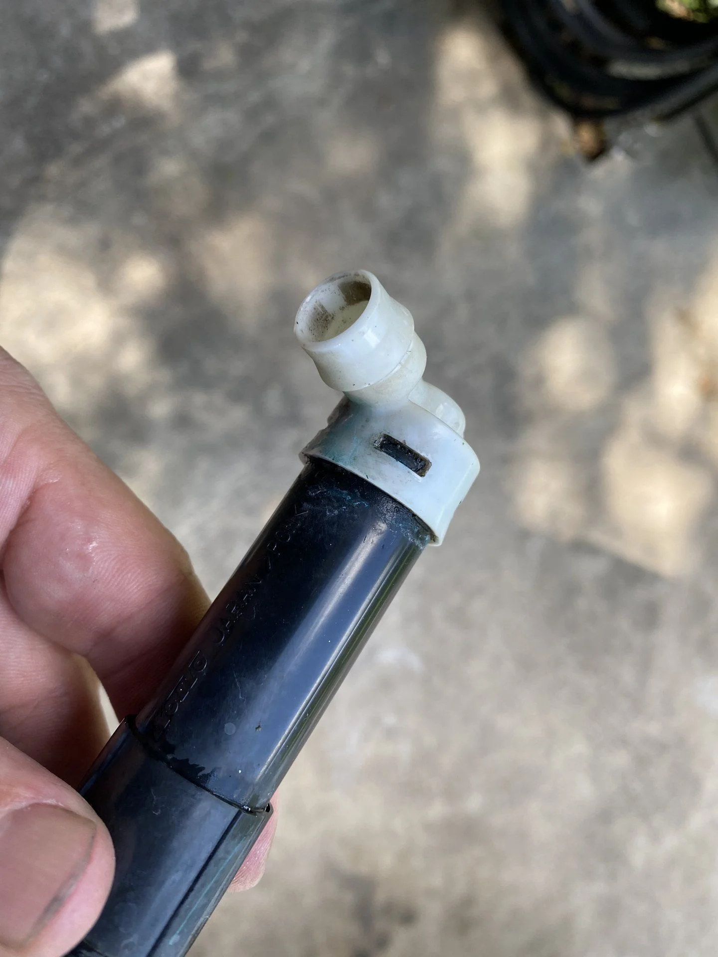

The spring anchored into the white cap is what retracts the sprayer nozzle when it isn't being used. Get an o-ring pick and catch the spring so it doesn't retract into the assembly. Also in this picture you can see the oring that seemed to be leaking on mine
That black oring was mashed flat for me. Looks like nominal dimensions were 20mm ID x 23mm OD, 1.5mm cross section. Unsure of material.. but it's just washer fluid, shouldn't need viton or anything crazy.
Not having a spare o-ring, I elected to clean it up and use some very thick silicon grease I have around.
If you want more room to grease the piston seal for the washer sprayer shaft you can cut a small chunk of metal to hold the spring and remove your pick
Now you are looking at the end of a piston and seal that slides inside that cylinder and uses the pressure of the washer fluid from the pump to protrude the sprayer.
IF that is leaking too, it can get past this then to the shaft seal further up.
Shaft seal is inside the little window
My leak seemed to be coming from the white cap at the bottom, though if you pulled on the sprayer and pushed any direction fluid would start leaking at the shaft seal too. I think in normal operation the shaft seal is just to keep dirt and crud out.. the white cap and piston seal do all the work to keep the fluid inside the unit. And on mine, I think I got it done.

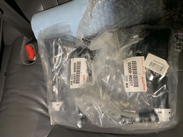

If anyone need their fixed. I ordered these arms on Amazon for $43 each and they’re actual Toyota parts. Shipped out from Rosemead, CA. Surprised there.
Amazon product ASIN B07VGS1V8M
Great work digging this up!
Once they are in please post that they worked as confirmation. I didn’t dig up the OE part numbers but those seem to have a different hose inlet. But if the rest fits still a good find.

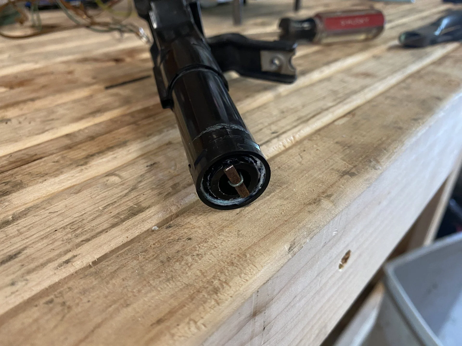

I have my DS nozzle out and on the bench, cap is off. Your instructions were very helful! The only thing I will add is I removed the DS front wheel to get access for pulling down the fender liner. What kind of grease did you use? I have Sil-Glyde, and I also have a very waterproof, very thick Green Grease. I may just go with some RTV, just to be sure it seals, this thing is not fun to get out.

Thanks. I went ahead with using RTV, after some thought. What I did was pull the plunger up and stuck a finish nail across to keep it extended an inch or so. Then I *very carefull* put a schmear of RTV down in that groove where the O-ring sits, using a cotton swab. Put it all together, and I'm gonna let it sit overnight like that to make sure the RTV is cured, then put it all back together. If it's still leaking, I'll just get a new one.
