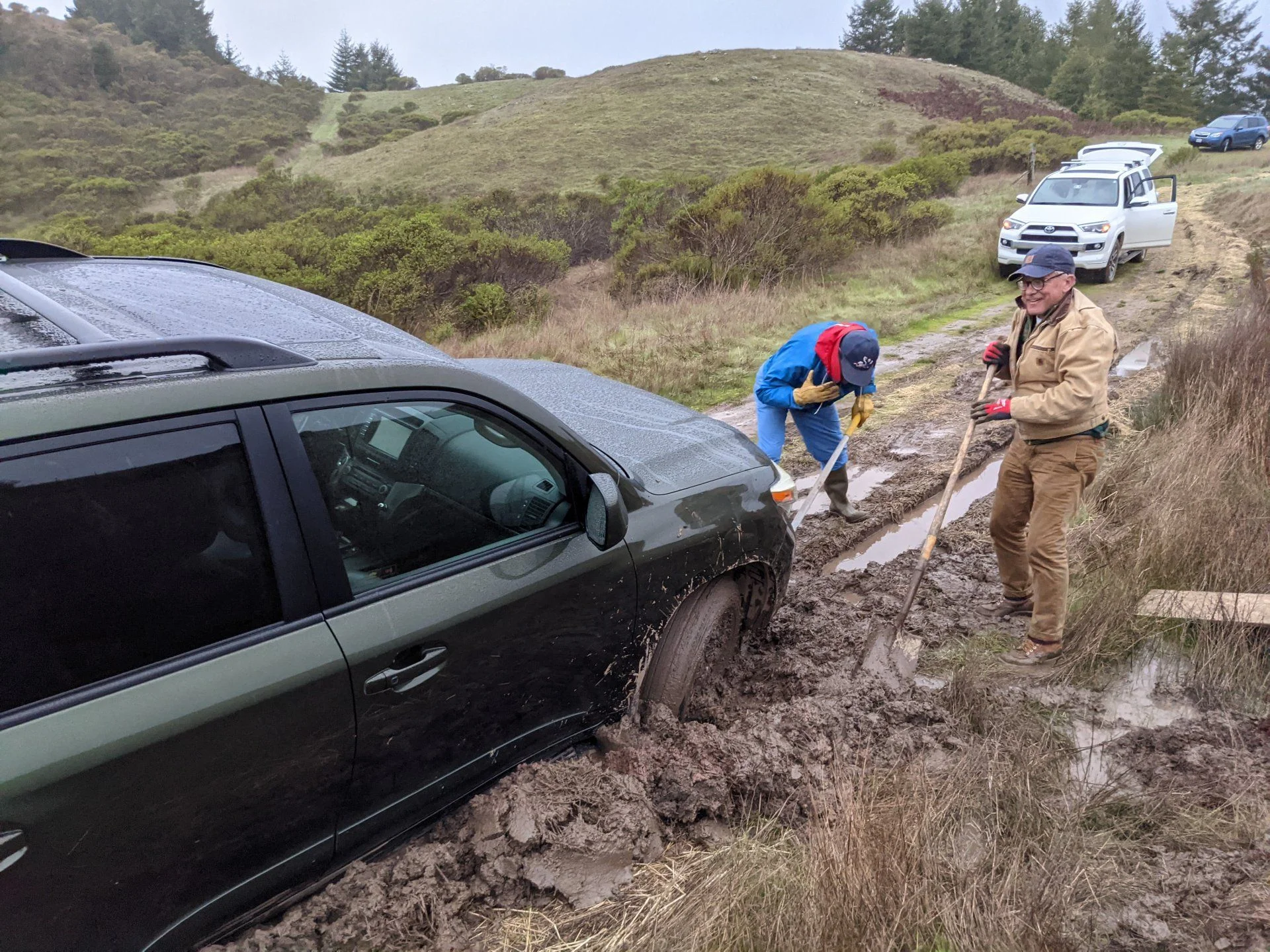

Last weekend I drove on the soft shoulder of a farm road and ended up getting stuck in the mud. The two passenger side wheels got buried up to the top of the hubs, while the two left were still okay on the hard pack. (Why locking the diffs didn't let the two good tires pull me out I can't figure)
After getting winched out and home, I pressure washed about twenty pounds of mud off the skidplates and from inside the wheels, wheel arches, and around the brake calipers. But now there's a slight sqeal when I drive at low speeds. I'm guessing I've got some mud/grit in the calipers. Will this resolve itself, or do I need to take the wheels off and clean out the brakes?

I absolutely love the smile on the older gentleman’s face. Seems like a really nice man.
That is buried enough that even axle diff locks might not get you out. They are awesome but do still have traction limits, especially without mud terrains.

That is a fantastic picture. As everyone else said pop the wheels and hose it down. Garden hose will work you don't need the full blast from a pressure washer. Great picture still looks like a good day.
