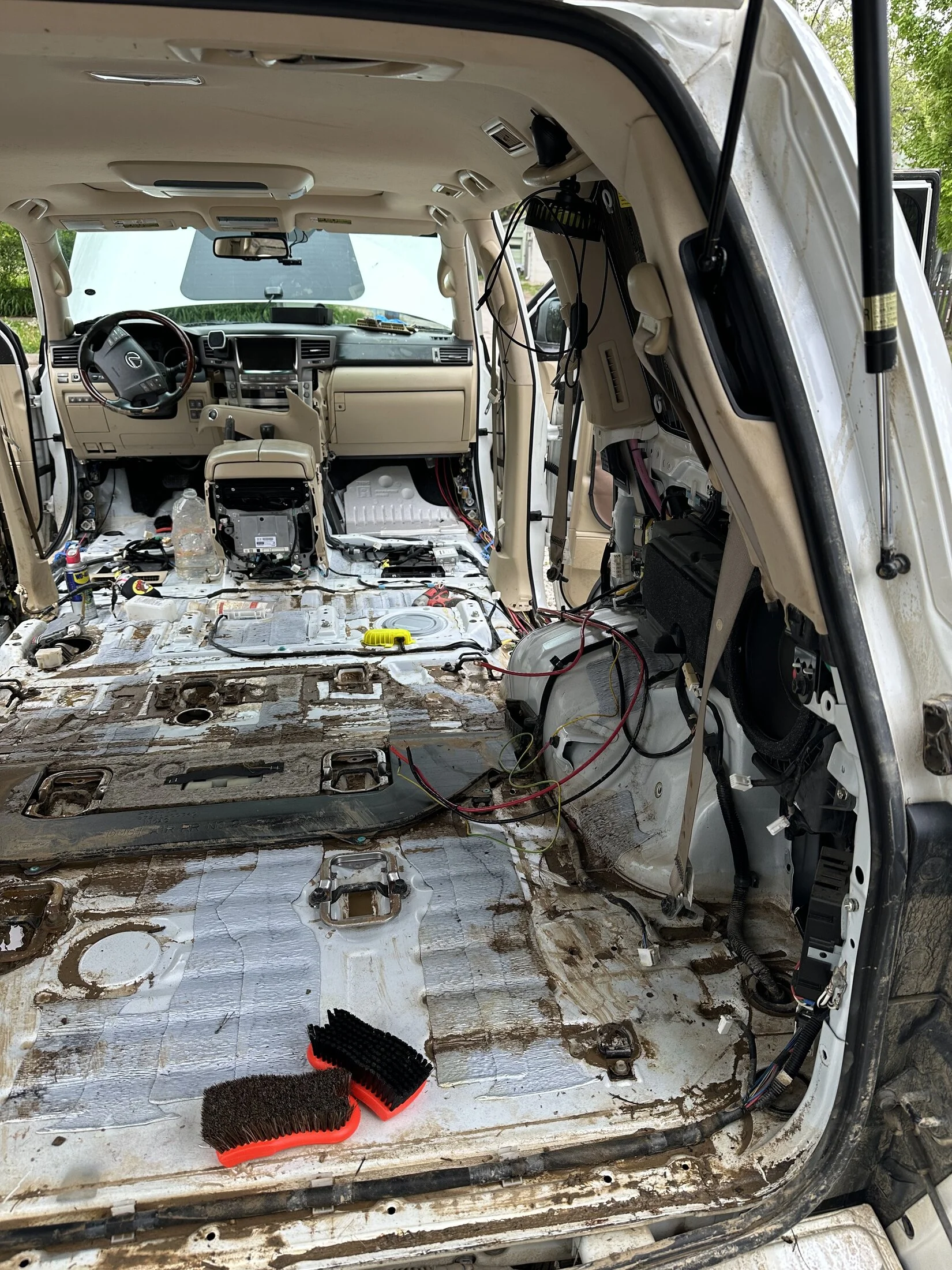

I’ve been contemplating this all day…and I think you’re right, everything seems straightforward except around the console, how much of that did you have to remove?
Whole thing - typical Toyota fashion the carpet is secured underneath the center console. So you gotta remove the leather around the center console and the ashtray as well.

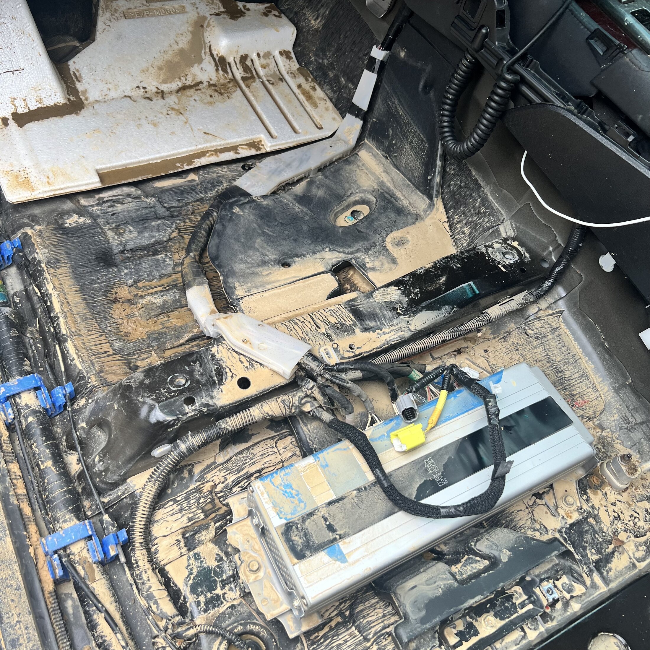

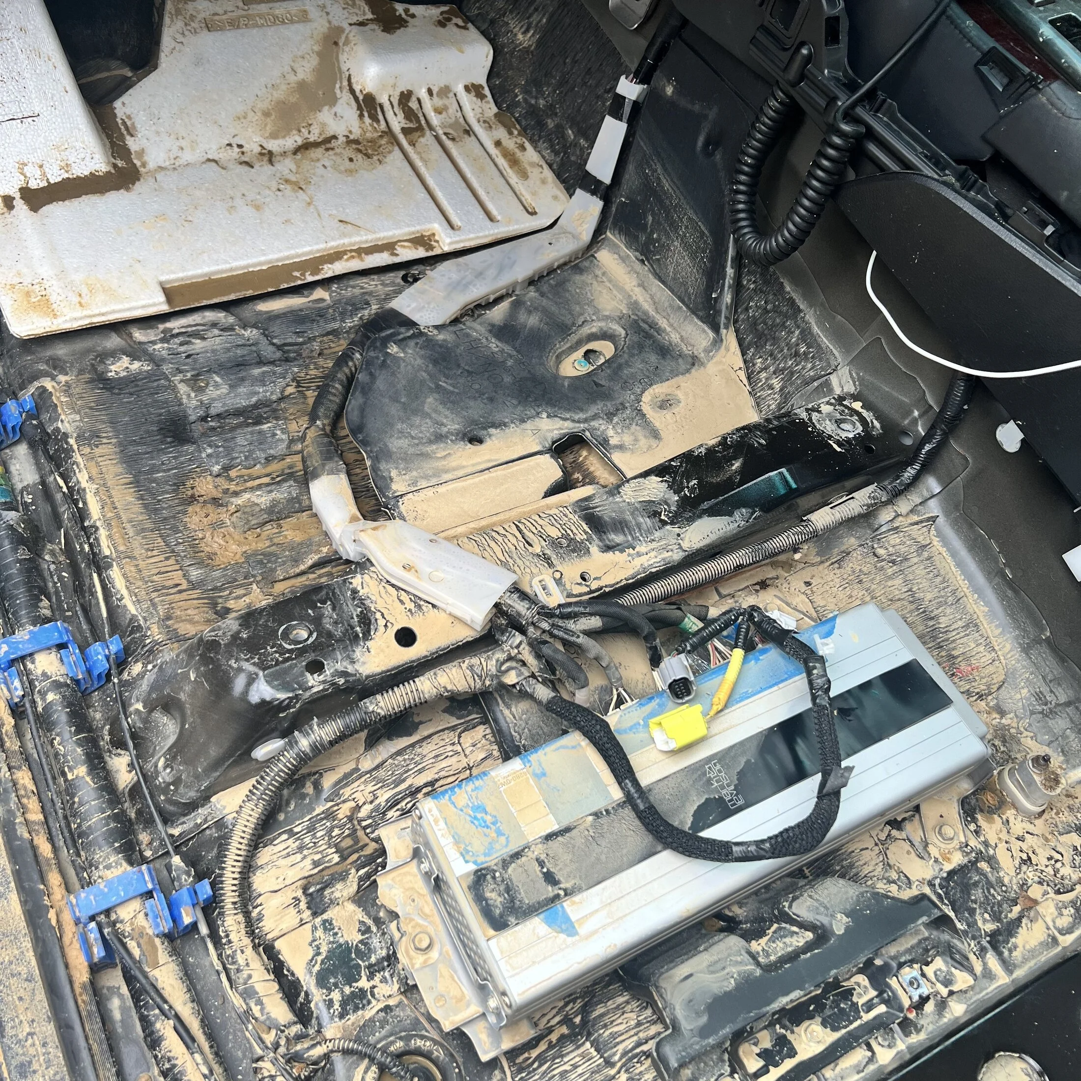

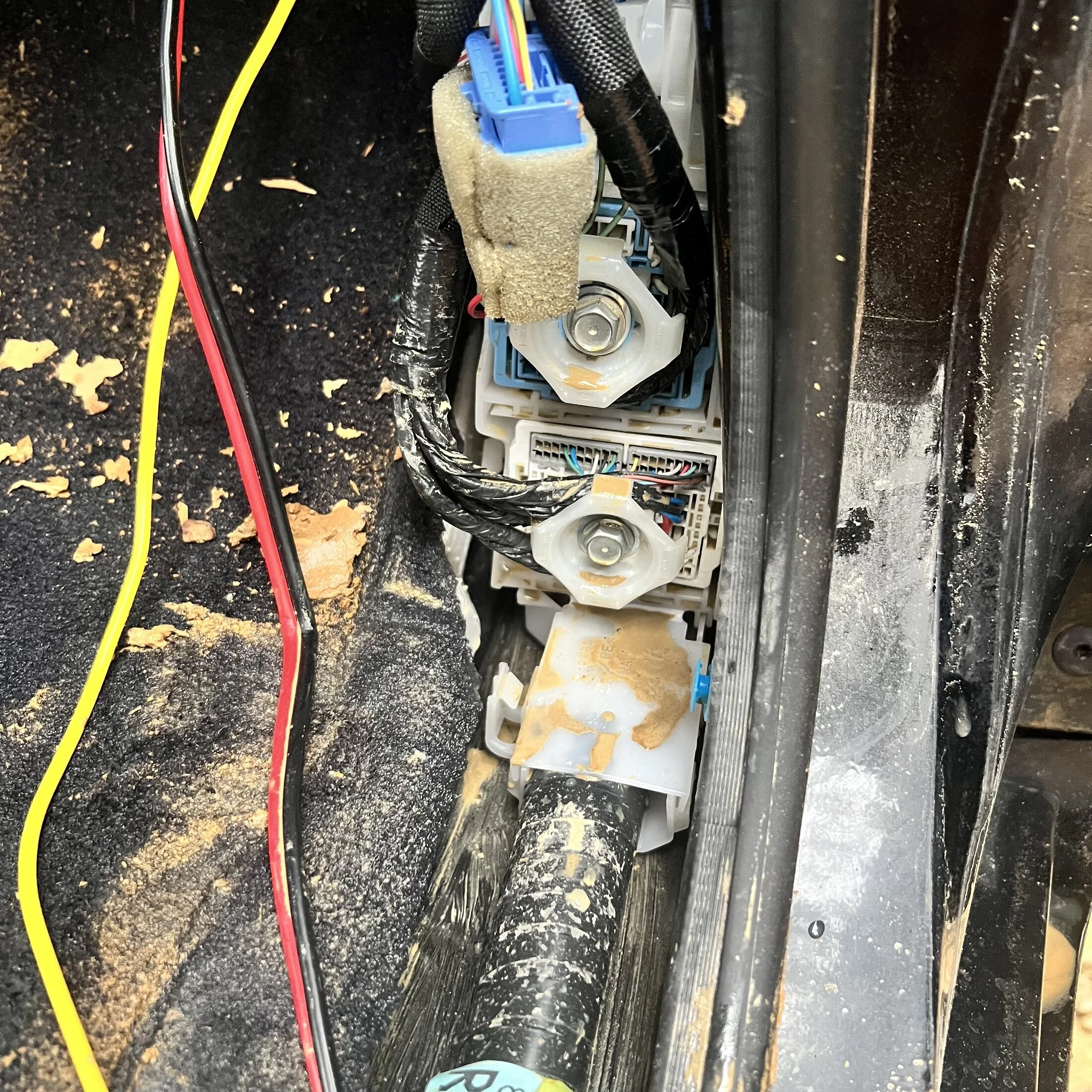

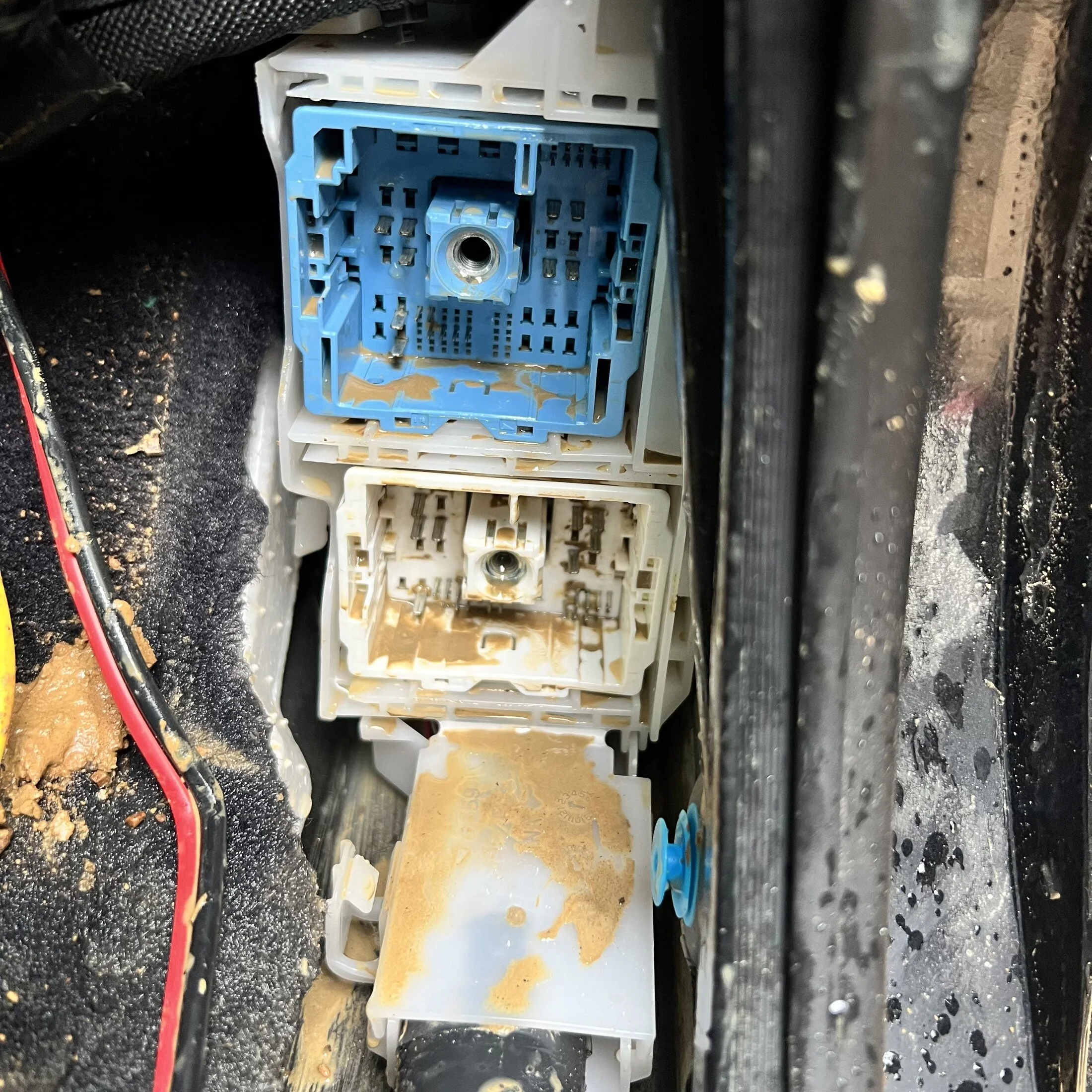

As @tbisaacs mentioned I had a similar debacle last fall. Take it all out, hose out the carpet, let the carpet bake in the sun for a few days. The connectors on the kick panels are likely culprits. The problem when cleaning these is those pins are BRITTLE. @Zjohnsonua can chime in as it eventually ended up at his shop. I replaced the alternator and lost the starter a week later. The amp damage was unfortunately fatal.
As @TN LX570 mentioned, the biggest watch out is those tiny pins. Do not use anything but spray solvents and air to clean them. Most of them are 1mm and they bend scarily easily, followed up by being very difficult to straighten without breaking.
When you reinsert those blocks be CAREFUL to have them aligned. If something feels off, it probably is, and it's probably one of those tiny pins blocking the install.
The sooner you can get those blocks clean and dry the better off you are. Once the green death sets in you've got a fight on your hands.

I’ve got the connectors disconnected and almost clean I will work on them again tomorrow with more spray clean solvent and air the front seats and carpet will come out this weekend, until then I’ve shop vaccd as much water and mud out as I could in between work today.

For the terminals, spray liberally with to flush out the grit
Hosa D5S-6 CAIG DeoxIT 5% Spray Contact Cleaner, 5 oz.
and if they can be opened then coat them very lightly with
NO-OX-ID A-Special- Electrical Contact Grease- Keeps Metals Free of Rust and Corrosion- Part# 10203
Thanks! I actually bought the Deoxit today, so good to know. there’s very little if any debris coming out now when spraying with the other contact cleaner from hardware store but I’m still working on them and plan to spray with Deoxit tomorrow. I will add the contact grease to my shopping list.

Any tips on electrical cleanup? Drivers rocker panel was under water so I’m going to start there.

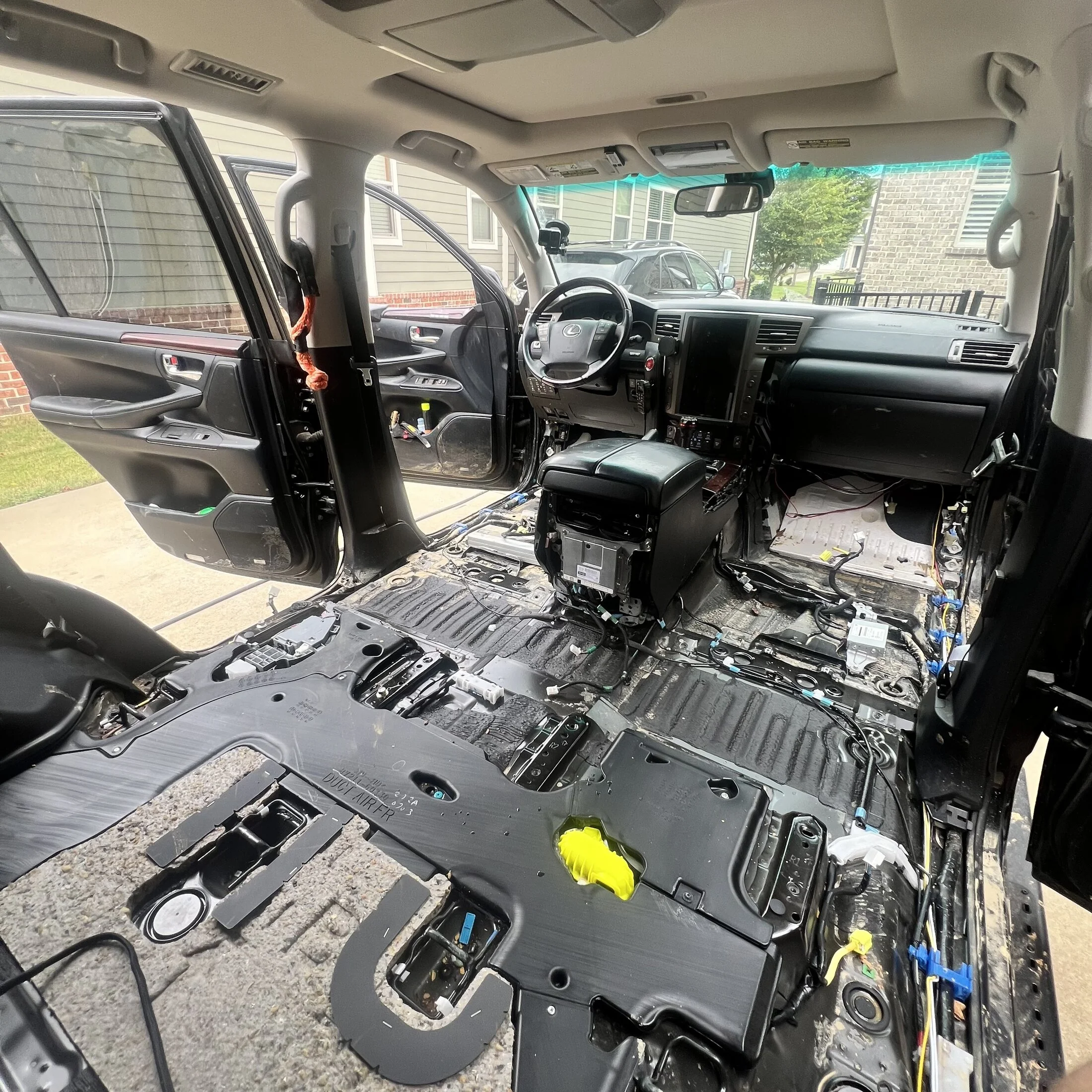

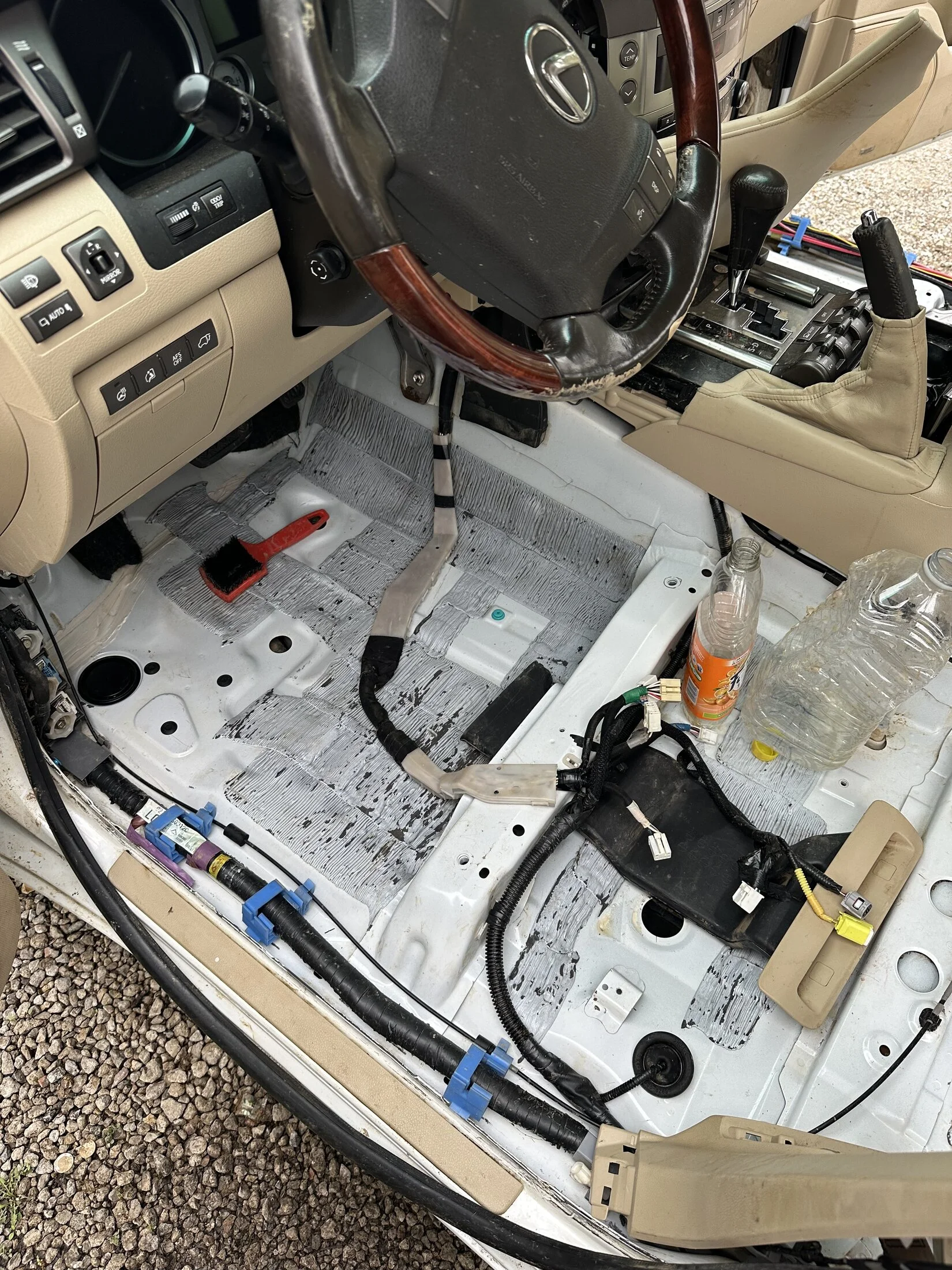

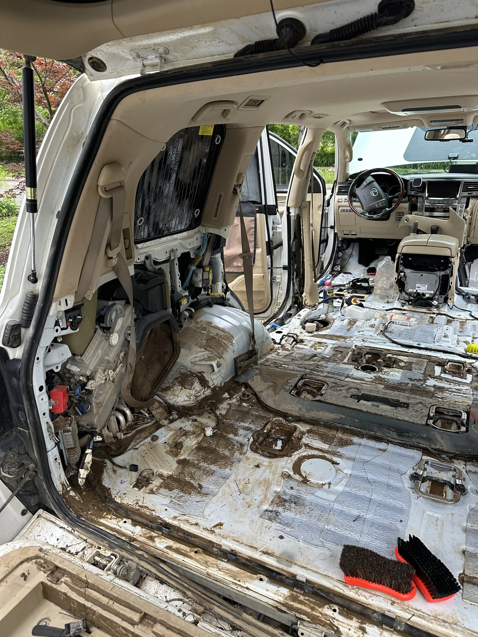

For anybody wondering, stripped it and scrubbed everything, I’m sort of OCD about cleaning things so it’s taking me awhile but no one should ever know this happened by just looking at it after I’m done. Carpets are coming cleaner than ever, waiting on everything to fully dry but will put it back together over the next weeks, also almost all of the electrical gremlins are gone, will likely have to replace the amp but I’ve got it apart and drying we will see what happens with that. The LX will be better than ever, this gives me an opportunity to rewire all the house overlanding things in a better way.
With the mud that is / was under the carpet, you must be happy that you didn't skip the "remove carpet" step.
If you have any small pins that are bent, use a mechanical pencil to CAREFULLY straighten them out. Take the lead out of the pencil, slide the tip of the pencil over the pin, and straighten as needed. I've used this method on aviation cannon plugs more times than I'd like to admit. Mostly due to other people being too rough on the equipment and not paying attention.
Dow Corning DC-4 is another good contact insulator. New name apparently.

To pile on what others have said, you're going to want some mild/moderate heat and air moving all around your interior. Now. Think what companies like Servpro, etc do when you have a water leak at your house.
One of your harnesses has a bit of green I can see. Get after that one asap for sure. Keep it up!
EDIT: If you have the garage/covered space, put some sort of closed element (no fire risk) heating element inside your rig and get some BIG TIME air movement going through it too. Do this for several days. I'm talking keep this step going until you feel stupid for doing it, then do it some more.

All clean! I'll throw up some pics over the weekend. No traces of mud in the interior, carpet looks better than it has in the past couple of years and honestly the carpet removal is pretty easy, making sure its completely dry in Kansas spring was the hard part. I did just cut the carpet around the cool box line so took a small shortcut there but otherwise carpet removal and install is pretty easy. I am thinking about putting dynamat in, has anyone done it? worth the cost? Amp is shot so will find an ebay replacement or send it to United Radio, otherwise all of the tips and tricks to save electrical connections have worked great!
Still don't recommend going through unknown/unchecked mud holes but its all part of the experience and I know the Lexus interior bits much better now.
All I can say is if you find yourself in a similar scenario, don't stop removing parts until your 100% sure there is no more mud/water or the parts just aren't practical to remove, ie the tailgate, I forgot to remove all the plastic bits until I was almost done and it was full of water and mud.
