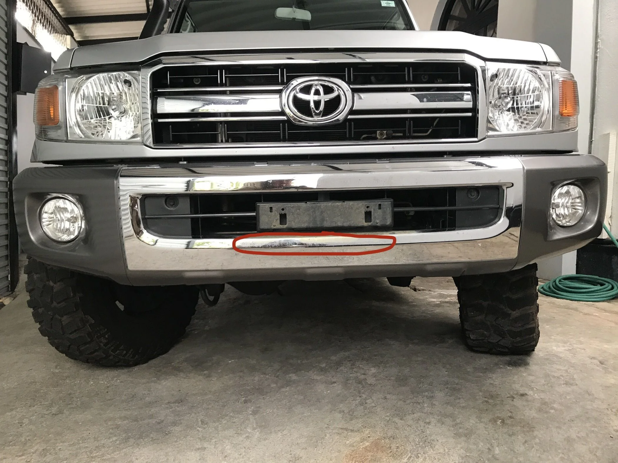

I would like to know in-order to mount either of these winches is it possible to mount them upside down. Which would enable to hawse fairlead to come out of the bumper at a higher point which matches the slots in the original bumper of my land cruiser 79
Below is the image of the vehicle with the Hawse fairlead shown in Red with normal mounting

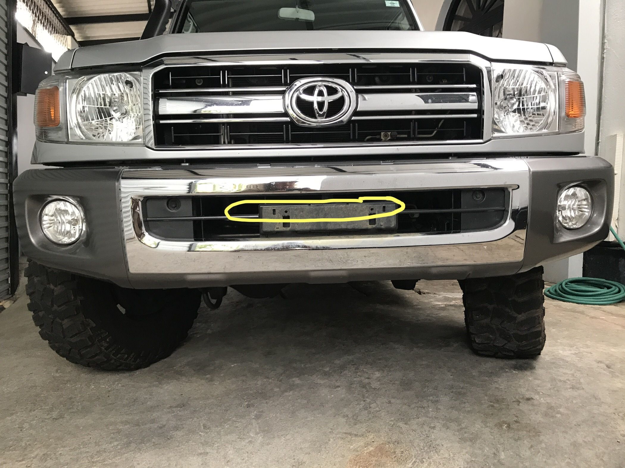

Below is the image of the vehicle with the Hawse fairlead shown in Yellow with inverted mounting where the winch is upside down.
Im worried about the drainage of water as well as lubricating oil in the winch when inverted.

The quality will be the same.
In terms of mounting upside down, you can mount it any way you choose so long as the winch rope comes off the bottom of the drum. (If you flip it 180 degrees, it'll be on the top, but the rope must follow that orientation for the brake to work correctly.)
Unfortunately, I can't really be of assistance with a custom mounting solution, however. Just make sure if you have something custom-fabbed that it's up to the task of pulling.
