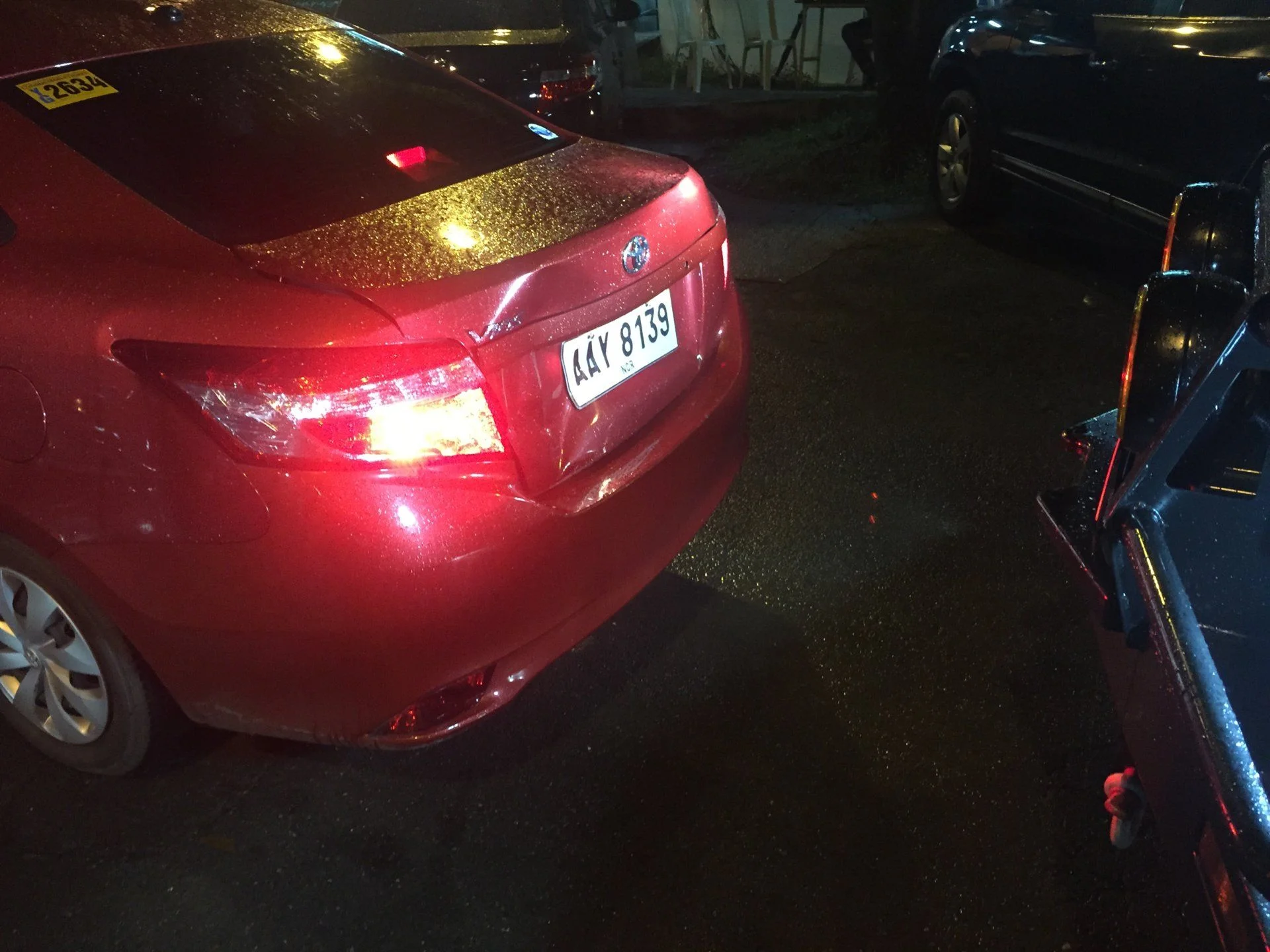

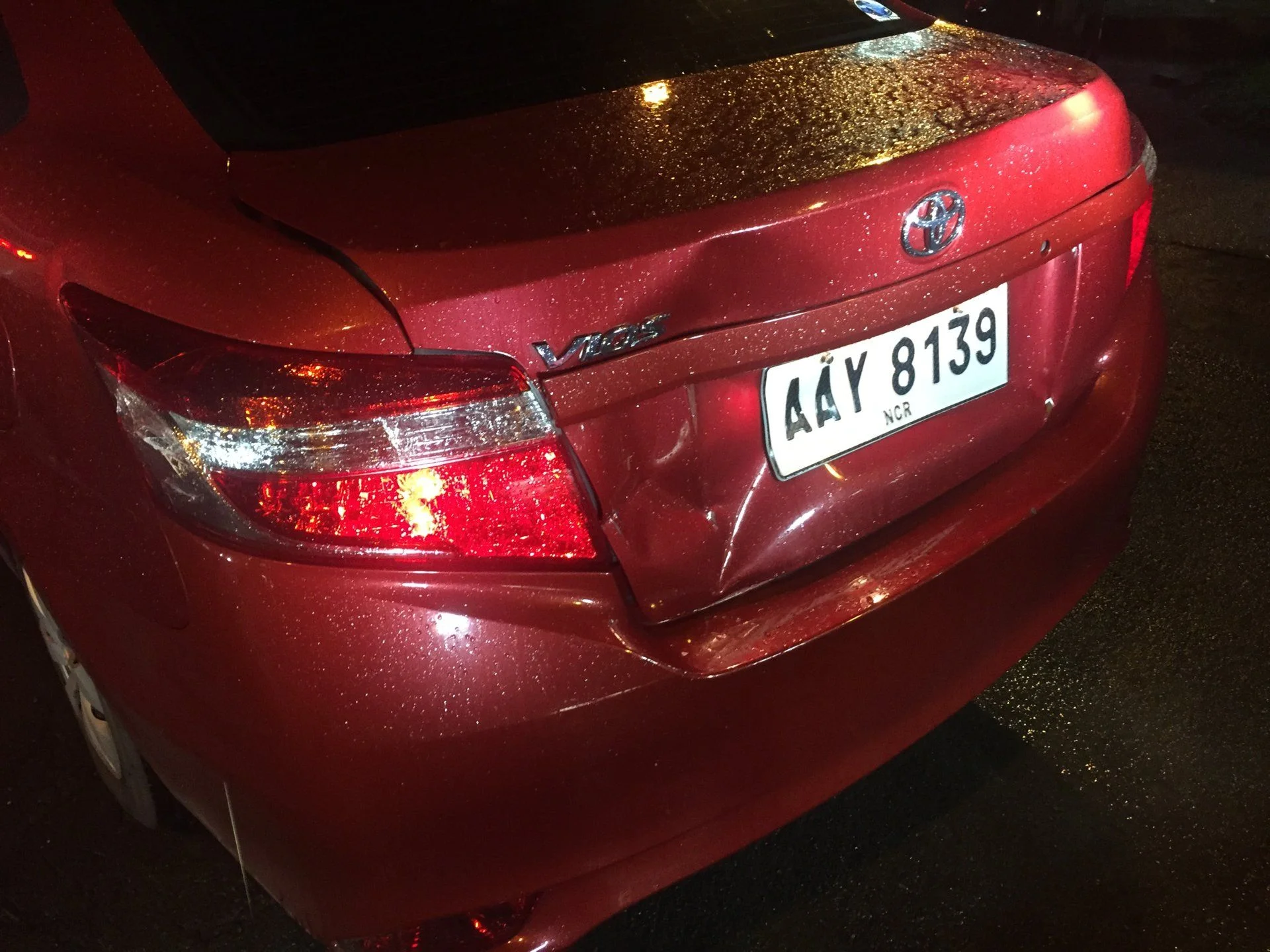

My ARB has been in a couple of minor fender benders, no damage in both :)
First was when this newbie in a manual transmission rolled back into me on an inclined road
Second was when this guy cut me off but misjudged the distance ;)
Both drivers were scratching their heads while I was trying my best not to smile :D So I'd have to say yes, the ARB does add significant protection vs. the stock bumper

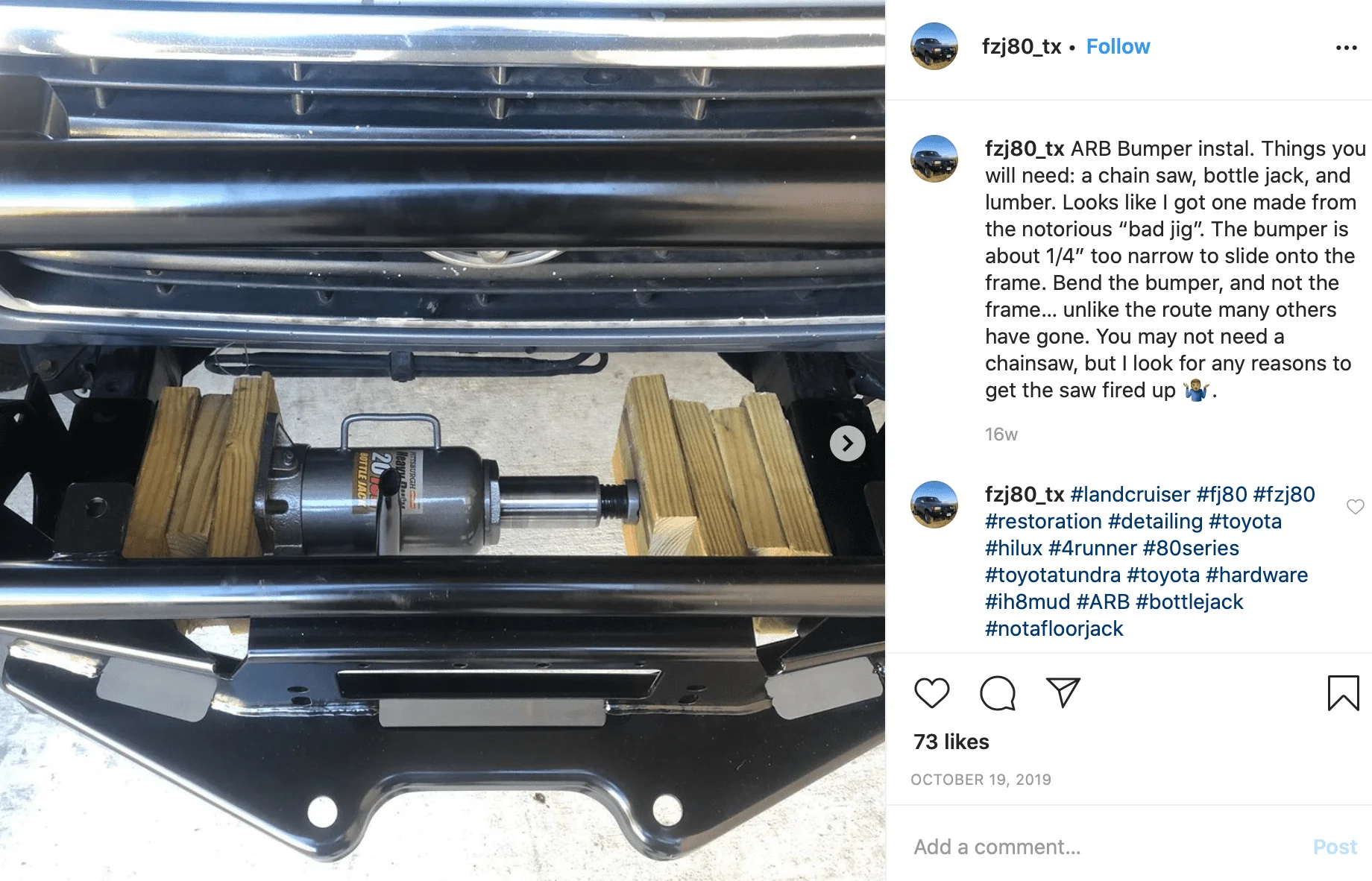

Unless you get one thats "tight". I had to use bottle jack to open it up to slide it on. Not a big deal. I actually prefer it, as I imagine there is no way a local druggie will be getting it off with hand tools.

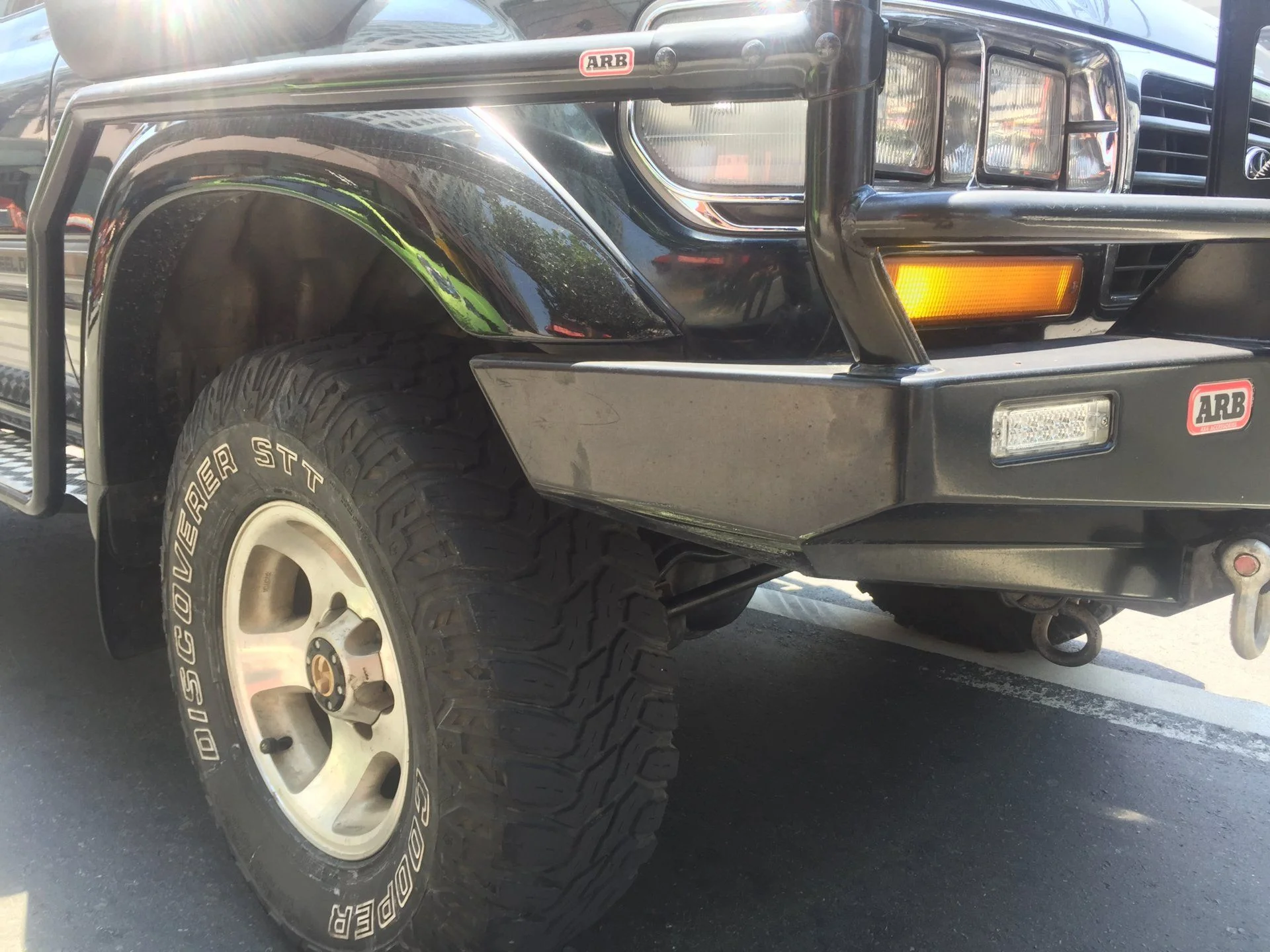

Also, the factory turn signals are still plainly visible with the ARB installed, so if you prefer to not mess with the wiring, don't bother hooking them up. I am very comfortable with wiring but I haven't bothered hooking mine up and the bumper has been on the 80 for ~15 years.
replace those silly market lights with real driving lights.....Rigid SRM's fit well with just a bit of cutting and the light output is a huge gain but not in oncoming traffic's eyes .... I used the Wide lense version.

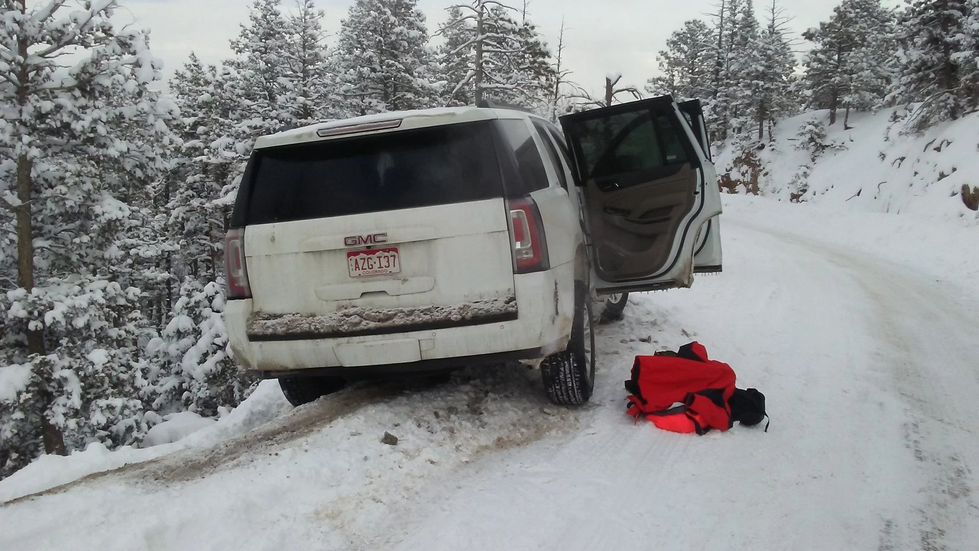

From your mouth to Gods ears, my friend. lol 80s have a certain tendency wherein the position to need a winch finds you (not the other way around).
Much like...minding your own business and you turn a corner to find this...
The only thing keeping this heifer from sliding off the road and down the mountain is its high-centered'ness.
But we all understand tho. :deadhorse: lol

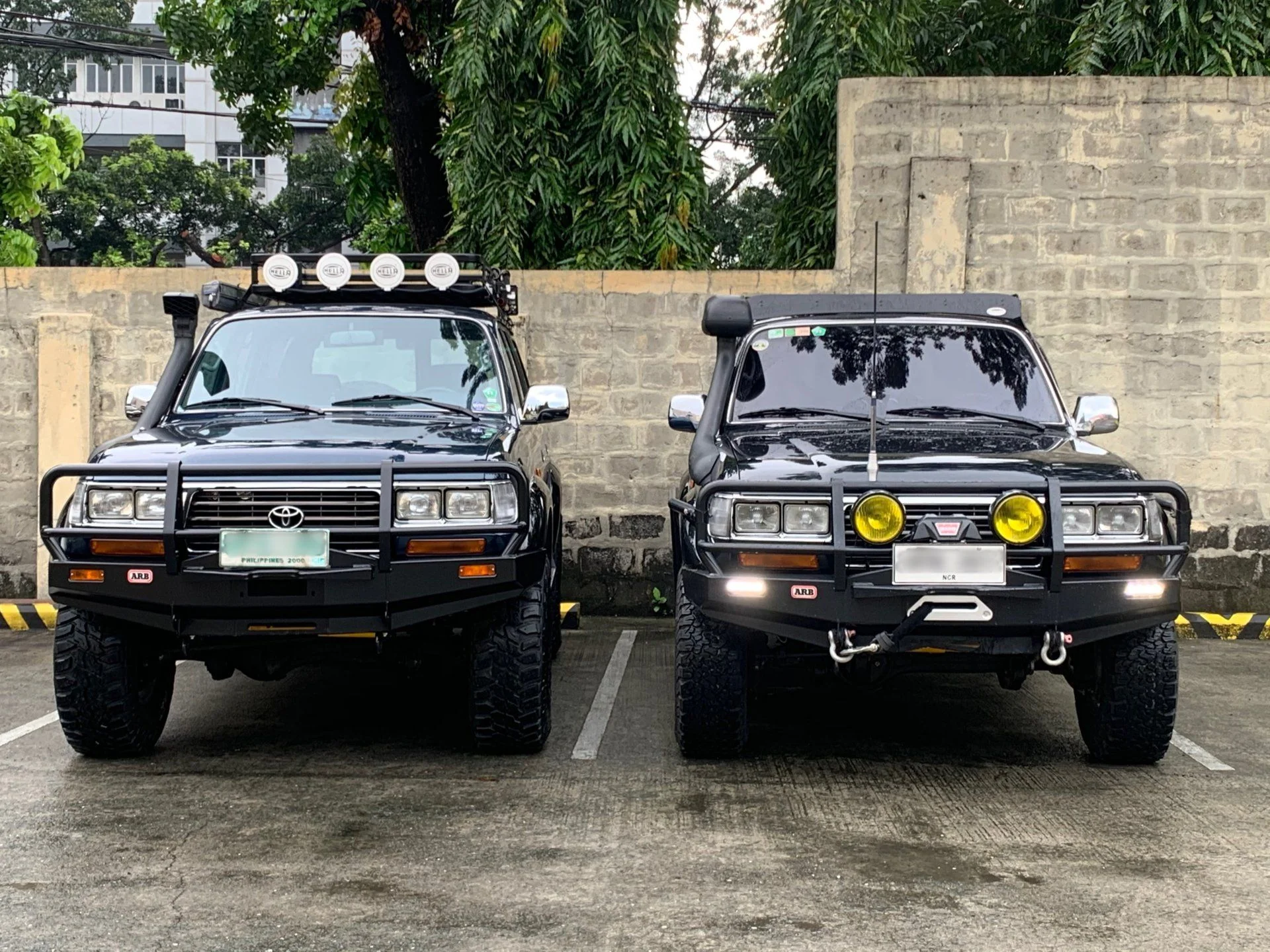

Those rigs are so cool. Which one is yours?
I’ve always wondered about those specific dual headlights. It seems as though Toyota only put those on 80’s sold outside the USA. Is that correct?
