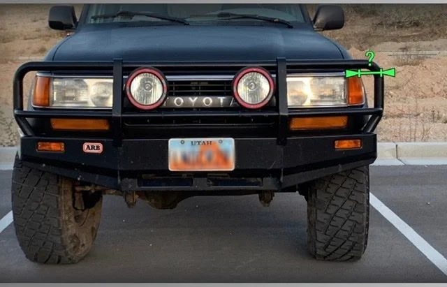

So I’ve got another question I’m hoping maybe you guys can help me out with?
I need some measurements of the ARB to make sure that if it’s on my rig it will fit in my garage. I don’t want to buy one and install it before finding this out.
Would anyone here be able to do me a HUGE favor and take some measurements for me?
What I need:
- The measurement of how far the bullbar’s wings extend from the edge of the car.
(See photo #1 below for example).
- The measurement of how far the bumper protrudes outward and frontwards from the front end of the car. (See photo #2 for example).
Photo #1:
Photo #2:
If anyone can get me these measurements that would be so absolutely helpful and amazing.
Thanks in advance!

SNIP
In Photo #1, it appears that the hoop extends out past the body work, but it doesn't. The edge of the hoop is about halfway out on the front flare, so it doesn't even extend quite the full width of the truck. Thus the answer is 0". This is for the North American spec 80s with flares. There are other versions of the ARB designed to fit a truck without flares, in which case if the hoops are otherwise identical it might be about 2" wider than the body work. The non-flared versions have truncated "wings" down on the bumper itself, unlike the ones we get here that generally have flares as standard equipment, to deal with this slightly reduced width.
In Photo #2, the front face of the bumper extends out from the grille emblem (the "sombrero" in the case of my 97) approximately 8". I'm pretty sure the non-winch ARB is the same as the winch version, excepting the reinforcing mount flange for the roller fairlead and the fairlead, which will not be present on the non-winch ARB.
  • Like
Reactions: mrq
Wow — thank you SO much for this. You have really helped me. I appreciate it immensely!
