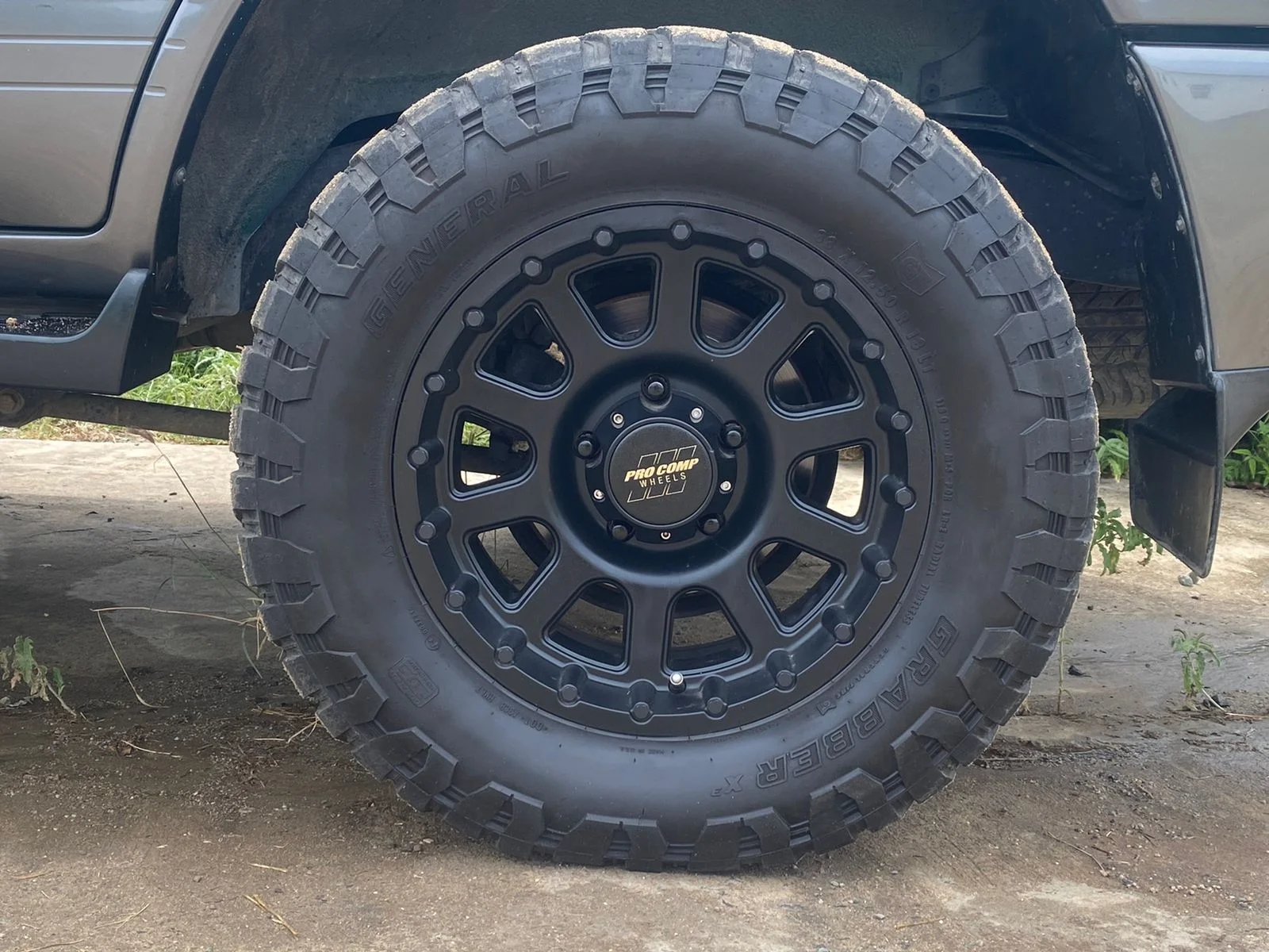

Per above! My 100 came with some Grabber X3 33"*12.5" R18s on Pro Comps which weigh over 105 lbs per corner unworn!! To be fair the pro conps are 28lbs which i think is light for an 18 of that build quality.

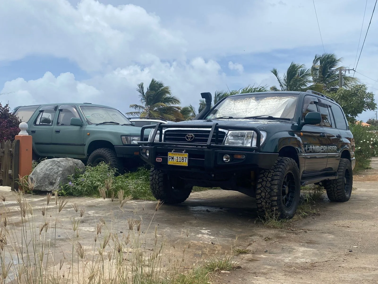

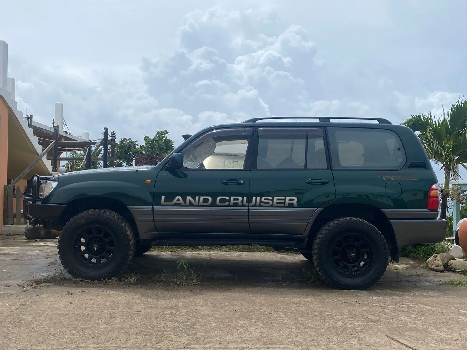

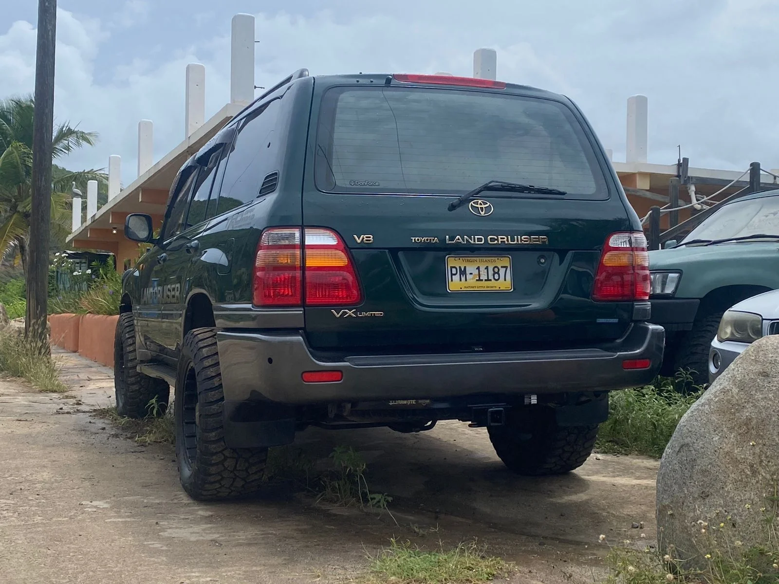

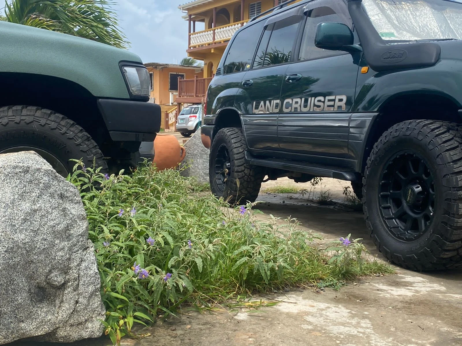

Here's some picture whoring of the current 33x12.5R18 Grabber X3, for anyone interested.
I'm actually scared to flex at minute, as not entirely sure whether too wide to clear the arches....
Looks great, but might be a case of form over function, in what is an otherwise great build from the former owner.

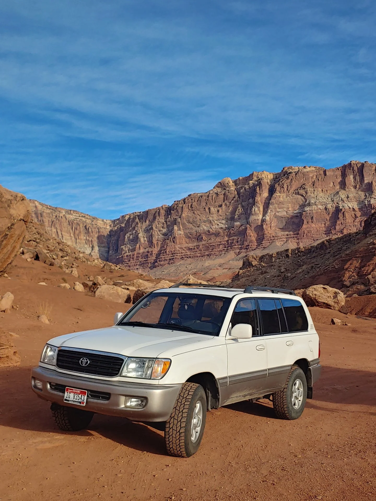

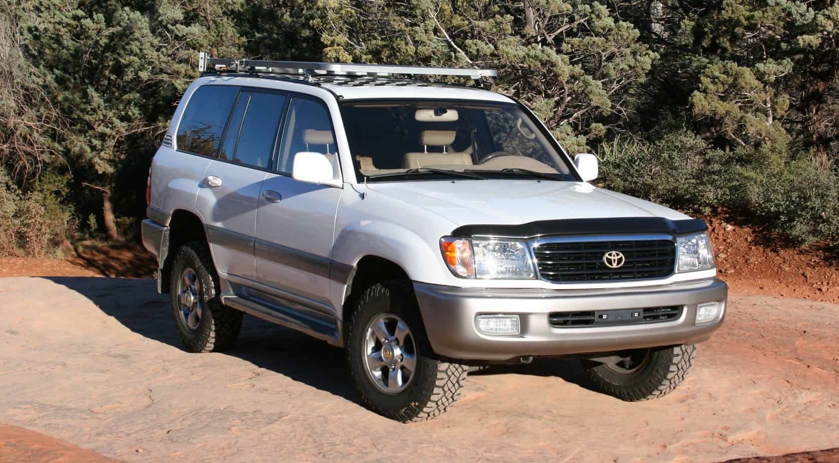

Found a really nice rig on expedition portal here but no side shots:

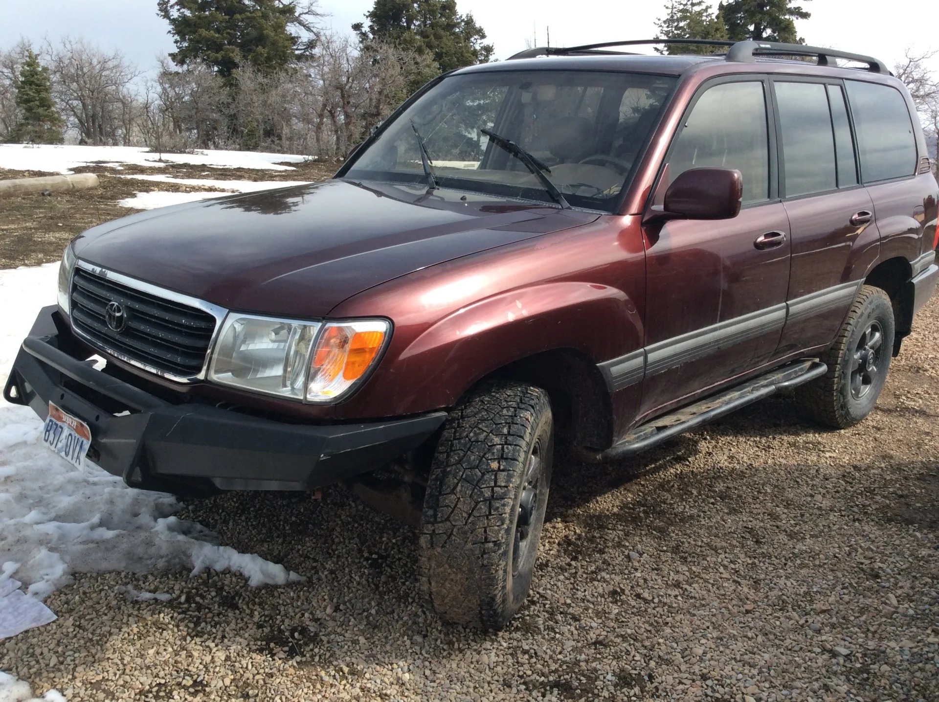

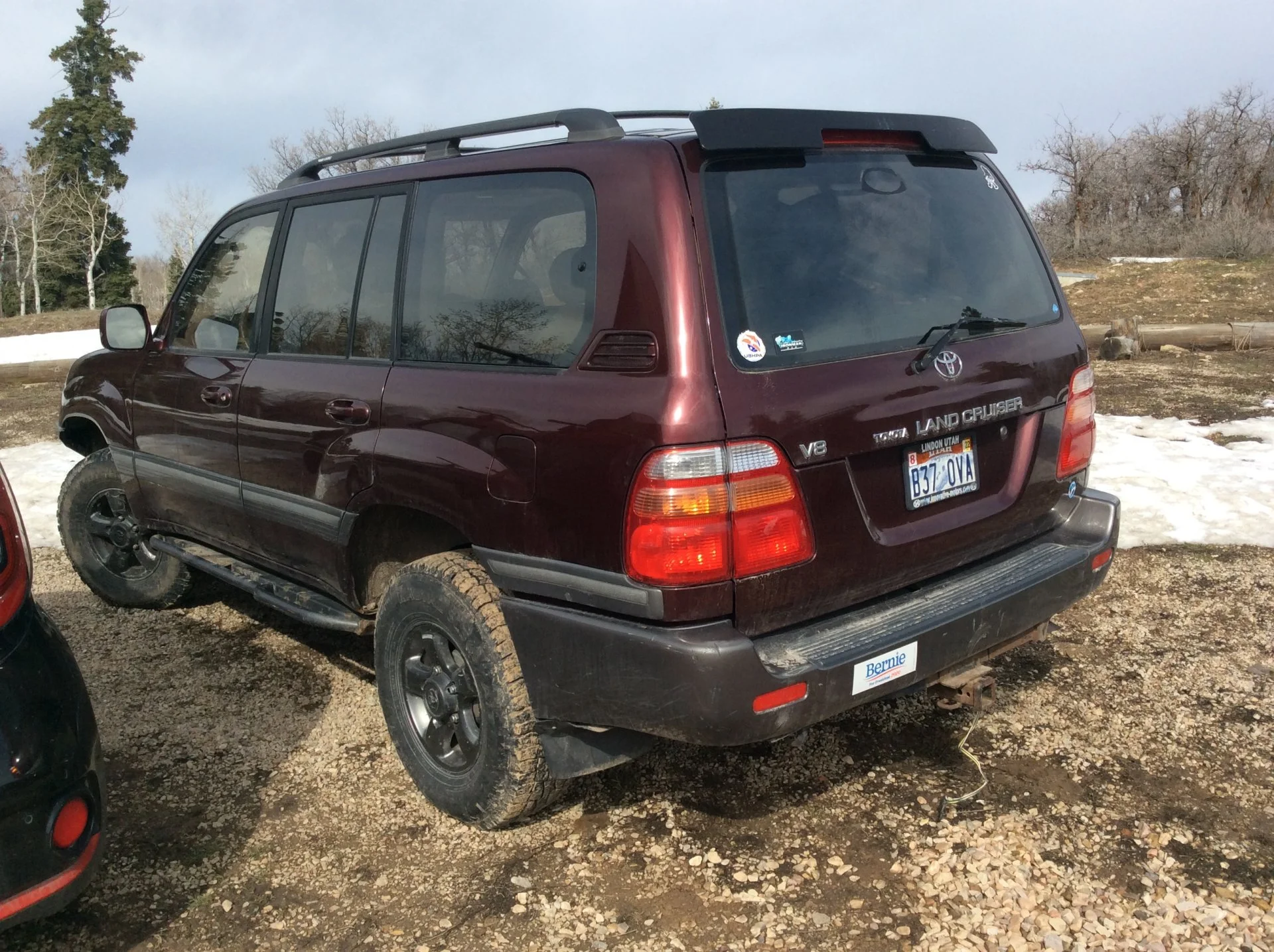

It took me a bit to find a picture, but here’s mine with a little over 1” of lift with 265s

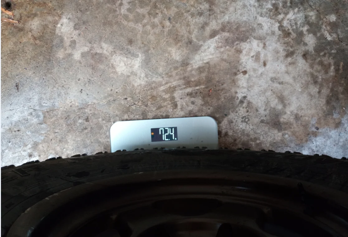

My wheel tire combo weighs in at 72.4 lbs. I think the original wheel and tire weight was ~72 lbs. I'm running 286/75R16 Cooper (now Evolution) Mud Tires that are E Rated. They do ride well for that type of tire. I think people are becoming more rotational weight conscious these days.
I wouldn't worry about gears until after you drive with a wheel and tire combination that is close to 72lbs. You might be surprised at how well it drives.
I think Cooper has an Evolution model with a less aggressive tread than the mud tire. The SCS F5 rims weigh 18.6 lbs in the picture.

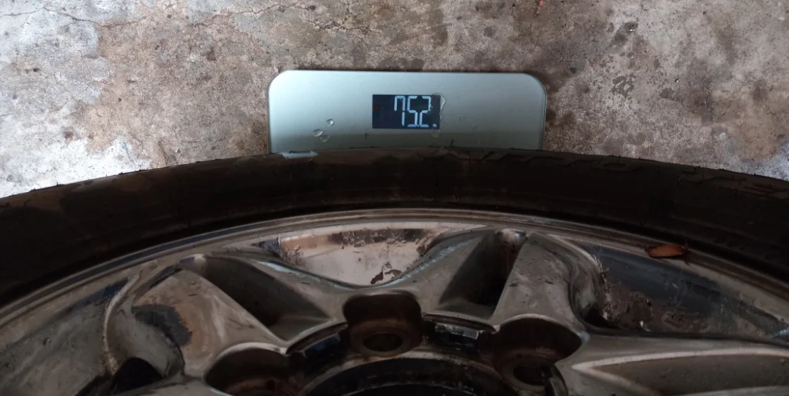

Factory wheels with Nitto Terra Grapplers weighed 75.2 lbs

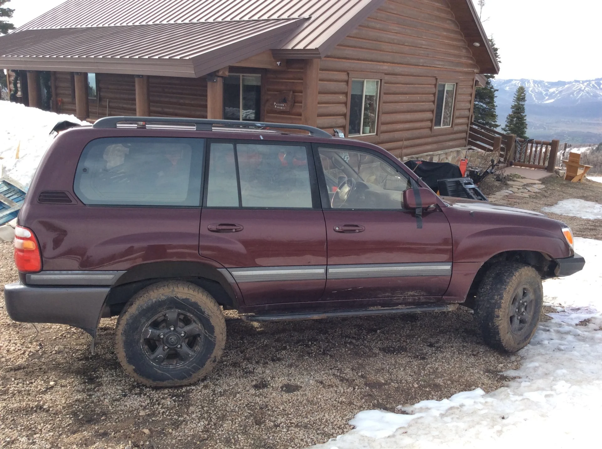

Here’s a few pictures of my 99 Land Cruiser with 265/75R 16 tires on stock wheels. I put these on when I had stock suspension height but now it has an Iron Man medium lift, about 2 inches of lift. These tires look small to me with the lift. And they didn’t do anything for the highway ride or fuel economy compared to the previous 285/75R16’s that I had on there before.
I’ll be going back to 285/75R16 tires or 255/85R16‘s for the next set.
Thanks for the additional pics. Definitely leaning toward the 265/75/16 just being a bit too small with the lift.
