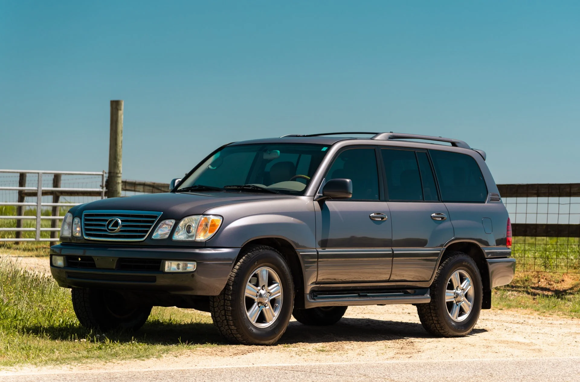

You can have 33s and a nice ride. For those of you searching for a better ride with your 100 (particularly if you feel like the AHC is still a bit harsh) then go look at your tires. If they are E-rated, then that might be your problem. I have all new globes and fluid in my AHC and it functions perfectly, but I kept thinking the ride was a bit harsh over the smaller stuff and at lower speeds. I saw a few people mention the E-rated tires that are extremely common for 33s, and my rig came with them as well. I have no plans for extreme stuff, only gravel roads and the occasional creek crossing. Those E-rated tires were heavy and stiff, and I had NO idea how much better the ride could be by going back to P-metric. I bought the only 33s I could find from Discount Tire, the General Grabbers. They look good (you can see them in this photo), and they ride very well. My LX accelerates faster and soaks up the road much better than before. Broken pavement used to "crash" the suspension, and now it just thumps. I am very pleased with the ride, it is certainly Lexus-like now, and I wanted to share this with others who value ride quality over off-road durability. Just a data point! Also, for the record, I had the Michelin LTX AT2s on there and they were quiet, but still too rough for me. For anyone in the Georgia area, I can sell them to you for a good price!
