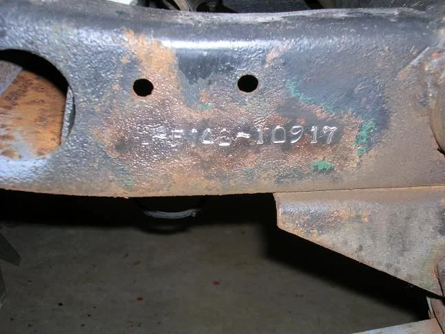

I'm surprised that they were not interested in seeing a frame vin?
As mentioned earlier, right front frame horn.
Does anyone have a picture of the vin plate in this location. I don't have one there and there five other 40s in my club and none of them have one there either. Mine is on the firewall, passenger side.
Thanks,
John
its the very front of your right outside frame almost at your bumper. about 8" long or so.
googled it and found this photo
attachment.php
