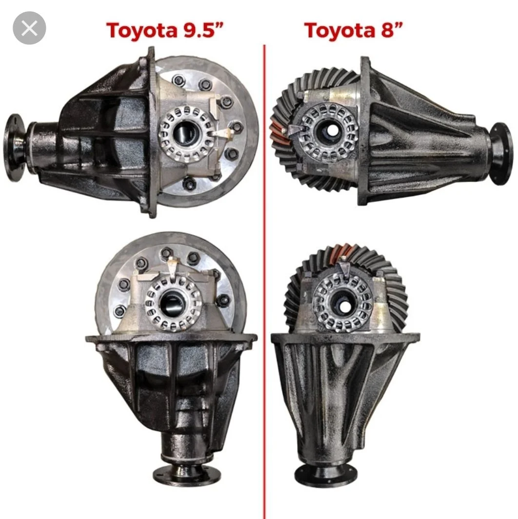

3rd member is the "pumpkin" the part on the rear that houses the gear, pinion, locker etc.
