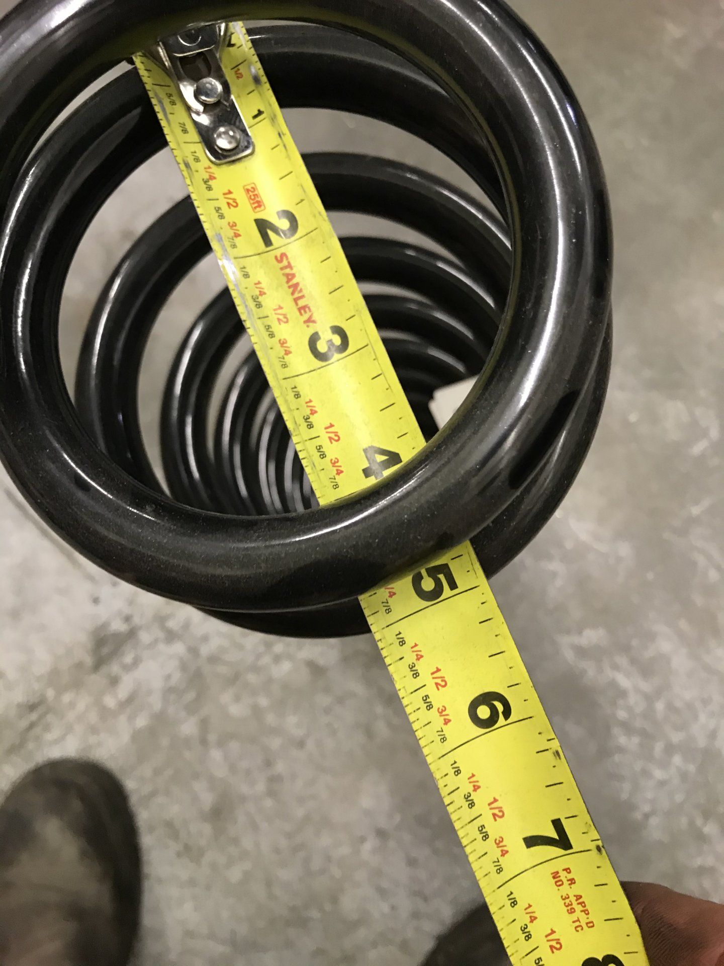

I am currently building a 45 with 80 series suspension. Fitting the front coils on this build is tight. I recently read that 70 series (76/78/79) front coils are narrower than 80 series coils. I am hoping that I can use 70 coils to help create some space on the front of my build. I have searched and can not find any specific measurements for front 70 coils. I am asking here for anyone willing to please post up your 70 series spring diameter measurements. Please include your series, stock or after market spring manufacturer. The outside largest measurements are what I am looking for.
The stock front coils I have from a 91 80 series measure 5.75 inches across the top outside to outside.
Thanks for your help!

Set your suspension up with 80 stuff imho. The shocks and coils are longer then 70 stuff. If you don't care about flex then by all means use 79 suspension. My hdj79 is running TT smart coils at the minute, measures approx 130mm (5.12 inches) across at the top. So you are looking at about 16mm different which is not much at all. Think there is 2" difference between the 79 stuff and the 80 in height. Other than that, the 79 uses the same radius arms ect
Thanks for the measurements. I am going to use 80 components for the rest of the suspension. The springs look as if they will give me a little over 1/2 inch of space which would be helpful. I will have to look up the height difference compared to 80 coils. I guess I can order a taller spring for a lifted application to try and make for the height difference.

Another member has an old set of springs they made me an awesome deal on, so I can use them to mock up with. They measured at 5 inches across the fronts as well.
Compared to the stock 80 springs I have the 70 series coils are .75 inches narrower. This gets me 3/8 extra clearance where I need it. The 70 coils are shorter than the 80 coils but I believe that can be changed.
