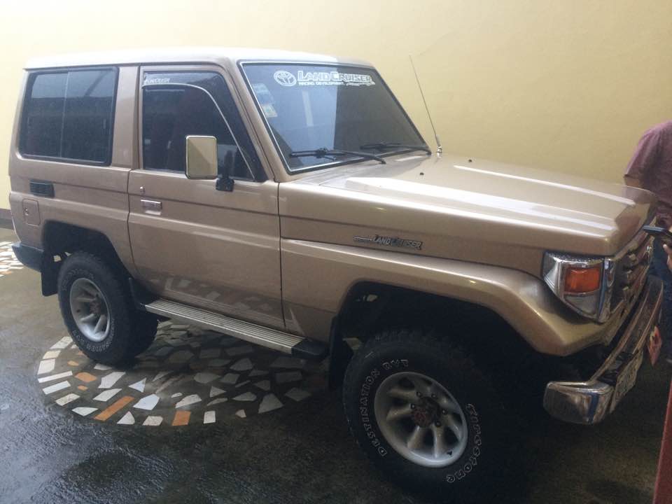

Alrighty, lets get into this.
1990 PZJ70LV-MN is the model of this truck. Latin spec.
Vin: PZJ70-0001612
Engine: 1PZ
Trans: R151F
Axle: K255 and rear is an LSD (4.56 gears)
Color: 4K1
Trim: FA40 (LX trim)
Build plant: A11
I do believe for this market, LX was the highest trim level offered in a PZJ70.
Spare parts for Toyota LAND CRUISER/LAND CRUISER PRADO PZJ70 | Buy high quality spare parts for Automobile at reasonable prices in MegaZip online shop.
Rear axle is a full float which I believe came this way from the factory, after searching the Toyota EPC using my vin number. Drum brakes rear and disc front.
Factory A/C truck. No heater. Got all the heater stuff sourced though.
The truck has been painted. It is a very good paint job overall. Not a USA $10+k paint job but for this part of the world you very rarely see them painted to this level. Hardly any rust in this sucker at all that I can find. Virtually no body filler, I use a body filler detector on all trucks and this one is checking out real clean. All the original glass is in the truck in excellent condition.
It does have it's issues and I have already started in on repairs. I am compiling a list of repairs and things I need to do to it to bring it up to my standards. I will also be tidying up the interior and other details. If you have watched any of my other builds here on Mud you know I am pretty anal about details.
This truck is my DD until I sell it. Pics to come!

I enjoyed the pictures of the truck. Looks pretty clean. Wheels have to go in my opinion. It must be a South American thing to put on fugly wheels.
Mine had some ugly black wheels when it came from Colombia and one of them didn't even match the other three! Seller should have noticed that and I should have too.
that same exact wheel model can be found on a number of latin suvs, ugly.
too bad you got rid of the tribal browning sticker, please do not remove jesus in the rear view.

Haha! Jesus went on the door of my shop to ward off thieves.

I didn't realize yours was a Colombian truck. Gas then huh? Got a link to a build thread? I been to Colombia four times, great country and tons of Cruisers but they are all gassers. I have seen a few here with the 1fz, I am thinking that moves a swb pretty good.
And yes they do like butt ugly wheels in Latin America.
