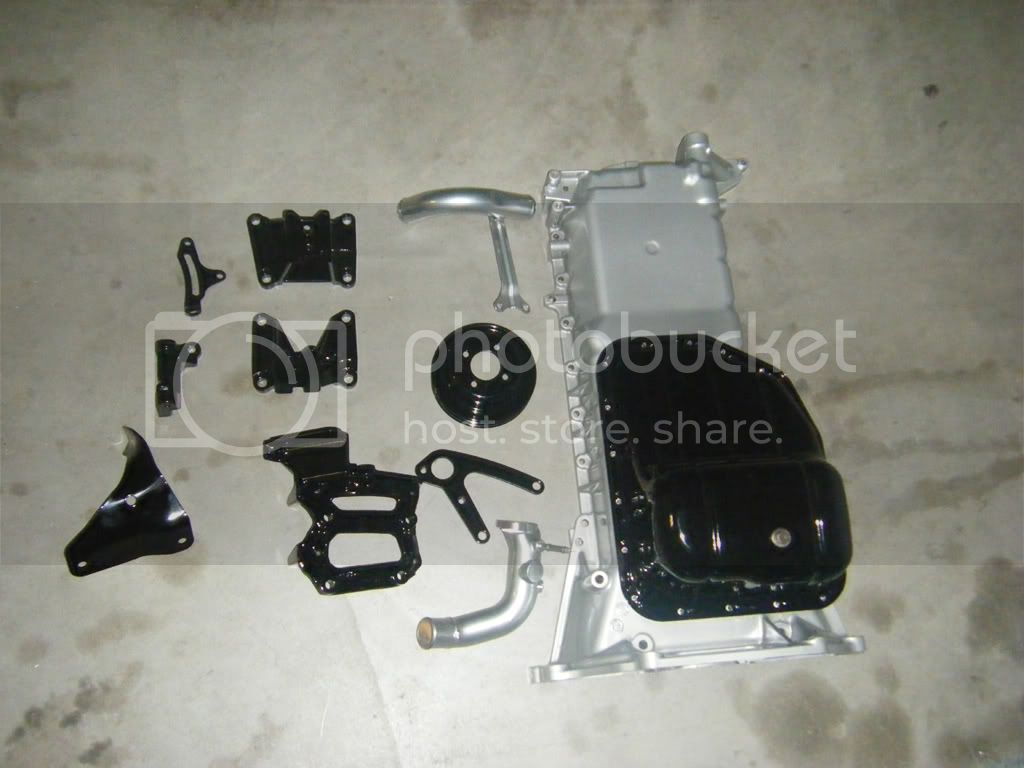

pulling this old thread up from the dead. Got my 1fz in parts on my garage floor. Thinking about powdercoating lots of it. Thinking the front timing gear cover, engine mounts (to engine), brackets. How about intake?
Any concern that heat from powdercoating will warp it and cause it not to seal properly?
Most powdercoating gets parts to 400 degrees. Here is what the interwebz says.....
Powdercoating is a process where a power is electrostatically stuck to metal then baked on. The baking procedure is done at around 390°F, the melting temperature for 6061 is 985°F and the annealing temperature for 6061 is 775°F for 2-3 hours. Unless you drastically mess up the cure cycle on powdercoat, you're not going to even touch the temperature where the aluminum structure changes. You might get into a precipitation hardening temperature, but you'd need to hold 320°F for 12 hours or more to see a difference.
