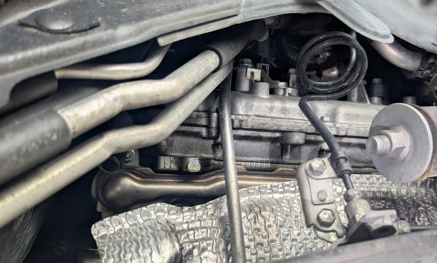

About to buy this GX for a decent discount, I just want to know what I am getting into. Are you able to tell if this is a valve or cam tower leak?
More information: 2019 about 98000 miles, ok maintenance history listed on both Lexus site and carfax

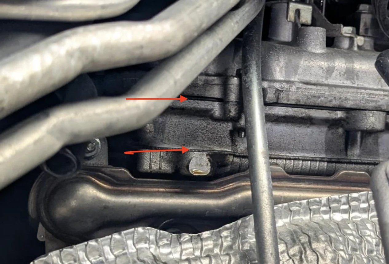

Are we looking at rear on passenger side?
Does it look like oil residue is spreading up from cam tower gasket or down from valve cover?

Looks only like seepage and not a leak. If it's only seepage, and just a little residue, I'd say pull the trigger and get it, if everything else looks good.
But as mentioned above, it's hard to give you an answer without more info on the vehicle.
I had a weep around 70k... started using "high mileage" oil and it stopped. Still going strong at 115k.
I had the oil leak with the timing cover and it was a lot. WAY kore than that. If its has otherwise a good maintenance history, its probably fine. As long as its not too bad I would wait to see if it develops another issue and do both at the same time.
I did the valley plate and timing cover reseal at the same time and it saved about 2k.
Keeping this truck forever. Its a beast.

IMO, I’d be more inclined to address a cam tower oil leak well before tackling a timing cover leak—assuming neither causes significant oil loss. The reason being the smell of burning oil into HVAC off the exhaust manifolds from cam tower leak.

The timing cover was close to a quart every 1k. The ARB skids hid it, some. I had thought I was not getting the oil filter assembly tight and they diagnosed it when it took it in for the valley plate. Not a pleasant surprise.

went to the dealership with the bank check today. I checked the vehicle over again, verified that the car has a leaking cam tower and leaking at 1 drop per approximately 10 min. it was hard to turn away from the price, but for my use right now I need to buy a vehicle that's in better condition. If anyone wants to a deal on a 2019 with less than 100K mi for less than 30k out the door let me know. thank you all for the input.

Yeah, six drops an hour will stain a driveway and cause you to add oil between maintenance. That's more than I'd buy in for.

Looks like a little of both. If you're gonna keep the GX for more than 3 years, I'd pull the trigger and get it handled. If you are looking to do it yourself, it's a hell of a job, but doable. Plenty of resources on here on how to do it if you're curious.
