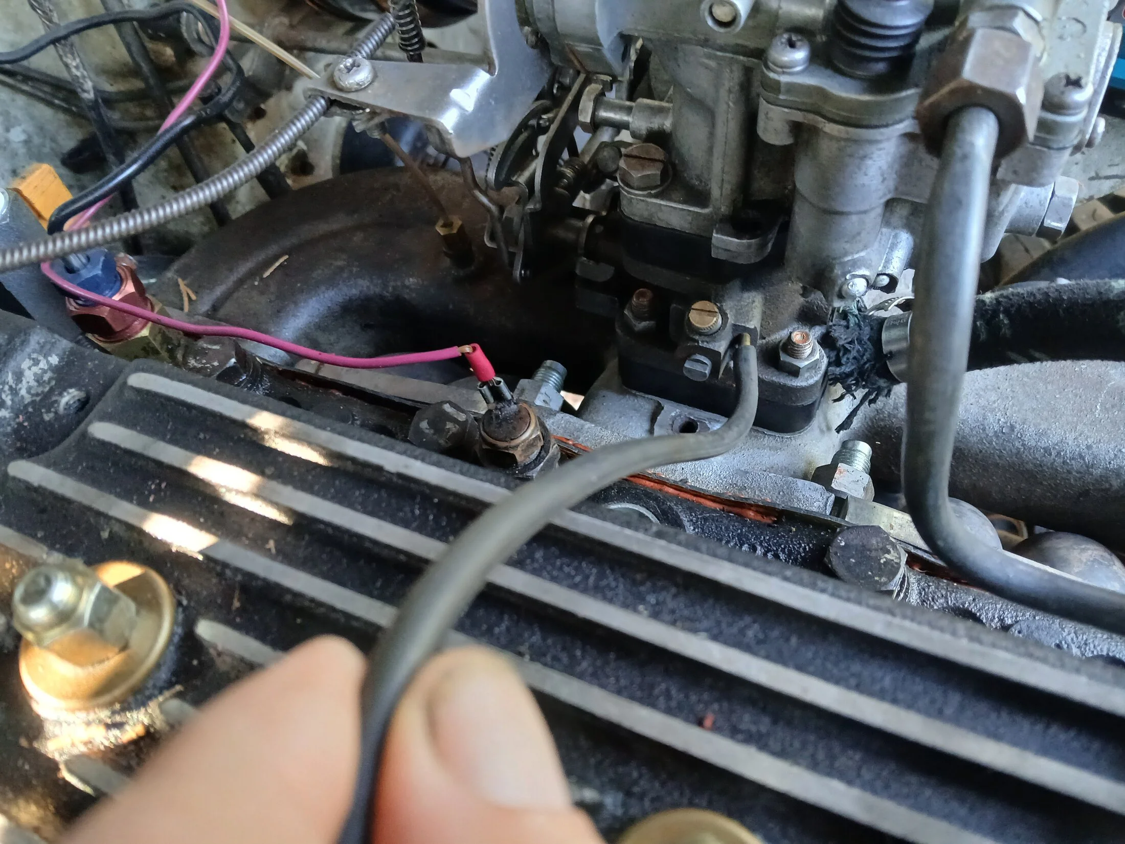

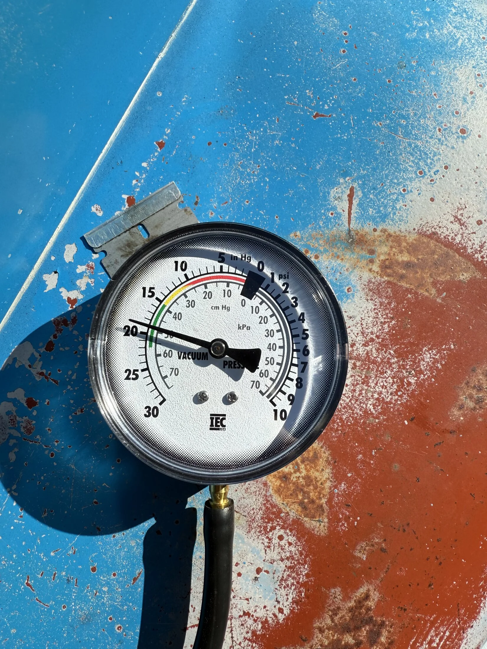

Absolute newbie here. I have a stutter as soon as I hit the throttle. I did a vacuum test from the little hose in the carb. These are my readings. It actually seems like it runs better without it connected to the vacuum advance. Less of a stutter but still not gone. What would y’all do next?

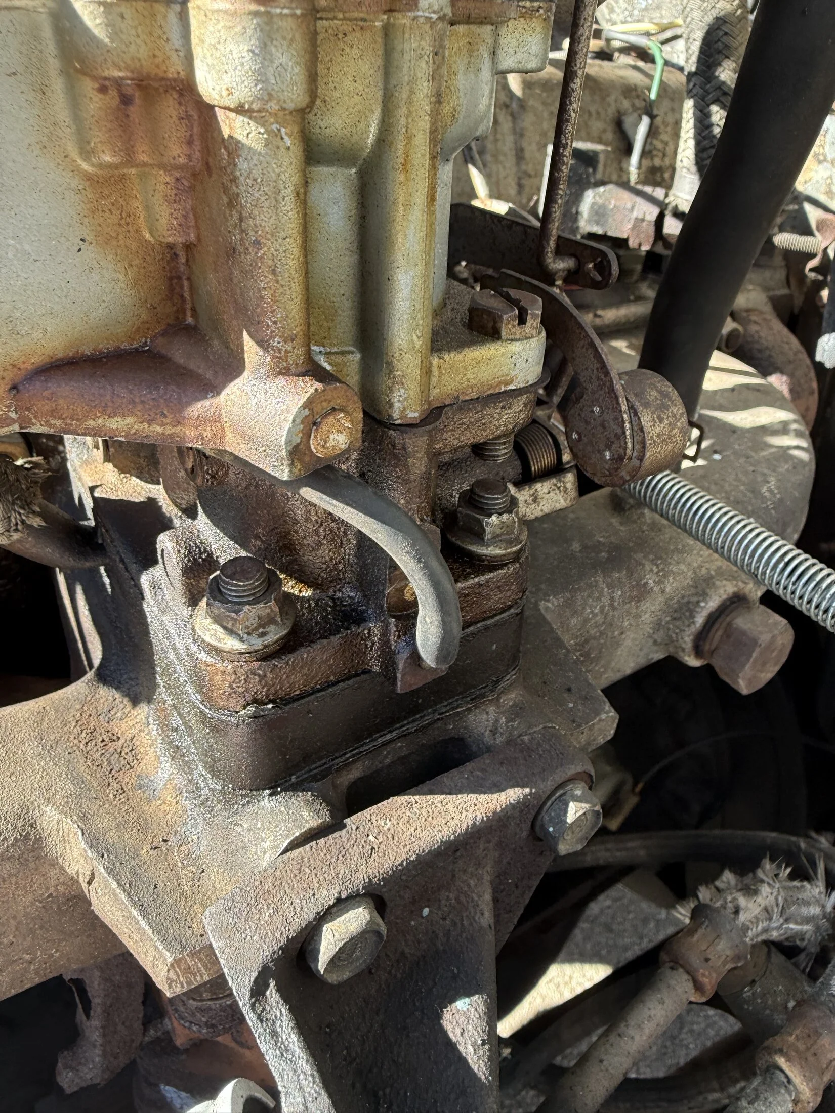

first thing, the vac advancer should be connected to a ported vac source....one that only has vacuum after the throttle plates open off idle.
On my rig, I use a port on the other side of the carb. That port your using I have a plug on it.

If the gauge is steady, you're pulling enough vacuum IMO. Perhaps your accelerator pump needs replacing? That could cause hesitation/stutter when you first accelerate.

That's the wrong port to go to a dizzy. What dizzy do you have? If it's a vacuum retard and it's getting that much vacuum at idle things will get weird. Does your carb have this port?

I was going to post the back side of my carb, pig head beat me to it.
That’s the vacuum port I use ( next to the idle mixture adjustment)

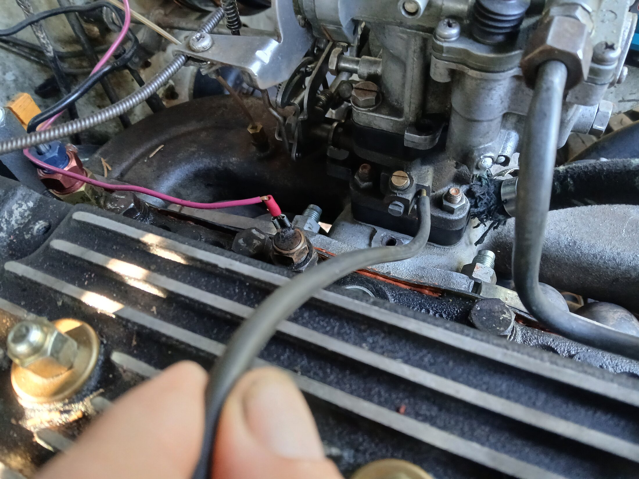

That could very well be if your dizzy is a vacuum retard model. If it is, cap off that vacuum line both ends.
