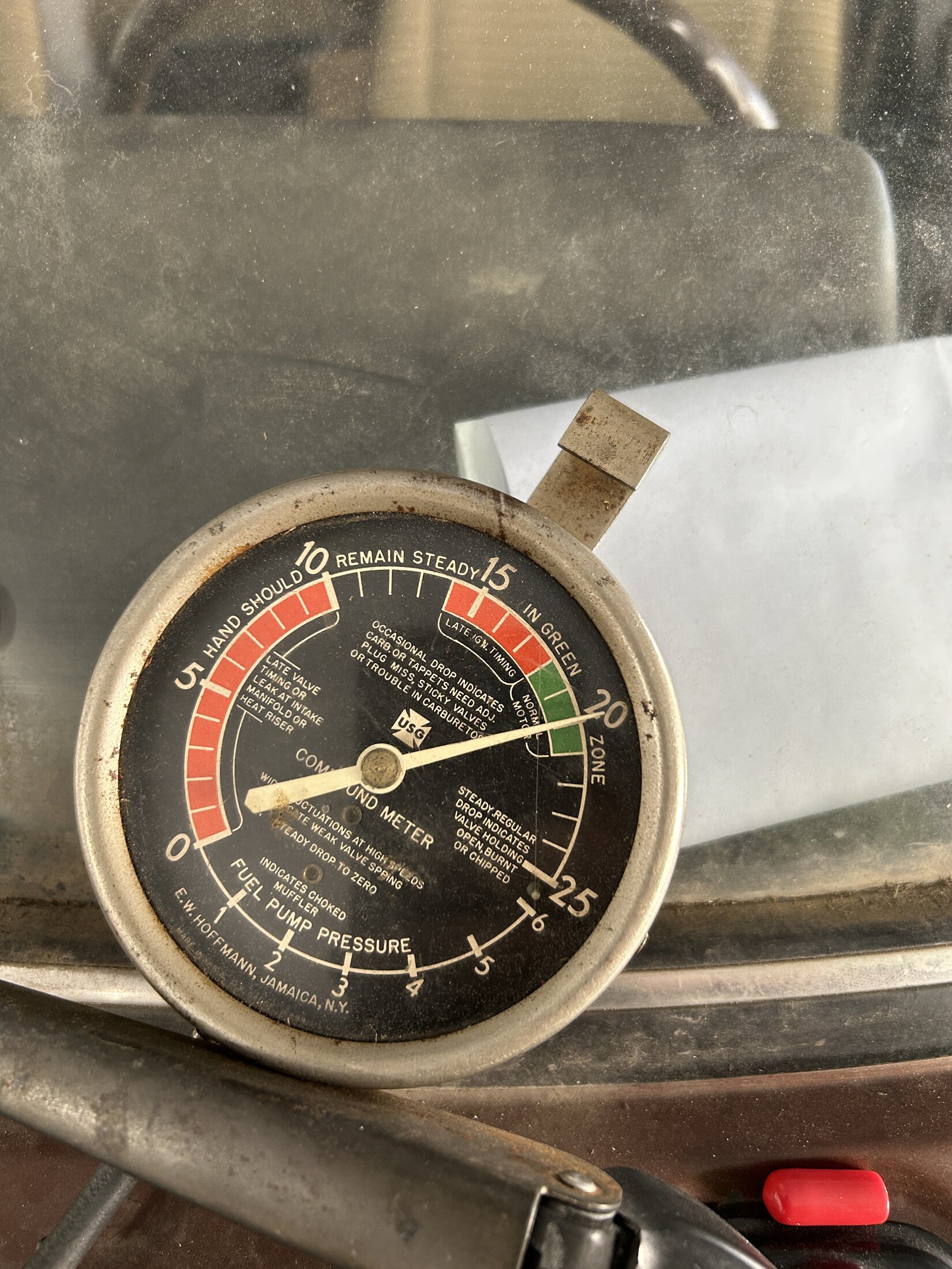

I got my oil pressure gauge working in the cluster last night ( the harbor freight gauge said 58 psi). But, the engine doesn't sound up to par. I put a vacuum gauge on it from the intake manifold and It was only 11 in. It sounded like it was starving for fuel almost. The fuel filter on the fender looked a bit cruddy. The sight glass on the Fuji carb is at about 3/4

Changed out the fuel filter and started a baseline with the fast idle and idle screws 1 turn in. I worked the mixture screw and idle screw and watched my vacuum gauge.
