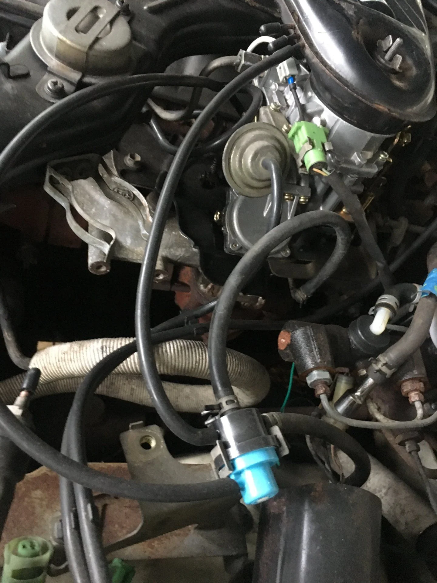

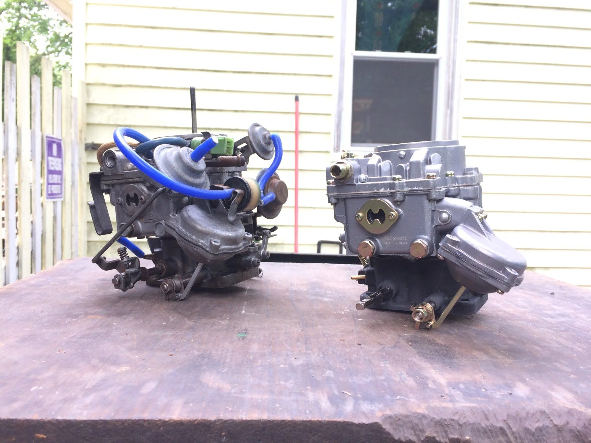

Took the plunge and bought a City Racer Carb, @Racer65. Got it hooked up and having some funky issues.
Refer to video for my dialog while I try to start. Apologies lighting is way dark but there’s really not much to see anyhow.
IM is out 4 turns (at sea level), Idle Speed is in a bunch in hopes it just roars to life then I can turn down, Fast Idle is in a bunch as well.
Truck is desmogged, no cat. Also w/ a city racer, it only has one port meant for the Vacuum Advance pot which is one of the brand spanking new ones I found from the company in TX (all sold out now)... do I keep the VCV and the violet BVSV in the system? Fuel decel is out too.
My question is at the end... I imagine I can simply swap the ICS from my stock carb to this one so the carb fan wiring doesn’t require changing around?

In your explanation you mentioned that the emissions computer is unplugged. But you didn't say what the 12 V source is for the fuel cut solenoid. Normally its controlled through the emissions computer. (But maybe doesn't require it).
Whatever wire you have coming out of the wiring harness that you've got connected to the FCS, un-connect it and get your voltmeter.
Set the meter to measure DC volts and connect one lead to that wire coming out of the harness, and the other lead to a shiny metal body ground. The meter shouldn't do anything.
Then turn the ignition key to ON (but don't crank the starter) and verify that there's 12 volts shown at your meter.
If the FCS isn't energized, it will partially cut off fuel to the carb.

- Plug your emissions computer back in and see what happens , id should help smooth things out
- U Do Not need either BVSV ports using a De-Smog carb , cap off accordingly
- DO NOT switch out the new carb selinoid , it most likly works & using your old one could most likley introduce fine particulate matter into your new carb fuel circuts
it would need a new O-Ring anyway
- also look for a vacuum leak , like u forgot to cap off one or more when u switched carbs ?
let us know if anything outlined above works

I’ll check vac lines. In my head I’m wondering if the driver VCV is bunk now then the carb spacer vacuum port which goes to it is sucking from one smaller port which I hadn’t capped.

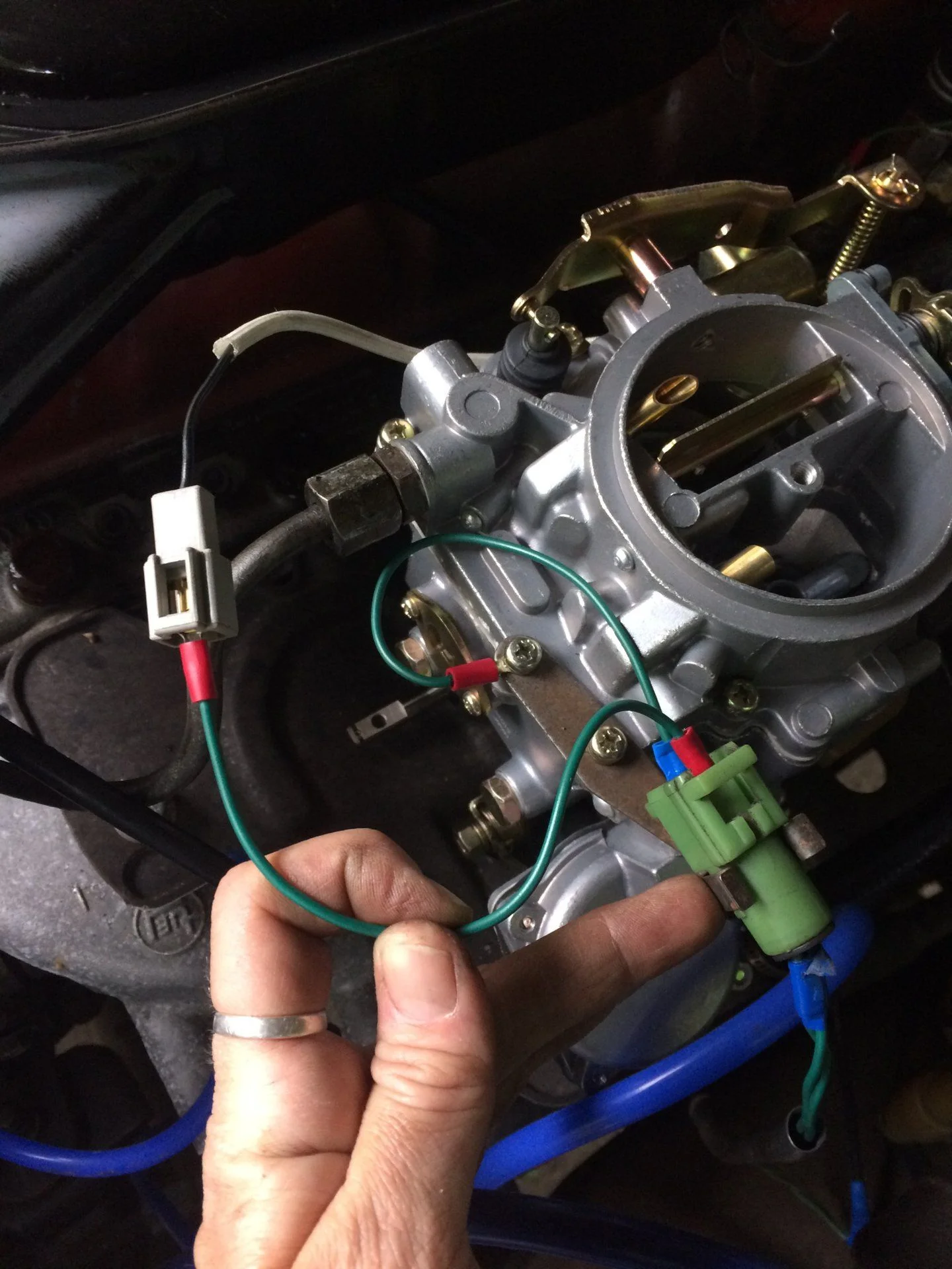

I have that same carb and do not ground to the body. IIRC you only need jumper from solenoid to +12v on existing harness. The other spade has nothing on it.
What about the other stuff I mentioned? BVSV? Driver VCV? Fuel decel? Right now I have no AC system in line at all so I’m not worried about the AC idle up.
thats correct ,
the 1 wire FCS on the new carb is self grounding through its out metal body to the carb body
u only need the 12v B+ signal from your green connector going to the 1 wire grey connector on the carb
the ground side of the green connector should be left alone / empty
Is there A chance u have the green carb FCS connector B+ and NEG crossed ?
thats correct ,

The new carb has had many of the ancillary ports and hook ups literally subtracted. Fuel decel included.

Check your ICS. Unplug it. Turn key to ON. Plug it back in and listen for click. If no click, you are using the wrong wire. Try the other one. If no click there, you’ve lost your 12v. You can jumper to the battery + temporarily for verification. Don’t change the ICS. It’s new. It’s good. I’d bet money on it. Verify before you change out.
Unless I’m doing it wrong I’m getting nothing from the plug fir the ICS w/ ignition ON, meg end on metal and positive end in either female end. Kinda stumped. Like I’ve said before, electrical diagnostics confuses the crud out of me. I’ll try to call someone once phone is charged up.
