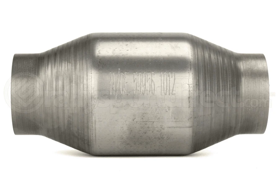

Question for the VA folks. I just get a failed emissions result. The emissions readings themselves were fine. I only failed because the tech said he could not see a visible serial number stamped or labeled on the outside of my catalytic converter.
I have a single, aftermarket cat on my 80. This one: MagnaFlow Universal Spun Catalytic Converters 59956
It's been on there for years, and I've never had a problem. Anyone know anything about this requirement? Have I just been lucky the last few years and had tech let me slide? Is this new?

Looks like it needs some sort of EO tag or number...

I think this answers the question: Passed Emissions Smog but tech can't find a # on the Cat so it's failed?
Maybe whoever installed the act oriented it so that the numbers are facing up at the floor pan and you need a mirror to read them, or they've "rusted" off? Though, it's SUPPOSED to be stainless steel, so...
Quote from the thread:
"Every approved aftermarket cat needs to have a visible executive order number. If it’s not visible or missing, you fail.
The exact manufacturer, as per the document is “Car Sound Exhaust Systems, Inc. (d.b.a. Magnaflow)”
There is a phone number at the bottom of the list 1-800-242-4450 . . . it is the air resources board public information helpline. I expect somebody on the other end of that phone will be able to answer your questions, and possibly get you in touch with a referee
BTW . . . here is an interesting cut and paste from D-193-103
New Label Requirements
The label on the catalytic converter shell must be ½ inch high and large enough to be read from a distance of 5 feet from either side of the vehicle. The label must show
the EO, specific part number (universal or direct-fit) for the vehicle, and date of production (month and year)
As I said earlier, if that label is missing or illegible, then the car should technically fail
I suggest you attempt to contact a BAR referee and provide him with all of the paperwork."
Numbers should look like this, perhaps?
Wow, thanks, Stump. I'll pull out some steel wool and a mirror and see what I can find on the cat.
If that doesn't work, I might try a RapidPass test - RAPIDPASS Virginia Since it just measures your actual emissions as you drive by, maybe that's a way around the cat code number issue?
