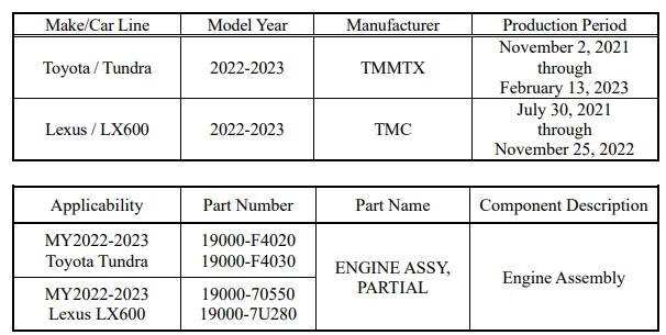

NHTSA has been updated. Here are the links to the documents on NHTSA.gov
Recall Acknowledgement - https://static.nhtsa.gov/odi/rcl/2024/RCAK-24V381-9859.pdf
Recall 573 Report - https://static.nhtsa.gov/odi/rcl/2024/RCLRPT-24V381-6004.PDF
Manufacturer Notice to Dealers (LX600) -https://static.nhtsa.gov/odi/rcl/2024/RCMN-24V381-1577.pdf
Toyota Defect Information Report - https://static.nhtsa.gov/odi/rcl/2024/RMISC-24V381-8150.pdf
Manufacturer Notice to Dealers (Tundra) - https://static.nhtsa.gov/odi/rcl/2024/RCMN-24V381-3977.pdf
Excerpt:
“Description of Problem:
The subject vehicles are equipped with a specific V35A engine that contains crankshaft main bearings which allow the crankshaft to rotate within the engine assembly while running. During a specific production period, there is a possibility that engine machining debris of a particular size and amount may not have been cleared from the engine during manufacturing and subsequently contaminated the engine assembly during the production process. For these engines in the subject vehicles, the pressure on the main bearings due to the engine configuration is such that, if the aforementioned machining debris adheres to the bearings and operation of the engine continues at higher loads over time, failure of the bearings may occur. This can lead to potential engine knocking, engine rough running, engine no start and/or an engine stall. In the subject vehicles, an engine stall while driving leads to a loss of motive power. A vehicle loss of motive power while driving at higher speeds can increase the risk of a crash.”
Interesting excerpt from Section 2, Note 2 of the Defect Information Report:
"V35A engines of this configuration, manufactured after this production period, were manufactured with new or improved processes that better clear machining debris."
Pg. 3, Section 4 - https://static.nhtsa.gov/odi/rcl/2024/RMISC-24V381-8150.pdf
"Toyota is unable to estimate the percentage of the involved vehicles to actually contain the defect described in Section 5. However, as the NHTSA manufacturer portal requires an integer value be entered, Toyota has entered the value “1” in response to this question in the portal. For the purpose of this report, “1” means “unknown”."
