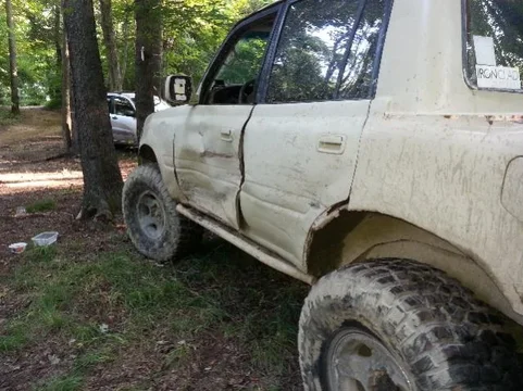

We took a midnight run for some reason I decided to let all my friends drive...
He slid the driver corner up on a tree. While backing, the corner of the bumper caught the tree and bent in forward at a ~30deg angle. My trail fix was to gently run into a different tree to move it back and this is when the tube tore and the bottom weld tore out.
I still love my MetalTech bumper. It has survived many hard hits in the past without budging. This failure was not the bumpers fault. If you go bouncing off trees on a night run, things are bound to break.

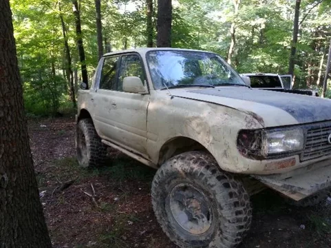

So I finally got around to dealing with the last of the Tahuya night run carnage.
I don't normally fix any of my dents, but this one caused my 1/4 panel to rub the door and hood when opening/closing. Also, I was a little worried that all the mud would fly right into the door hinge cavity.
Anybody know any tricks that will make welding up these 3/8" holes any easier?
You need a piece of copper , press it from behind against the holes and fill them by welding, a little bit more wire than usual. The copper will not stick to the weld and eat the heat.
When I did the chop I used a brass hammer, I just don't have much access in this area.
Looking nice! Love to see people wheel these things with no regard to the body... It's amazing how well they preform when you're not worried about the paint ;-)
